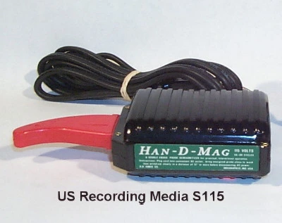

Sorry to be the bearer of a negative opinion, but that demag unit is not up to the task. It'll handle a cassette deck, but it won't do an adequate job on even a 1/4" open-reel deck. That's my opinion, but it is based on experience. I have the exact same demag unit and it was worthless.
You need something like this. It'll set you back $60 ~ $80, but it is worth it. I love mine. Something like a Teac E-3 or similar works well too, though the probe is not covered.

Sadly, I have to second sweetbeets' opinion here--you really ought to spring for an Annis Han D Mag. They're the real deal.
On the bright side, they hold their value very well should you ever decide to sell it.
Yeah, plus you really don't want an on / off switch on those. That's an accident waiting to happen.:eek:
Yeah, that's what I was fearing. Glad you warned me, though. I can't have a demag unit around that doesn't do the job. I've heard that model you mentioned spoke of on some other forums, too. Looks like it's the one I gotta go with, for sure.
