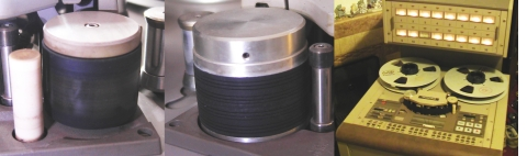

1) How do I clean the pinch roller and tacho rubber? Do I need to get something like "Rubber Renue" on them now to protect their remaining life?
2) What condition do you reckon the rubber is actually in? It all feels good and there doesn't seem to be any sticking or friction from the tape.

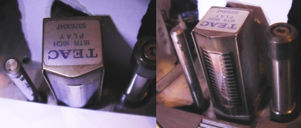

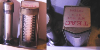

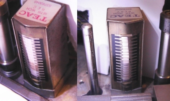

3) From the poor pics I've got, what condition are the heads in? Do they need relapping, or are they worn too badly already and need replacing? Obviously this is my main concern!

The heads do look a bit worn but the wear appears even top to bottom so its probably not imperative to re-lap them unless good tape is being shredded by them being too abrasive.

The pinch roller does look like its seen better days but some Caig Laboratories RBR rubber cleaner/conditioner should help to fix it up a fair bit. Your tach roller looks fine as is.
The tape lifters look badly worn and should be rotated to a clean arc on the post to avoid further punishing your tapes with the added friction. I couldn't clearly see the tape guides but if they're worn, they too can be rotated to a clean arc.

  1. The pinch roller appears glazed which in my experience means the rubber is hardened. It will be less effective at mating the tape to the capstan. Rubber Renue will possibly extend the life of it but that is akin to putting an oil treatment in an engine that is at end-stage in an attempt to get the oil pressure up a bit. It won't rebuild the engine. Ultimately I think you want to consider getting the pinch roller rebuilt or sourcing a new part. If the tape isn't slipping and the pinch roller pressure is appropriate then I say clean it up and run with it. Under normal circumstances the right stuff for cleaning a pinch roller (or any rubber components on the transport) is just plain water and a lint-free cloth. You can also use a solution of window cleaner and water if necessary. Your tach roller appears aged as well...blistered...those little bumps. Those will effect performance, though whether or not you can hear it is a whole 'nuther question. Again, if the tach roller isn't slipping (and it shouldn't...its on roller bearing cartridges) then run with it. If it sounds okay its not hurting anything, and the good news is that it appears the rubber on those two rollers is less apt to turn to goo and rather they are drying out as they age.
  2. See my answer to #1
  3. Go here: http://www.analogrules.com/badheads.html. If you don't see any gaps opening up on your heads then they will work. Like Ghost said, the wear is even (I don't see any keystoning or hourglass patterns), but the profile looks quite flattened compared to the top of the head shield. I won't guess at the % life remaining as you can only do that by measuring the material thickness to the gap, but if you look at the curve of the top of the headshield is quite a bit more acute than the profile of the head. I have a feeling they've been lapped before. They ONLY way to know if they are any good is to either have them inspected, or see if you can get the deck to cal up. If it sounds good and you can calibrate it within spec then they are "good". I say you take it for a spin and see if it records and plays back from each track and see if it sounds good and then cal it when you have all the tools at hand (manual being #1...I think Tascam's calibration procedure and instructions in that era of gear was excellent).

Heads last awhile, especially in a recreational environment...I dunno...thousands of hours?
That's good news! So hopefully at least a good 500 left in the Repro head if I'm lucky! I would like to keep my car just a *little* bit longer, lol! ;)
