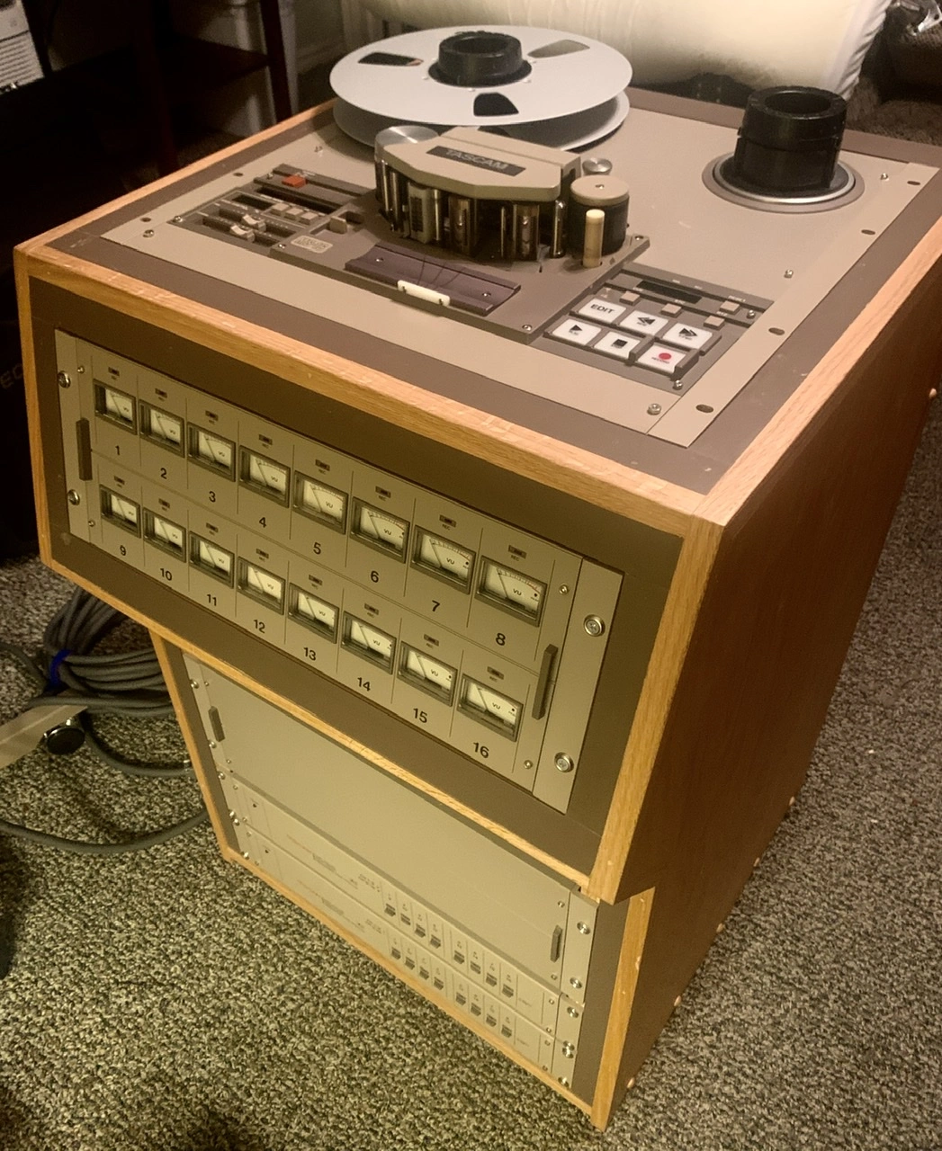

Long while since this thread has been updated. Thought I’d bring it back a little as I bring my MS-16 back to life in the next few months when my studio space is finished.
I’ll be mating it with my Tascam M-520 console, one that I understand was built with the MS-16 in mind. I have a whole slew of snakes and cables that came with it from previous owners and hopefully they can find their MRL tape used to calibrate. If not, I’ll splurge for one from MRL… unless anyone has another suggestion (they cost $545 plus shipping now!)

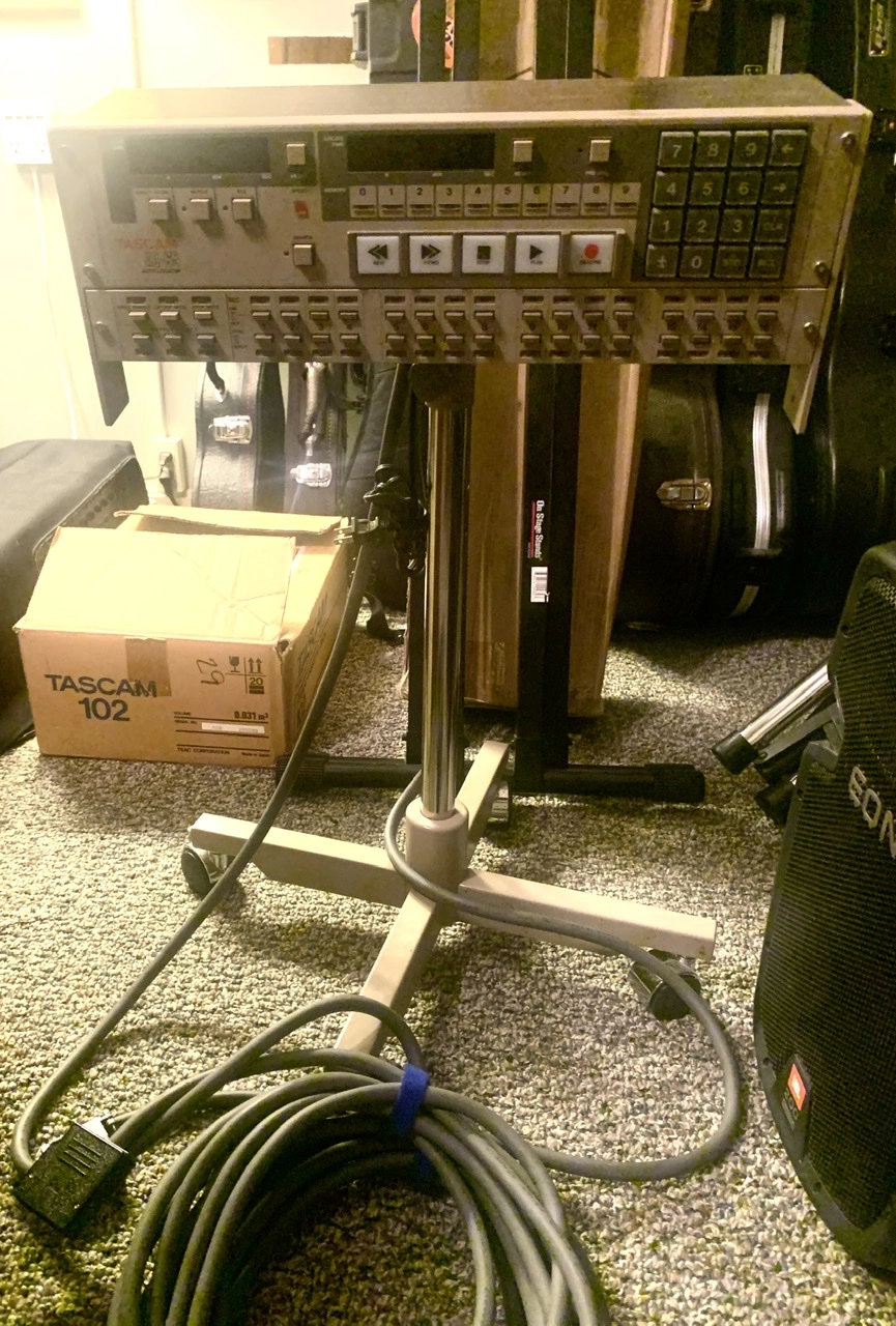

Mine came with the DBX units, a custom oak cabinet, all the snakes, 2 patch bays, the autolocator remote with stand, the full manual in binder and 4 unused well kept reels of Ampex 456 (That may or may not need to be baked, we’ll see).
Condition is looking good with all VU lights and buttons working. The heads look decent but I’ll need to test further. The Capstan roller is a little “glassy” looking and I hope it can be renewed with some simple washing and conditioning but I have access to purchase a new one.
I, also, will be using a TEAC 32-2B to mix master and I’ll also be loading all 16 channels into Logic Pro via a Zoom Livetrack L-20 when needed.
I’m excited to put this MS-16 into service and have some analog tape fun.
