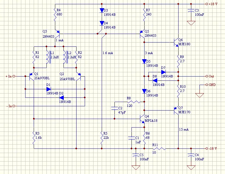

Here is the schematic, I also have some other Documentation if you would like it but you would have to PM me with your e-mail so I can send it to you as it is a PDF File.....
Cheers

Minion said:
If you want to build your Own Opamps to use in your Preamp I have some schematics for a Class A/B Opamp that should work in any Unit that uses a standard 8 pin Opamp.....
Minion, have you ever used your opamps in API, John Hardy or other gear that uses 2520/990-style opamps? They're all 6 pin, BTW.
I just would like to make this clear off the Bat.. "This is Not my Design" , I have nothing to do with this design I just have a relitivly large batch of Schematics for various Curcuits (Preamps,EQ"s Compressors, Ballanced Line Drivers ect) and this was a Curcuit I found on the Prodigy Pro forum...
There is more Info on it here:
http://www.prodigy-pro.com/forum/viewtopic.php?t=10868
I have never used this design before But the designer says it will work in place of a 990 or a API 2520 and uses the same pinout and from the specs he Posted it has extremely good Performance....
There is a PCB design and much more info about at the link I left above....
Cheers
PS: If you look at the schematic you can see that is has 6 Pins, It has 2 Supply Pins and +/- Signal Inputs and an Output and Ground..... :)
