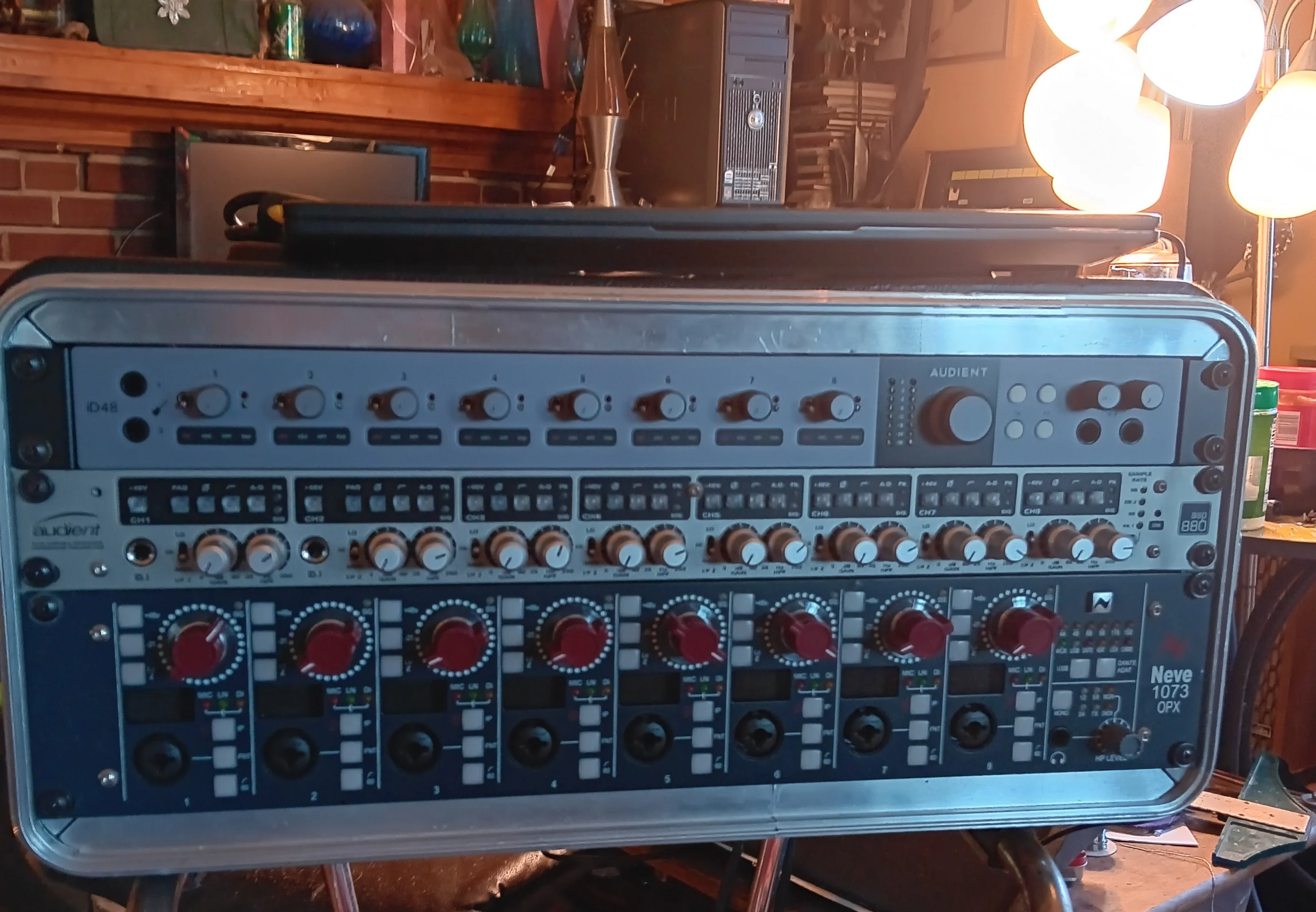

I just got a new Audient interface (iD48) but only because I needed 24 input' with mic preamps that'll fit in a 4RU road case. I don't know how it happened but now I have a Neve interface, a Behringer, a Presonus and ol faithful MOTU 828es

PS. They all play nice with REAPER and Windows
48 inputs is handling a lot of Inputs wow...
Reaper plays well with all my stuff , it was never a problem.
Neve and the Audient is interesting contrast, clean and transformer.... what are you doing with 48 channels? Live shows? Orchestras?
