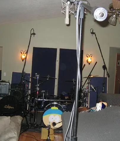

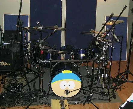

It's a Pearl Masters Custom Kit, played by an excellent drummer, in a 1000 sq ft "great room" in my house. Vaulted cielings and lots of wierd angles and built in "diffusors" (3/4 walls, kitchen island, etc..). I put some absorbing panels behind the kit, and some out in front against the nearby kitchen island, and covered the top of the island with egg carton foam.
The kit had 14 mics total, although two were muted in the sample (hat and ride mics - they will only be used if some accents parts aren't breaking thru the mix)
The main sound is coming from 6 mics.

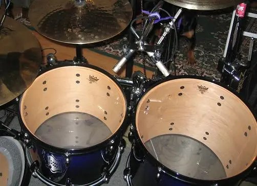

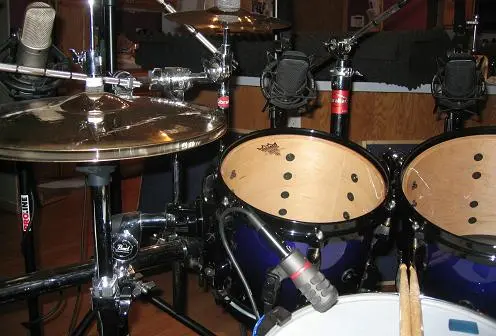

ATM23HE on the snare top, EV nd868 on the kick, two KM184's overhead thru a api 3124 - then two gefell UM92's in an "sorda" XY about 12 feet out and 7 feet up running into a GR mp-2nv. All this runs into an apogee ad16.
The two rack toms have 4033's running into my ghost pre's and the two floor toms have mxl 603's running to the ghost as well. One shure sm57, underneath the snare. Finally, there is a royer r121 out front of the kick going into a Peavey VMP-2.
The sound is 99% coming from the drums, the drummer, and the room. In fact, I will post a sample of just the room mics raw, it actually sounds pretty amazing. I will also post a couple pics too.
