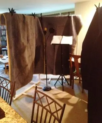

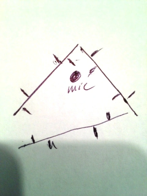

I use this poor mans recording booth setup that has been amazing at cleaning up the tonal quality of my vocal recordings.
The picture shows the booth opened up. When I'm recording in it, I pull in the blanket/stands behind the mic in very tight and they are at around a 60 deg angle, the blanket stand behing my back also get pulled in tight and that one is also angled. I try and avoid any perpendicular or parallel angles on the blankets.
