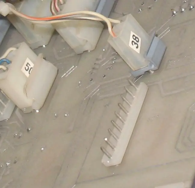

Hi, Just got a chance to look over your measurement results and I think that P38 got turned around and is in backwards. P38 takes the signals from the Interface/lamp Driver board and routes them over to the power supply connector where they go (via the power supply) to the analog drawers.
In the photo you can see that the orange/white is on the bottom position which is pin #1. The gray/white is in pin 3. Worth a check.
Regards, Ethan
Ahaaaa...I'll take a look at that! It's entirely possible I got one backward when I connected up the motherboard again after re-soldering...some tight/awkward to reach areas behind that board...and I seem to recall there was one with a broken latch so it wasn't immediately obvious which way around it went...I'll bet that's the one.
If that's it, I'll crap myself
:D
Bingo Ethan, bingo!! P38 was backwards....d'oh! :o I'm pleased to say that rec is holding, all tracks are erasing and I was able to work on setting up the audio. Some channels were quite out of whack and I had a few hiccups to work through, but I was able to apply the knowledge gained through working out the issues in this thread and got them solved no prob...can't thank you enough for all the time you spent helping me out--wouldn't have gotten this beast alive again without your selfless assistance! Now I need to spend some more time getting the hang of the audio cals, but I'm a good alignment job away from putting this back in service...back in familiar territory recordin' stuff! :D
