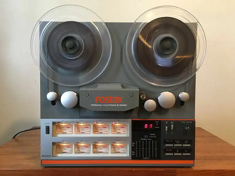

Welcome! That's a lot like how I started out, though I never really went down the cassette route. The A8 will ideally want RTM SM911 or LPR35, that's the modern equivalent.

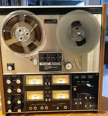

I don't know the 2340 specifically, but options include:
1. Calibrating it for higher output tape - this can be awkward on older decks as they may not be able to bias that high without modification. This will make the recording louder, which means it will require less amplification and therefore the tape hiss will be amplified less too.
2. DBX. TASCAM made a 4-way noise reduction unit called the 4DX. This is designed for the TASCAM 34 series, but it can be modified to work on other decks too.
3. Noise gates. This is a bit of a heavy-handed way of doing it, but it can work. The idea is that it mutes the channel(s) below a certain signal level. When the signal is louder the hiss will be masked by the music. However this can give you an audible transition when things fade in or out, particularly reverb tails at the end of a song, so it needs to be used with care.

Would you say lpr35 is better than mds-36? i tried both on my r8 but both werent working well as the deck was trash. id honestly prefer to get the decks set for whichever is cheaper as reels are a double expense vs cassette
LPR35 is the modern equivalent of Ampex 457, which is what Fostex recommended in the A8 manual if I remember correctly. I've never tried MDS-36, but I tend to treat ATR as very high output mastering tape, which isn't really what you'd want for a narrow-track machine as it would make the crosstalk between tracks worse.

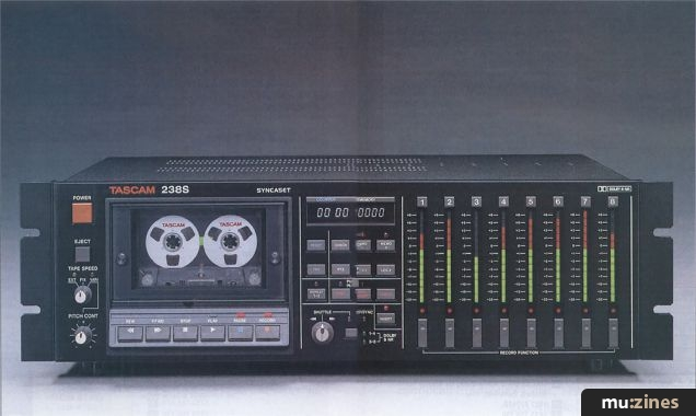

One question about the 238, though - is that the Dolby S or DBX version? A lot of the Dolby S machines have problems with the noise reduction chips failing, and I think the 238S may fall in that list.

is just a 238 that had a capstan board recap that didnt do the job and was having speed problems on startup and pretty knarly wow and flutter. the shop who sold it is fixing it
