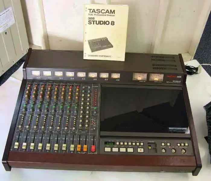

ok... so i'm sure you guys are thrilled to see another new guy who just bought his first tape machine come on here and ask the same questions, again. too bad, here goes...
first, my back story. so i've been dreaming of getting into this analog recording stuff for at least a year now, and i had my mind made up i was going to go the mx5050-8 1/2" route. and i'm all ready to pull the trigger and i stumble onto this 388 local for $150. a friend of a friend knew a guy who's cousin knew a guy who works for this sound/theatre install company, they go to this ancient studio to renovate, and this guys boss tells him to throw the 388 in the dumpster. thank god he doesn't, he takes it home and puts the word out. he has no idea what the thing is/what it does/if it even works? he makes like $8 an hour pulling wire. anyway, i go check the thing out, it powers up, the meters light up, i pull the right tensioner up the transport functions work, play, FF, RW, i push as many buttons as i can, they all blink/light up, i don't know if it works, what the hell... i buy it. done deal, $150 and now i'm on an adventure.
the fun part... i've been searching and reading and searching and reading. so i'm going to try and make this as painless as possible. i downloaded the manual, i know i have to read that cover to cover. i'll be calling tascam this week to get a belt and a pinch roller. i'll also be ordering a reel of lpr35 1mil and a take up reel. i know to clean the tape path the best i can with 90%+ isopropyl, rubber parts with rubber cleaner, etc.
here are my questions:
when the term calibration is used, are we talking about setting the tape speed and tension? is this something that i can learn to do at home? i know i'll need things like an oscilliscope, etc. if the shit hits the fan there are 3 tascam repair centers within driving distance, so...
can someone recommend me to a good head degauzer for this machine?
is there anything that i am not considering or am unprepared for? i know it's a complicated machine and anything could happen, but i'm friggin determined so any and all advice will be appreciated.
i can't post pictures until i have 5 posts apparently, so i'll be posting pictures in the near future. thanks for any advice in advance, if it weren't this forum, i would already be in over my head.

i do believe it's the full service manual, its got the parts lists, exploded diagrams, and mechanical adjustment procedures. it doesn't use terms such as "calibration " though. it has procedures for head alignment, in which it says my machine requires no adjustment due to semi-fixed record head, and a fully fixed erase head. it also states that tape tension is "precisely factory adjusted, in general [it] should not be readjusted." it does say that i can do a head azimuth adjustment, fast winding speed adjustment, wow and flutter check, and a tape speed adjustment. i'd be lying if i said i was familiar with all of these terms, but i'm sure i'll be quite familiar in the near future.
