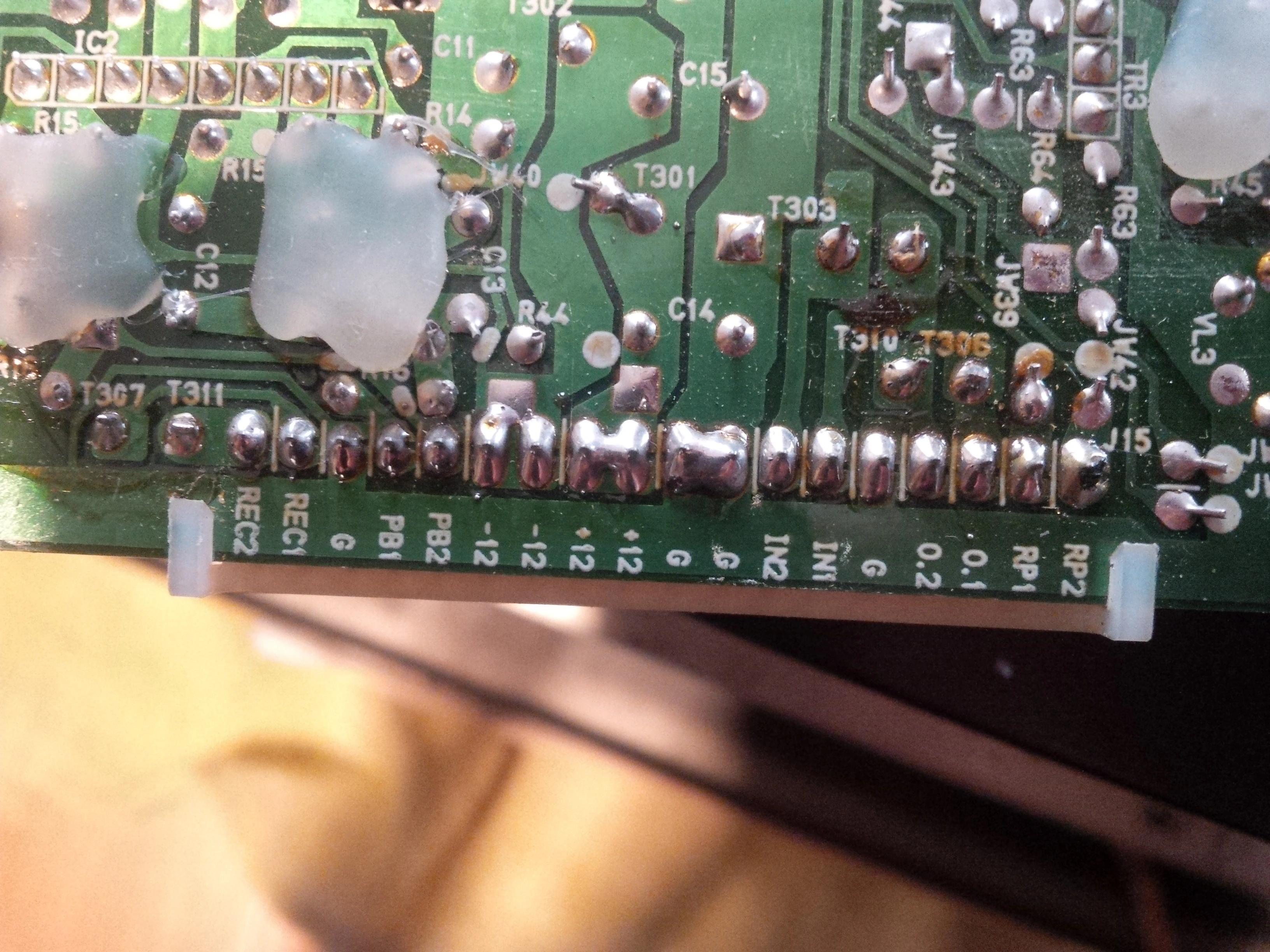

Edit... Sorry about posting the pic.Couldn't delete it. I was gonna ask about the two +12 solder points that are bridged together on this one card. I just realised they they share the same path. It's not like that on any of the other cards.

Also, to address a question you had about the bridged solder points on the R/P card in post #61...I think you've figured that out already, but, yeah, sometimes they'll use two terminals of a multi-terminal connector for power just to increase the current potential...one of your cards clearly shows the person assembling that one card had had coffee and was a little excited with the solder and blobbed more on. Absolutely no concerns with that.

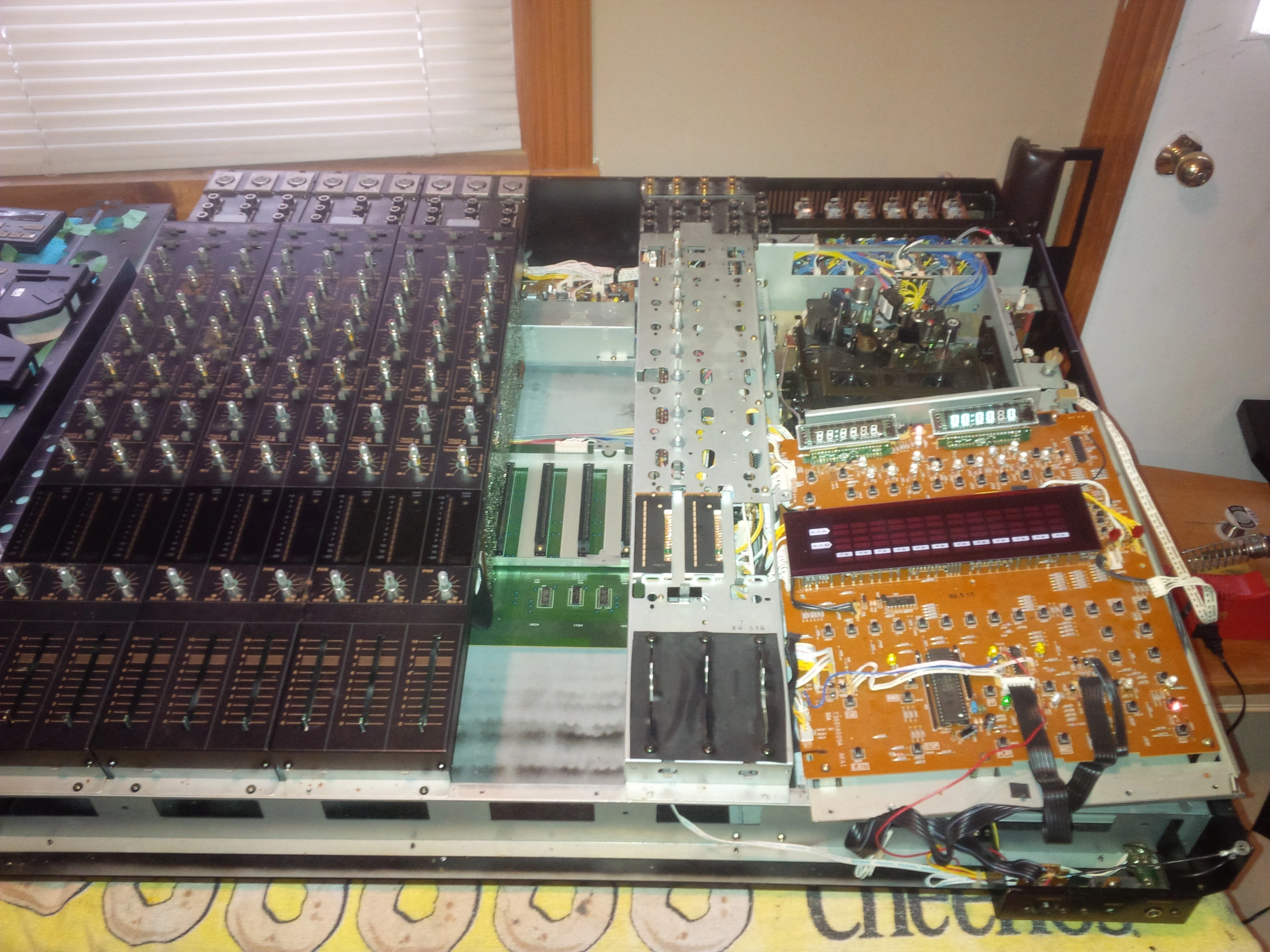

Here is an older picture that I posted earlier of the control board. It's not a good close up. I will post another pic later.
The big screen is the assembly that you are talking about right?.Yes, lots of connections on that. As you can see the row of functions that are lit up at the bottom of the screen. Those still light up. They indicate playback. The 2 that are over to the left, those are the Buss A and Buss B indicator lights, they no longer light up.

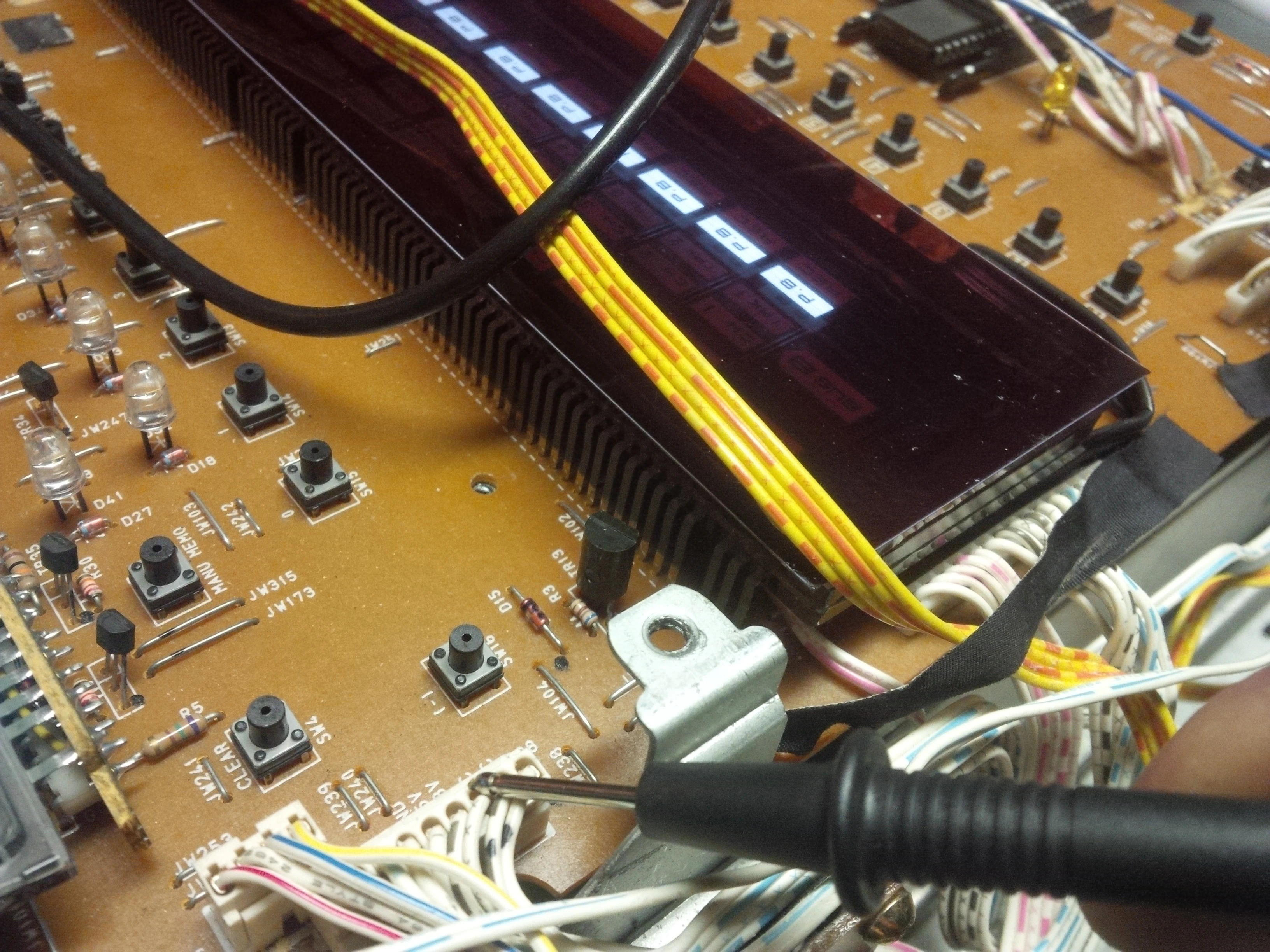

Ok. I followed your instructions. Getting a reading of around 8.61 between pins 1&2 on p128 and 8.53 between terminal 77&152 at either end of the LCD.
Here is a pic of the p128 and the terminals of the LCD...

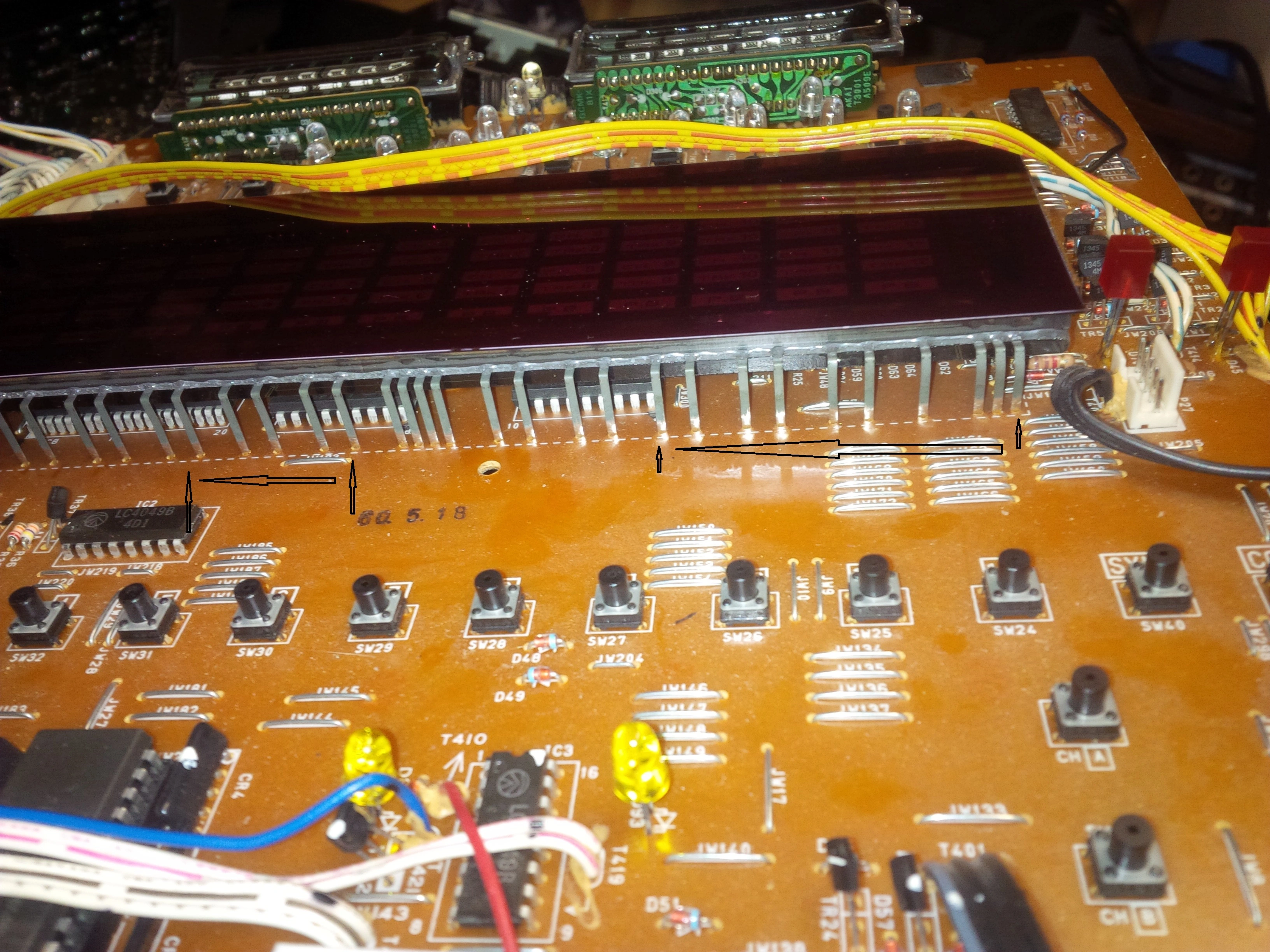

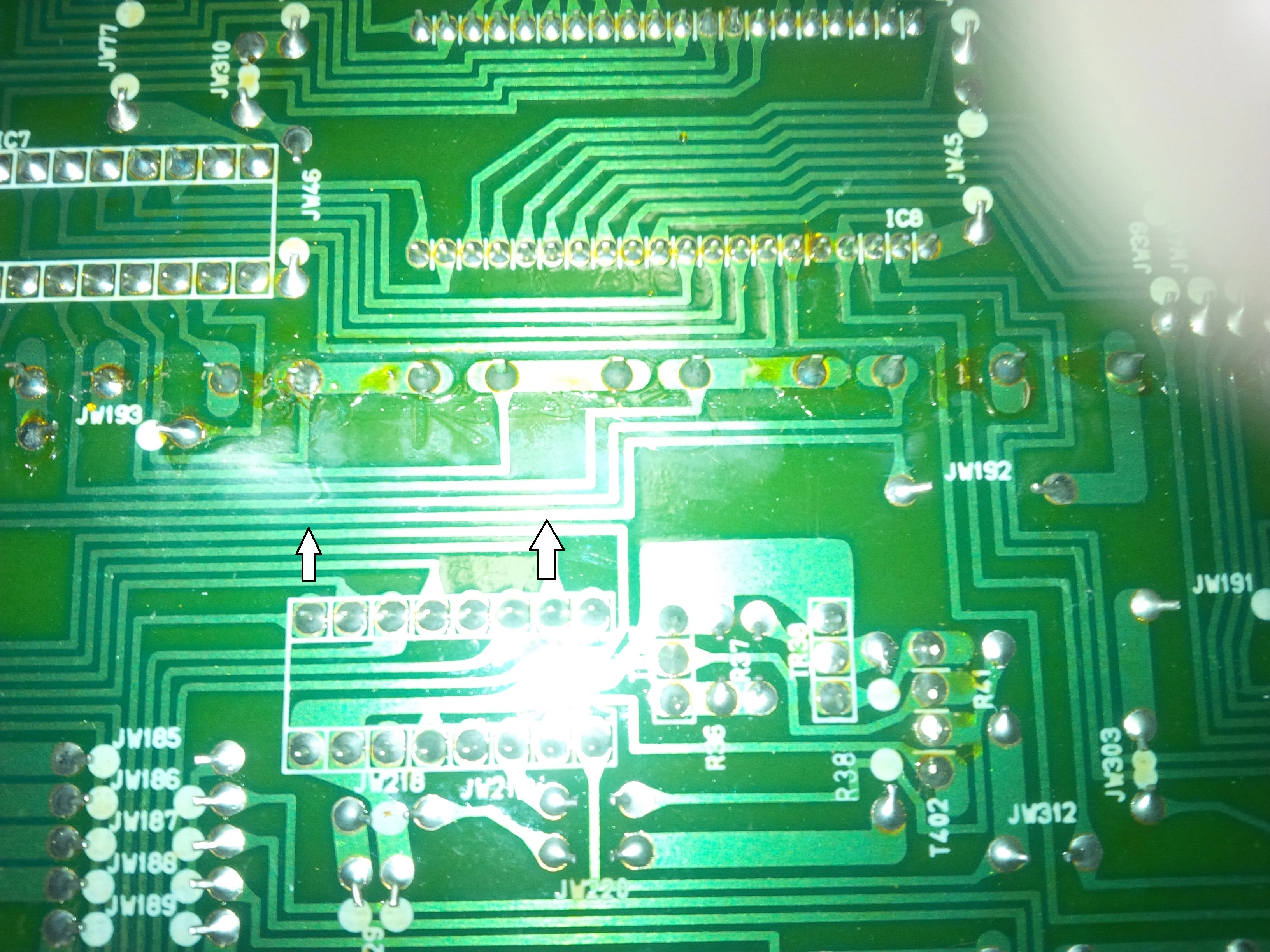

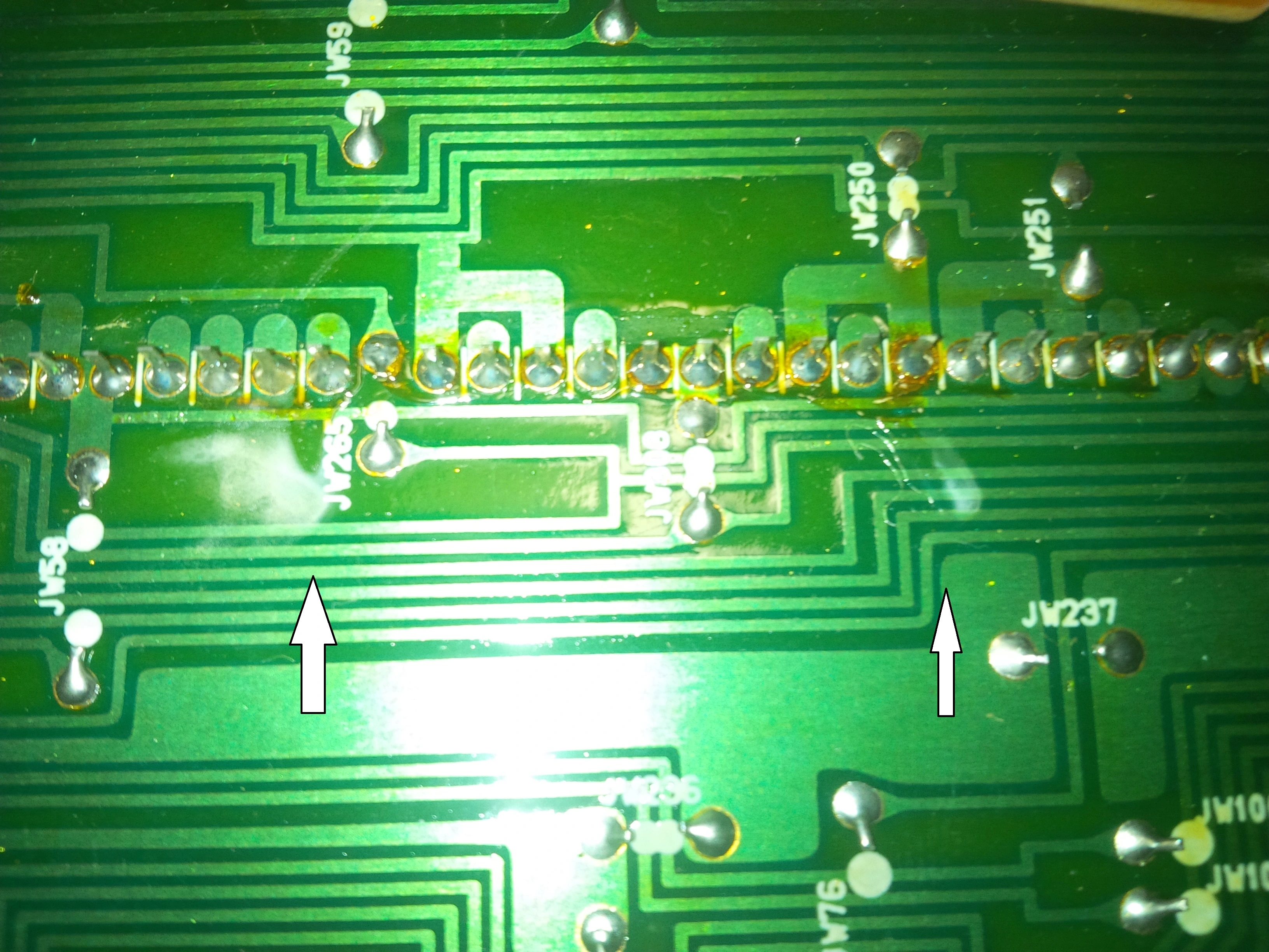

Is there any way you can get me some more specifics on where the *poof* spots are?
The white spots are located under the rows of pins under the LCD display. Not sure if this indicates that anything got damaged. But it does look suspect.
Here are some pics...
When the board is mounted, what is directly under those spots? Is it possible to post a picture of that?

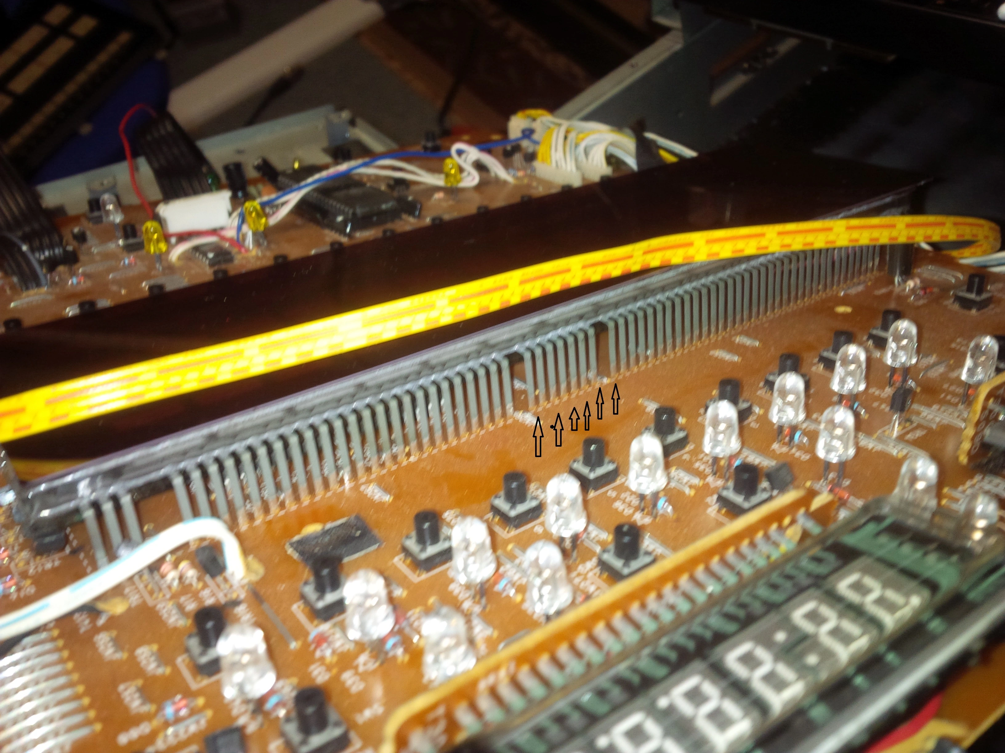

I found a few more small white spots starting from the bottom right corner of the LCD
So....from the right side bottom of the LCD counting back here are the locations....
And from the top side right counting back about 30 pins....
Just checking, you're aware the 'LCD' is actually a VFD, right?
Can you check the tracks that have the suspect white marks for current potential(I don't know the right term). Say if you find a solder point on the suspect circuit board track before the suspect damage point and find a solder point after and use your multi meter to prove the current flows through this suspect point. I guess a process of elimination. If you can say without doubt that any track that has a white powdery marks has no compromised current flow through then you could move on.
Oh yes. That's a good point. Anything in particular about that type of display that might be useful considering his symptoms?
j.harv I'm at a bit of a loss still. It seems the power that pertains to the fuse that blew is getting to the VFD, and there are no components in between. You could check for continuity from fuse F1 to the set of VFD terminals 77/78/79, or fuse F7 and terminals 150/151/152 (this is what deslog is suggesting). It wouldn't hurt. But the *poof* marks on the trace side of the board look like they possibly came from another assembly...like something blew on another board. That's why I'm asking what is mounted just underneath that System Control board.

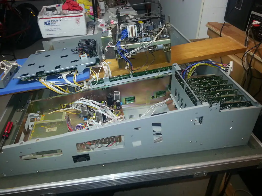

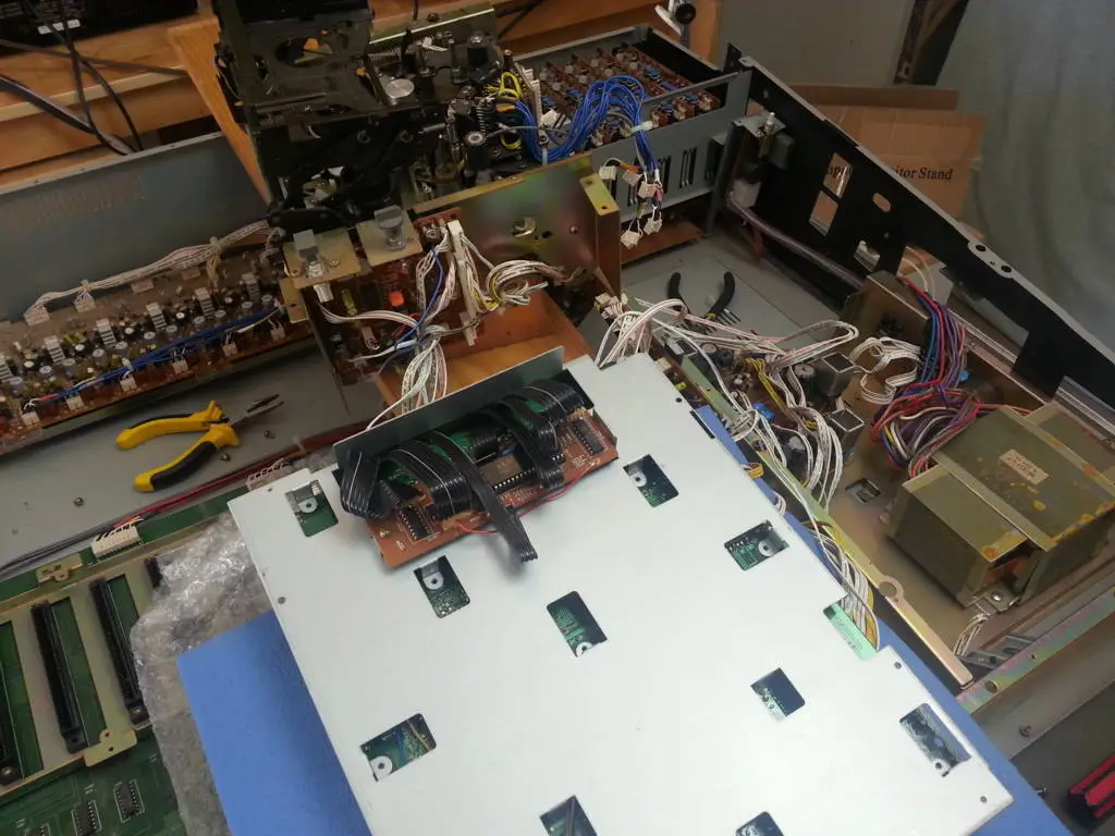

There is nothing but a zinc annealed metal removable chassis under there. This supports the System control board. Under that is the power supply board. I cant see how it could of happened there.

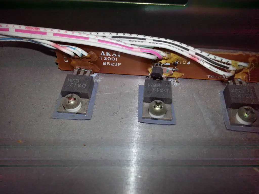

Try and protect the circuit boards from touching other things( I no you learn't your lesson). In the photos I placed a peice of wood across the top of the chassis to help support the Mechablock(recording section) and put a piece of foam under the system control board to protect it while I was working on other things. These are old pictures of mine.
The thing is we don't really know if YOU actually caused the new problem or it was a coincidence and just another problem due to moving the circuit boards around. Just think about it, the recorder mixer you are working on is about 32 years old. Any wires that you see that have that brown adhesive/sealer stuff around, check to see if there is corrosion as this goop seriously decomposed over time and encourages oxidization and rust. I had to repair a few wires like this.
