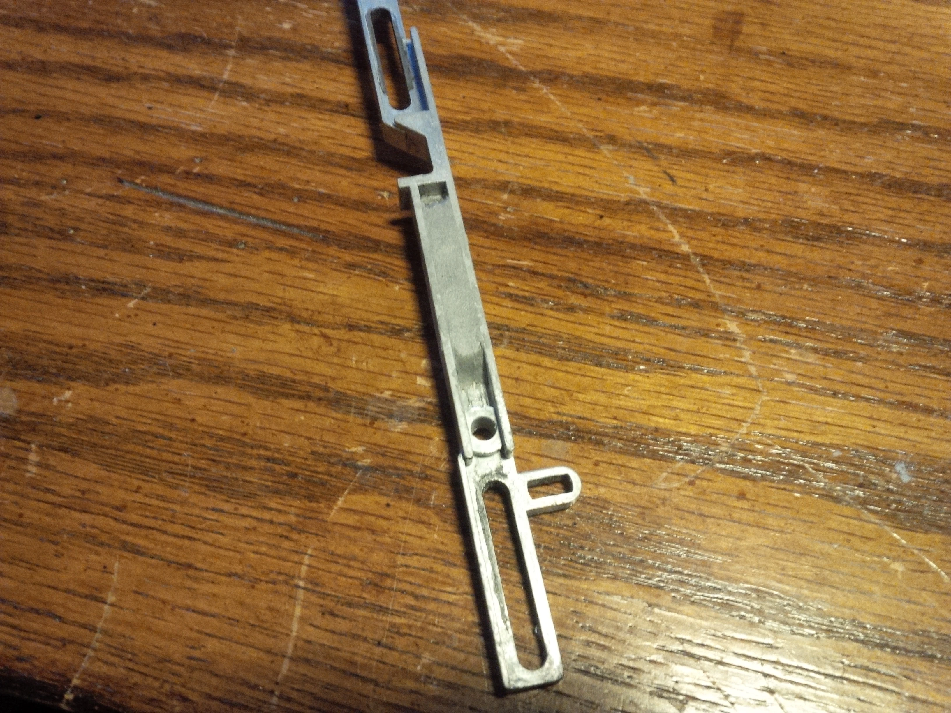

Okay. Another problem has popped up. I still haven't got to the eject button problem yet, but there is a problem with the eject function. I fixed the cam that moves the door up and down, but there is a problem that happens every now and then. When closing the door, it sometimes stalls and then quickly slams shut. This is another problem I have heard of while searching around.
I found the problem, and there is also something mentioned about it in the service manual(thanks Sweetbeats for the link). Must be a common problem if the part being bent is mentioned in the manual.
There is a part called the slide eject action part. Mine has become bent. I think its made out of aluminium. Maybe cast steel. Not sure. This is causing the door to slam shut sometimes. Now I gotta figure a way to straighten it without breaking it. It a vital component for the eject system and I can't risk snapping it.
Here is a picture....what do you guys think? maybe some heat???
Excellent that you got it working with minimal effort.
Most likely that metal part is cast pot metal.....maybe aluminum. Doesnt look like steel from the pics.
Ive had luck with such parts in the past.
Automotive related. Not audio. But anyway.... no need to get into details.
My fix for straightening deformed cast parts has been to put it in a vise and slowly heat it up with a heatgun on high, as I'm slowly tightening the vice till its straight. Cooling it is rapidly in a bowl filled with water helps the process.
Good luck and congrats on the progress so far.
Edit: a good long term solution is to have one machined out of aircraft grade billet aluminum.
Second edit: Almost forgot. Gibson bridges would collapse and bow like that because of years of string tension. I'd fix those the same way. But........it wouldnt be a permanent fix.
But in all fairness they have a lot of downward stress from the string tension.
DAMN j.harv...I'm impressed. Nice work!! :D:D:D
I second RFR's recommendations. It looks like cast aluminum. Getting it warm is a good security measure, and using a vice is good because it provides even pressure over a larger area, and it is easy to advance the pressure. Often the vice won't get a part like that totally straight again...like pressure *past* the centerpoint has to be gently applied so that the part comes to rest straightened out. You can still do this in the vice using some nails, one at the center point, and the other two placed one on each end on the opposite side. I can sketch a pic if that doesn't make sense.

I got the eject mechanism part mostly straight. With a vice and some heat as mentioned earlier. Thanks.
I also added some aluminium putty to the part for added strength. The part is constantly under tension from a bigger sized spring. Here it is with the putty. It dries in to solid aluminum

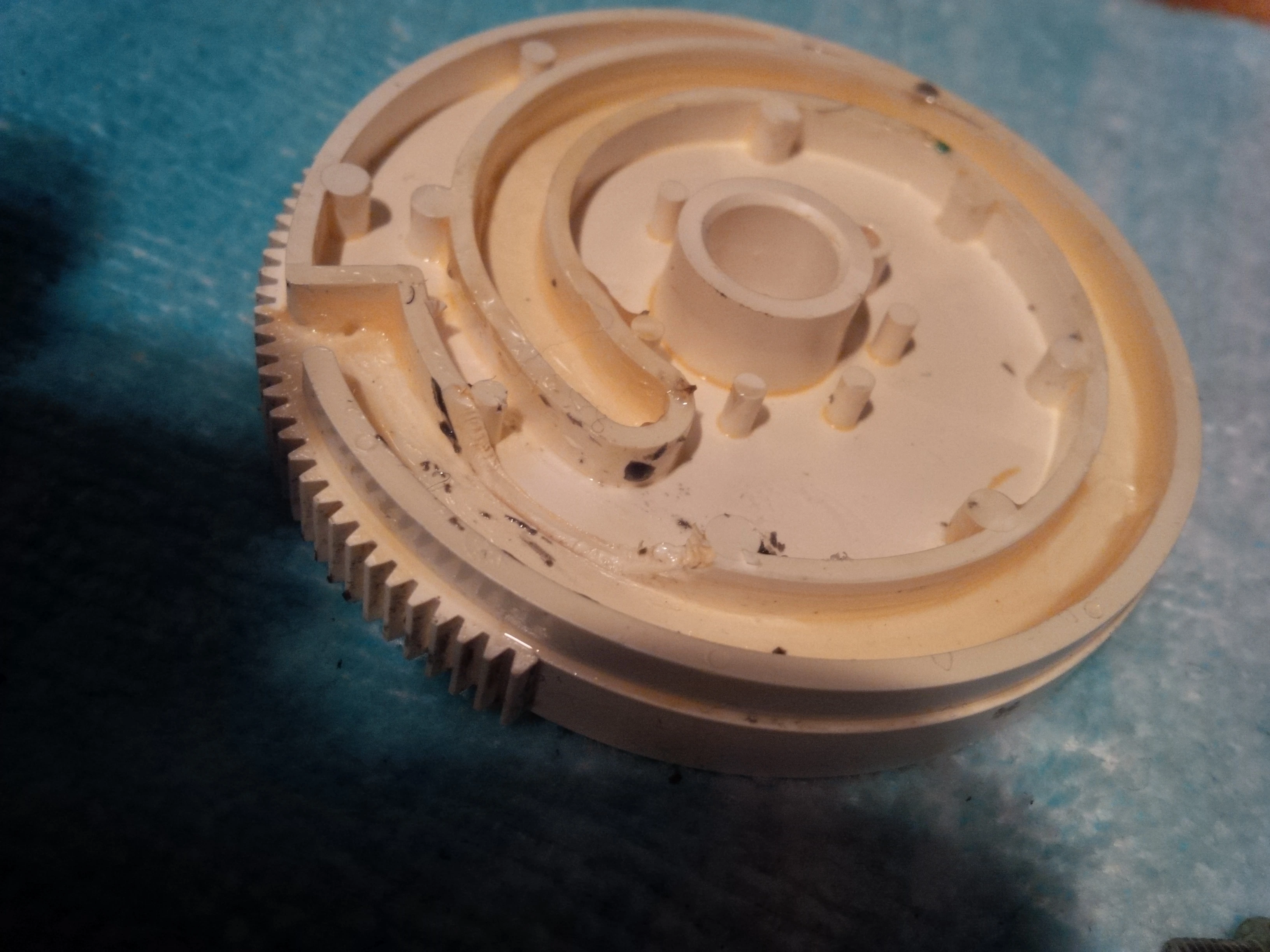

My repair job on the cam failed:mad::mad::mad::mad: Back to the clicking door again.
The little piece of jb weld broke off. There is probably a lot of pressure on that spot from the spring loaded arm. So now I gotta figure out what else I could use to fix it. I'm thinking epoxy putty might be stronger. Or I might be able to use the aluminium putty I have to build it up.
Anyway, I got the part out, and now can show a picture of the broken spot. Look carefully. You'll see a break in the wall of the channel....That's where the arm guide is dropping in to.
I think I could add the epoxy all the way to the outside wall of the channel behind the break so it won't snap off. Just fill up that whole section.
Do you know anyone with a 3d printer?
On that piece broken off, you could get some plastic and heat and bend it to shape, file and sand the bottom to fit and glue it with CA with a catalyst. It would be a pain, but it 'could" be reconstructed.

Yeah. It ain't pretty. And I'm not sure this ones gonna work either. I used plastic epoxy this time, and I just realised this is the kind that dries to a rubbery feel. Not hard and solid. I have a few tubes of different epoxys lying around. I think I used the wrong one. But I remember this stuff is easy to remove.
Does anyone know what kind of plastic this cam would be made of? from what I have been reading on some of these epoxys is that they won't adhere to polyethylene or polypropylene plastics.
I think I'm gonna go out and by some Tamiya epoxy putty from the hobby store tomorrow. I have used this stuff in the past with good results. I dries hard like solid plastic.
Could be wrong but i think it's a nylon based plastic. Durable with somewhat 'slippery' gualities.
This might be crazy talk, but is it feasible to create a mould using a temporary fix and cast a replacement part from something?
That could be done. Maybe.
Heres another idea.
Get out your dremel. Drill, cut, file......whatever you want to call it, all the way through the broken section.
Get some plastic, bend it with low heat and put it in place of the missing chunk.
Glue it in and re enforce the back side. Not the bottom, but the side where nothing is riding on.
This way it won't snap off because it's integral to the cam piece now as it goes through.
That's the way I'd do it. It will take a bit of work, time and patience, but would be solid.
Basically you are reconstructing the part with new plastic.
I think if it was me I'd be doing something similar to what you are doing with the cam, but making some little forms out of something epoxy wouldn't stick to, and using standard 2-part epoxy cement...using the little forms to create as smooth a wall on the follower side of the channel, and then building it all the way over to that other wall like you just did. That's a good idea.
3-D printer is an intriguing idea.
I suspect, as has been suggested, the cam/gear is nylon-based.

Thanks for the repair suggestions guys. I'm gonna try the epoxy putty this time. It turns into a solid piece when dry and can be carved with an exato knife to shape it. I'm just hoping it sticks and doesn't just drop out.
I will post a pic when it has cured.
Where do you get aluminum putty?
I got the putty at local bolt and nut supplier. It's good stuff that can come in handy. When cured you can drill into it and you can also machine it.

Okay.... repair attempt #3
Tamiya Epoxy putty. Filled it in real good and it's pretty much rock hard now. So I can't see it breaking in any way. The only thing that could happen, is it could just drop out in one piece if it doesn't adhere to the part properly.
Best of luck. If it fails I'm sure you'll get some support. I could experiment on one of my cam gears to determine what will adhere. But hopefully you've got it licked!
Haha!; it sure aint pretty. But it looks virtually indestructible.

The good....The repair to the cam with the epoxy putty seems to be holding well and the eject function works smoothly. Tape transport runs smooth. No tapes have been eaten. Playback of the previously recorded material on the used tapes I have play back nicely, EQ works and all LEDs lghting up as they should.
