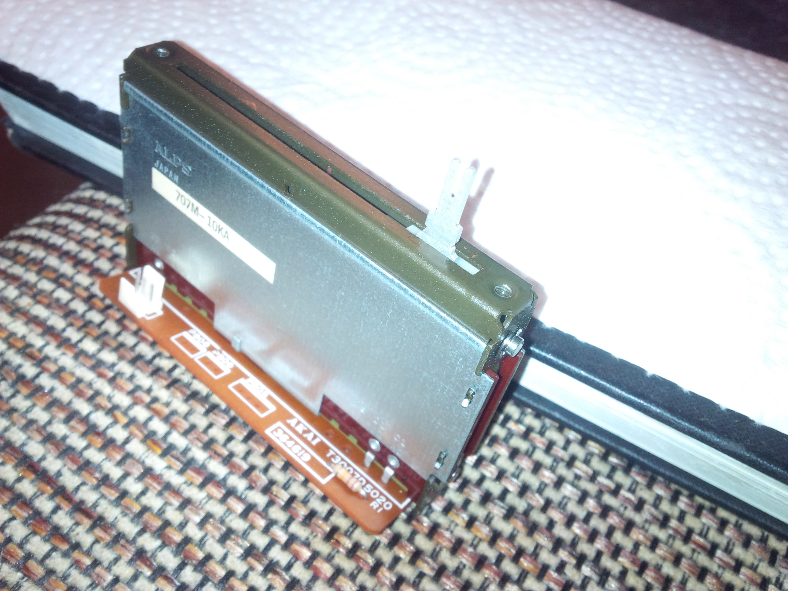

Hey guys remember that the mg1214 is actually a better version.
- It has better faders(Alps) not cheap ones. The difference is completely different in size, shape and quality.
- The pre-amps are upgraded
- Some of the recorder mechanical parts were upgraded.

I think he was referring to the faders which are different size, shape and quality.

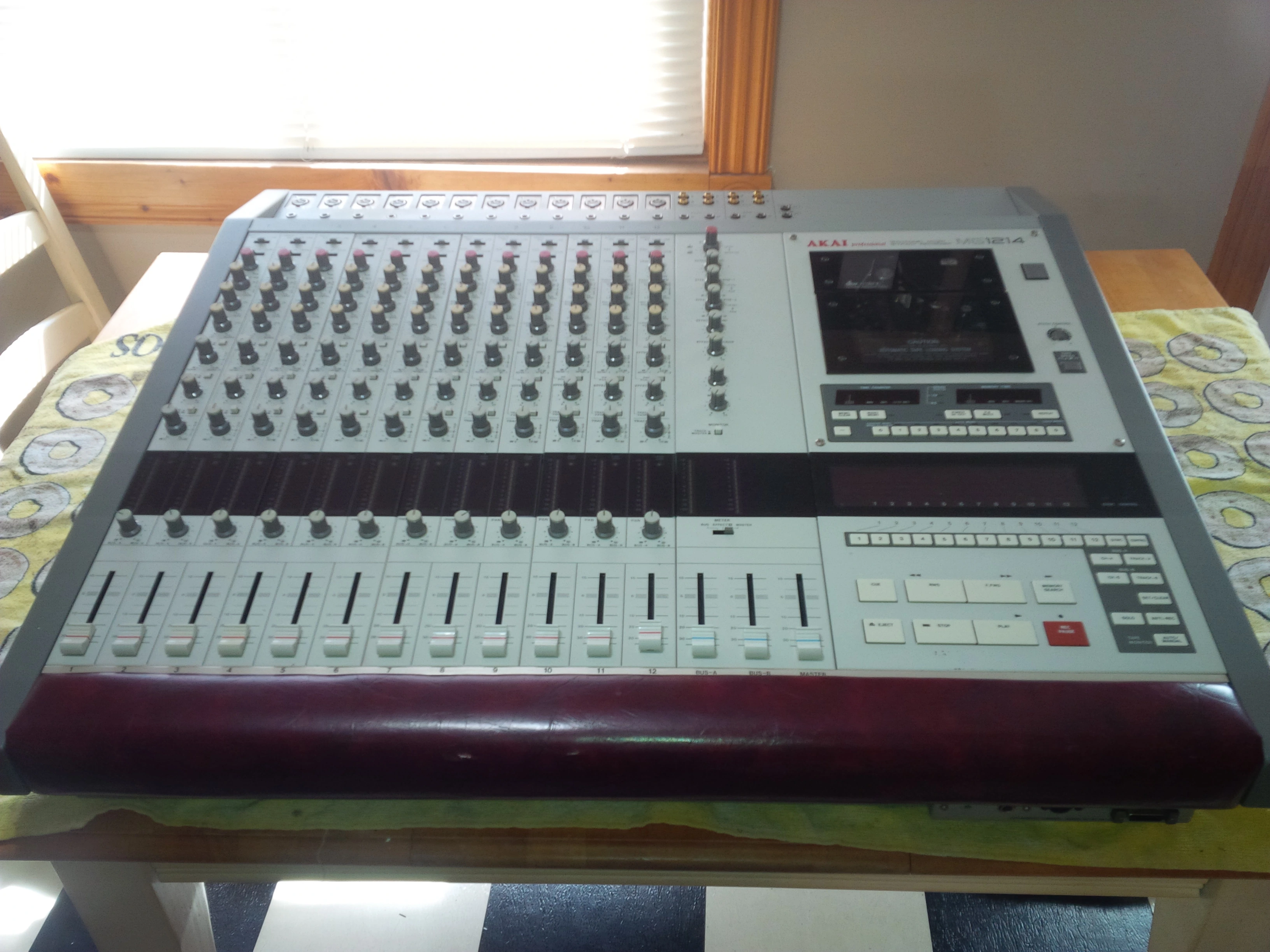

Another Akai MG1212/ MG1214
This one is white and grey!
Just picked this up yesterday. It was on kijiji. Had my eye on it and waited a while to make an offer. He had it originally for $350 canadian, then lowered it to $250. I put an offer of $180.
Didn't want to go up to $200. I bought it untested and knowing there were some issues.
It also came with a used tape. Which is always nice.
I got it home and it was pretty filthy. Here is a picture of one panel cleaned up next to an uncleaned one. The picture doesn't do the filth justice. It was yellowy brown and cakey.
But, it cleaned up great. Really great.
Started working on it as soon as I got it through the door. Opened 'er up and started cleaning pots and faders. The faders on this are really nice. I didn't attempt to open them though.
The issues.... Same as the MG1212 I have.
Idler tire rock hard. I pulled the new tire I bought, out of the 1212 and installed it.
Tape plays nice and smooth, all transport functions work.
The battery on the power supply went. But not as bad as the one on my 1212.It didn't leave a huge mess. I pulled the new one out of the 1212 and installed it in the 1214.
There are no eject issues on this machine, but I did swap out the sliding part. It was also slightly bent. So I put in the one from the 1212 that I straightened and reinforced ,and although I haven't looked, the plastic gear that gave me problems on the 1212 must be fine on this machine.
Oh....and the control track works. So I have a counter:thumbs up:
So I now have an upgraded model that is working brilliantly and it's in excellent shape.:)
The only thing I have noticed is the rewind is a little slow. And I discovered if I move the tape tensioner over, the rewind speeds up a little. At the end of the tensioner is the brake strap that goes around the reel table. So by moving the tensioner, it loosens the brake strap. So maybe a brake adjustment is in need.
The MG1212 has now become a donor. Anybody know what other upgrades are on the MG1214 compared to the 1212?
I know the preamps and faders are better. Anymore??? EQ???
