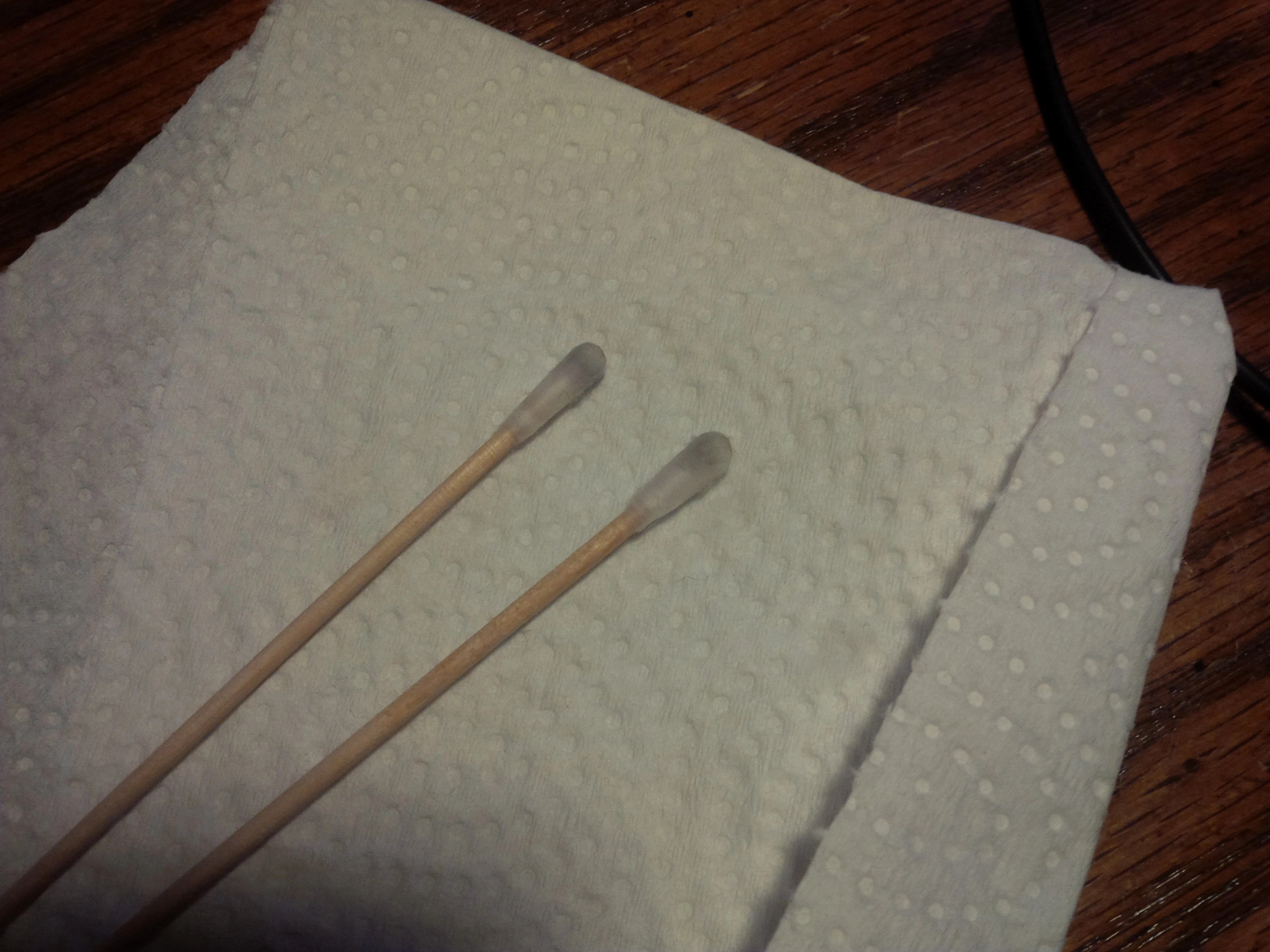

Here is a picture of the swabs. Not much dirt on them, but it could of been the cause. Time will tell.
Solder joints can look good, but unless you get a bright light and some kind of magnifier on them you're not likely to see the break. Point is don't just go off of "they looked okay."
The DeoxIT is fine to jet into female connectors. It doesn't have to be dry, but it's not a bad idea. If I'm in a rush I will usually use an air duster to blow out the excess cleaner using a rag to catch the blow-out. You are using the D5 contact cleaner and not the F5 Faderlube, right?

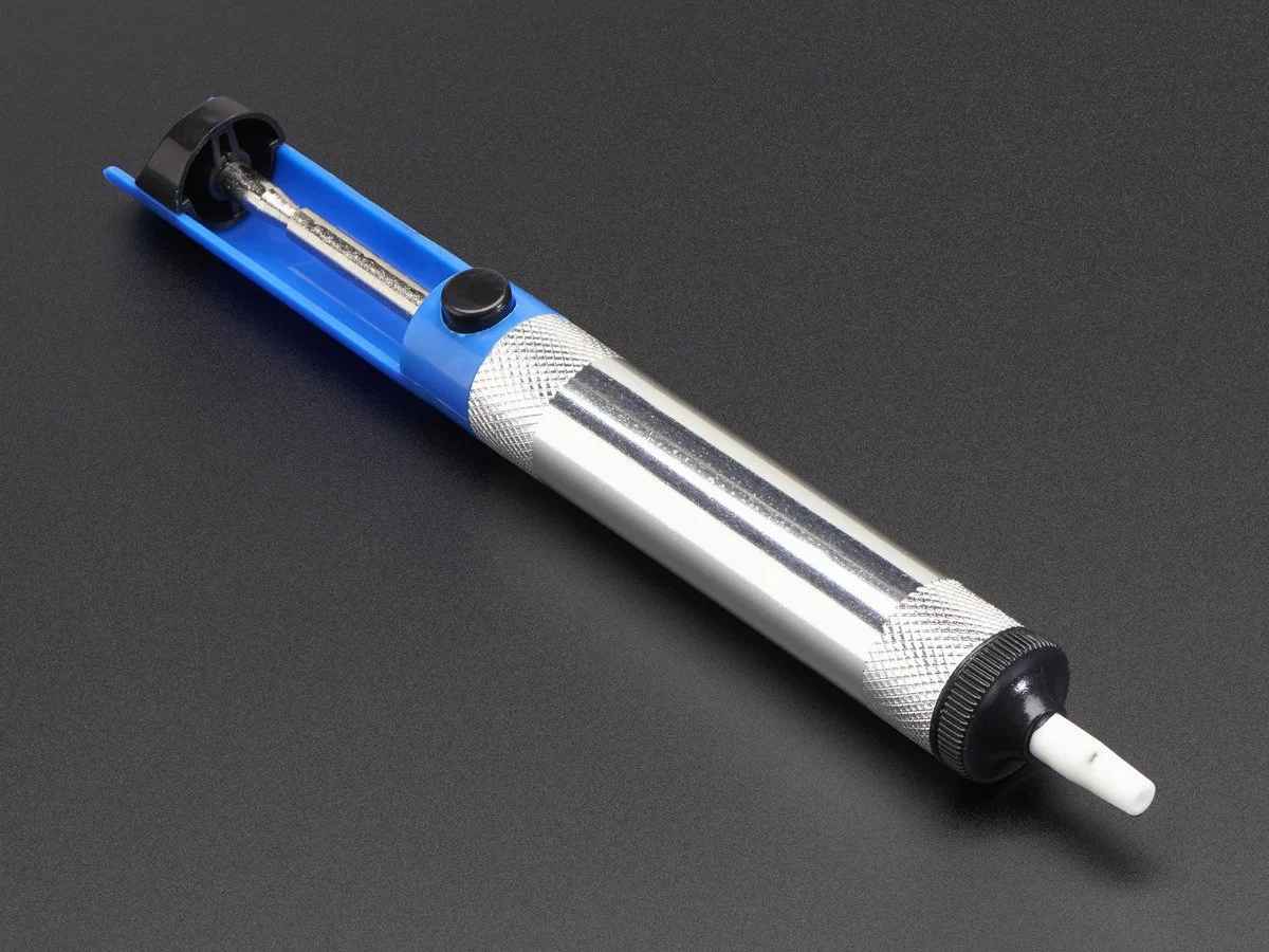

Please do not use solder wick. Get a vacuum solder pump. Even one of the affordable manually actuated spring loaded ones. You'll thank me.

Well do you have the kind that is just like a rubber bulb? Those suck. I'm talking about something like this:
$5
I don't like the wick because it's not quick and clean, and being quick is crucial. The spring-loaded sucker pulls all the solder away quickly so you minimize the amount of time heat is on the joint, and maximize removal. FYI though if you are just re-flowing joints I don't typically remove any solder...I just melt the existing joint and add just a touch new solder...more than a touch if the joint looked light on solder.

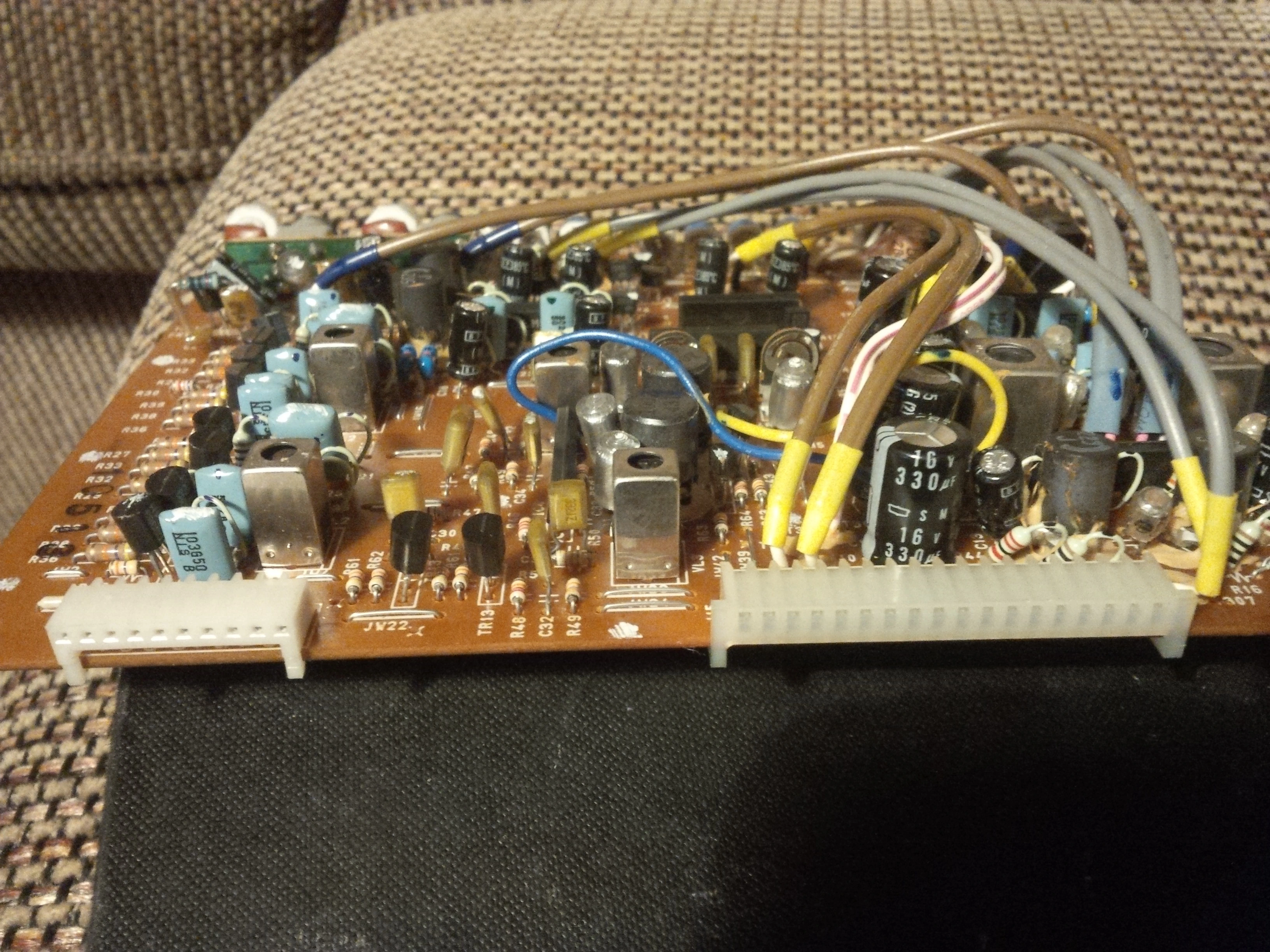

The female connectors are on the rec/pc pcb.
I think the smaller of the two is the one that might be losing it's grip.
Ohhhhhh I thought the unit was outfitted with card edge connectors. Okay. Well the larger of those two connectors is a Molex assembly I believe and those can be problematic. You may want to see if you can find a way to tweak the sockets in that housing to ensure positive contact. Is there any way you can get me a close up of the sockets on the connector? I'm sorry to ask that when I've got two MG1212s sitting out here in the shop, but the way they are sitting right now it would be a pretty major effort to move things around just to try and open one up...not that I'm not itching to do that with all your awesome exploratory surgery you're doing, but it just isn't in the cards until well after the new year.

if it is the smaller of the two connectors that would be odd because those are the same used throughout pretty much every Teac unit from the 80s and I've had really good luck with those. But something to watch for is the connector housing losing its grip on the card. I have had good success using cheap superglue to help keep the housing anchored to the card. Let me know if you need more detail.
