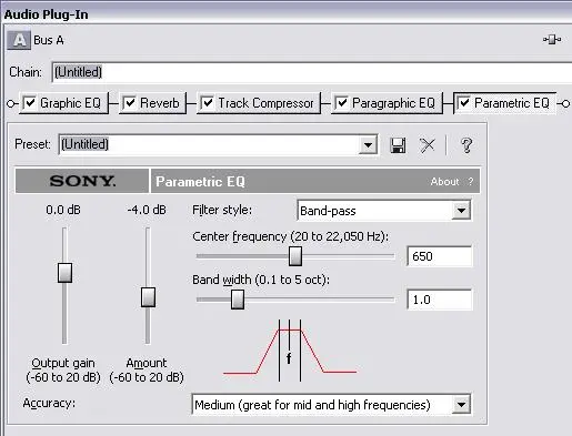

Would my Parametric EQ plugin do as shown in the picture below. I think that is what you guys were talking about.
The band width determine how wide a band it works on.
The center frequency is the frequency around which the band is. And I just change that around and that is sweeping.
That sound right?
Thanks all. :)
