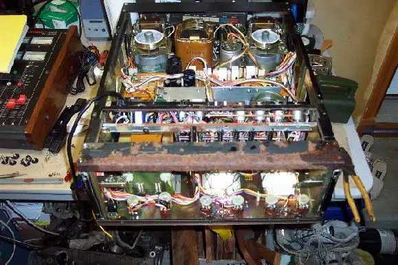

We will see. Photo 1
Here is a before picture. As you can see my work is cut out for me. The rust is limited to some specific areas away from the electronics so I am not too worried. Those parts are out, de-rusted and repainted today. I'm out of board cleaner so it will have to wait a few days for an "after picture".
Right now the deck is mostly apart.

evm1024 said:
The rust is limited to some specific areas away from the electronics so I am not too worried. .
grrrrrrrrr, this looks like the bottom of my 10 y.o. VW... :eek: the guts looks all right on the pic. :cool:
what exactly do you use to 'de-rust' a such thing?
YO! superbeatballer, I strongly advice, recommend ...NO!... actually demand you to edit your signature! It's ain't cool, dude. :eek: :D
Naval Jelly

Get the part free and pull off the lose rust with a wire brush. Then coat it with Naval Jelly and let it sit for 15 minutes or so. Rinse with water and do it again as required. Naval Jelly is a gel of phosphoric acid which reacts with the rust.
Once you have all the rust off (especially inthe rust pits) degrease it and paint it. Some folks use epoxy paints but for this a spray enamel should do fine. (For your VW look up POR-15 www.por15.com)
That machine is a wreck!!!........... :eek:
Yes it is. No party here. Gotta take the white gloves off and clean up some rust ;)
