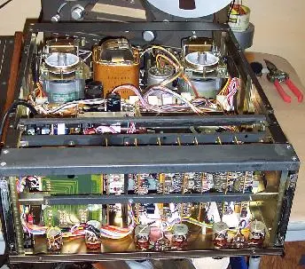

Yea, At first it looked real bad but that rust is mostly surface and away from the ekectronics. Here is a photo after removing the rusted parts and giving them a good wire brushing (Wire brush in my drill press at 4000 rpm) to remove the lose stuff. Then a few navel jelly - rinse cycles till the rust inthe pits was gone. Degrease and a coat or two of paint.
it cleaned up nicely.

one more photo
Having gotten rid of the rust I cleaned the electronics and connectors. Pretty much having pull each sub assembly out for the task. The XLR connectors were losing their chrome plating so I trashed them. It takes me a long time to get around to ordering parts so who knows how long it will be before I buy new ones. (I've got a pile of 2sk170bl waiting 6 months on me to order 4 1g ohm resistors for my Oktava... but that is a differnet story)

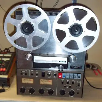

Here is a photo of the front after just a little wipe down. Due to the history of this machine and the generally low prices for ATR700 I do not expect to resell it. I just would not feel comfortable putting it up on eBay without it really proving its self.
But that is OK. As some of you know I am more of an engineer/DIY type. SO I expect to get this this running using the existing internal balanced preamp then convert it over to use a (homebuilt) Jensen Twin Servo preamp with phantom power.
That would be more in line with the type of projects I like (OK, OK used to do and have not done in ages) which are live recordings of pipe organs.
Anyway here is the photo.

Latest photo
I'm feeling good about the way this deck is coming along. It is playing and recording and in general doing what it is designed to do. I've not done a full calibration yet as that I am still changing caps and other odds and ends as time allows.
I've tossed the old chipped side panels and decided that White Oak would look nice. Here is a photo of the deck with unfinished side panels. Sorry about the bragging but I am very happy with it.
Ah, the image upload limit is too small so here is a link:
http://arafel.org/audio/atr-700/image/wip-1.jpg
