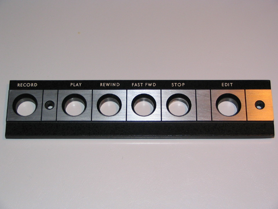

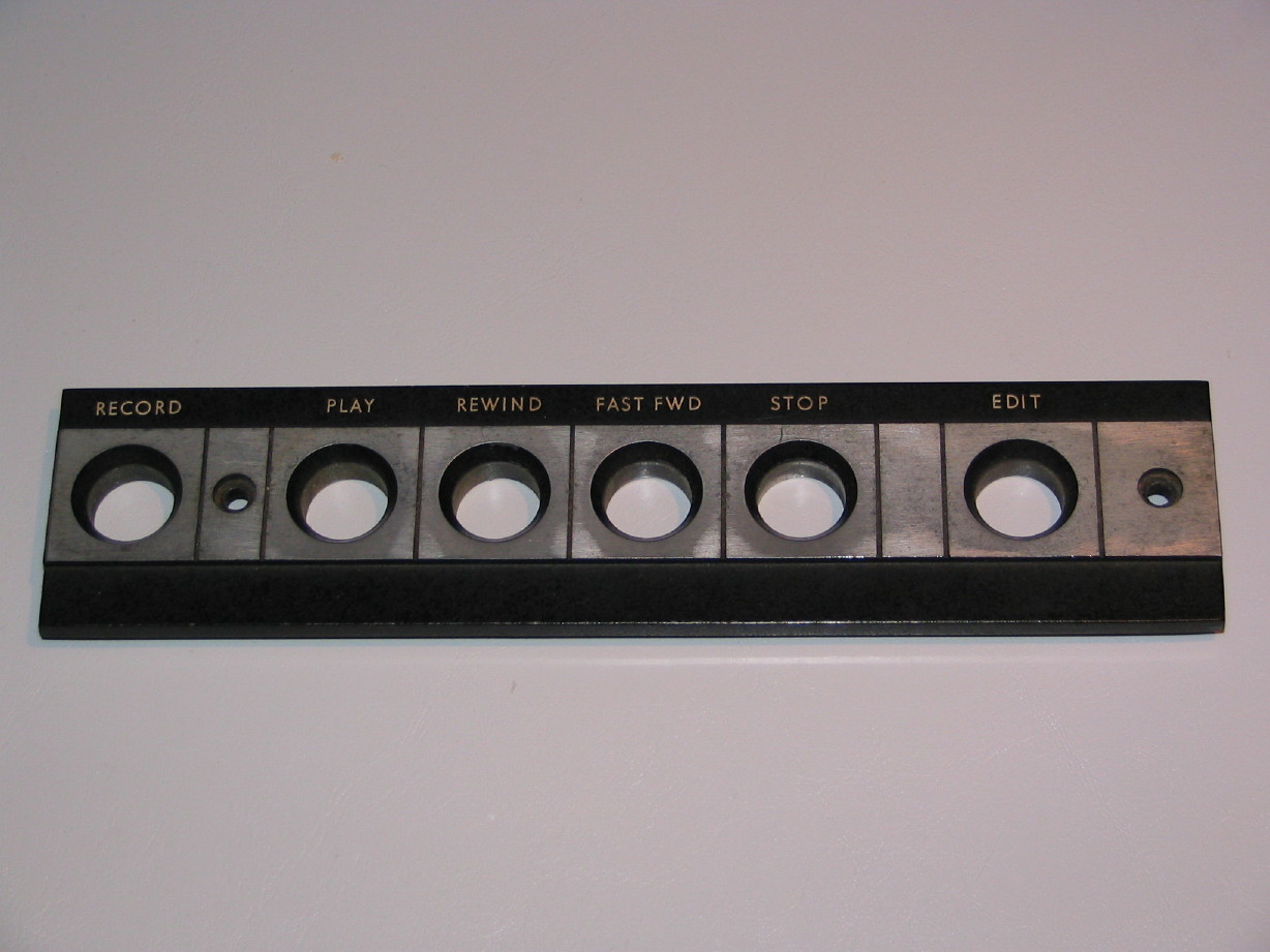

Just for fun I took the "Pushbutton Escutcheon" (the plate that goes around the transport buttons) and cleaned it up to get sample of how the rest of the cleanup might go as I get to that.
Simply sanded the face of the escutcheon and then used window cleaner, a toothbrush and a little piece of old ScotchBrite pad to clean it up...found neat little automotive touch-up paint vials at Wal-Mart. They've got lots of colors but basics too. I bought black. :D It comes with a little integrated brush. I found that if I lightly touched the spots that were chipped, let it dry and then lightly scuffed the new glossy spot could get it to totally blend in with the eggshell sheen of the original surrounding paint.
The pictures, before and after don't do it justice. It was really yucky before, and is really nice now. As an aside I tested a little spot using my TR-3 auto finish cleaner/polish/protectant (which has become a real favorite for me in cleaning up all sorts of stuff) on the stainless dress panel of the parts 440...wow...that's going to look nice.
Anyway, here's the before and after shots of the escutcheon:
Before:
After:
