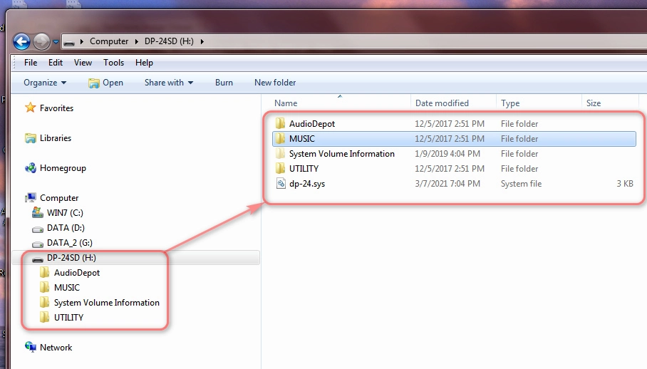

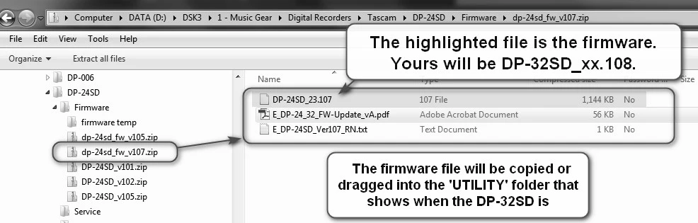

I actually did an update on my DP 24SD today as I hadn't really checked Tascam's site frequently. The update is done using a USB connection to your computer and copying the updated firmware file to the 'UTILITY' folder that will show in the Windows Explorer as shown in the screenshot image below. There are instructions for the update in the zip file from Tascam's site that includes the firmware.

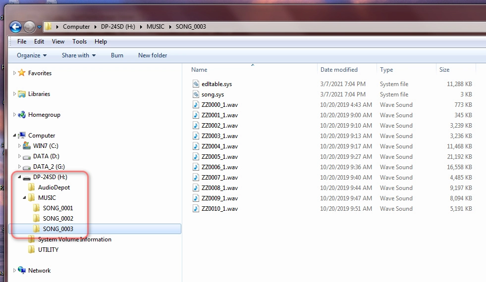

I also included a screenshot of the file structure for where the track WAV files are located. These WAV files can be copied over to your computers hard drive and imported to a DAW software program if you wished to do further editing.

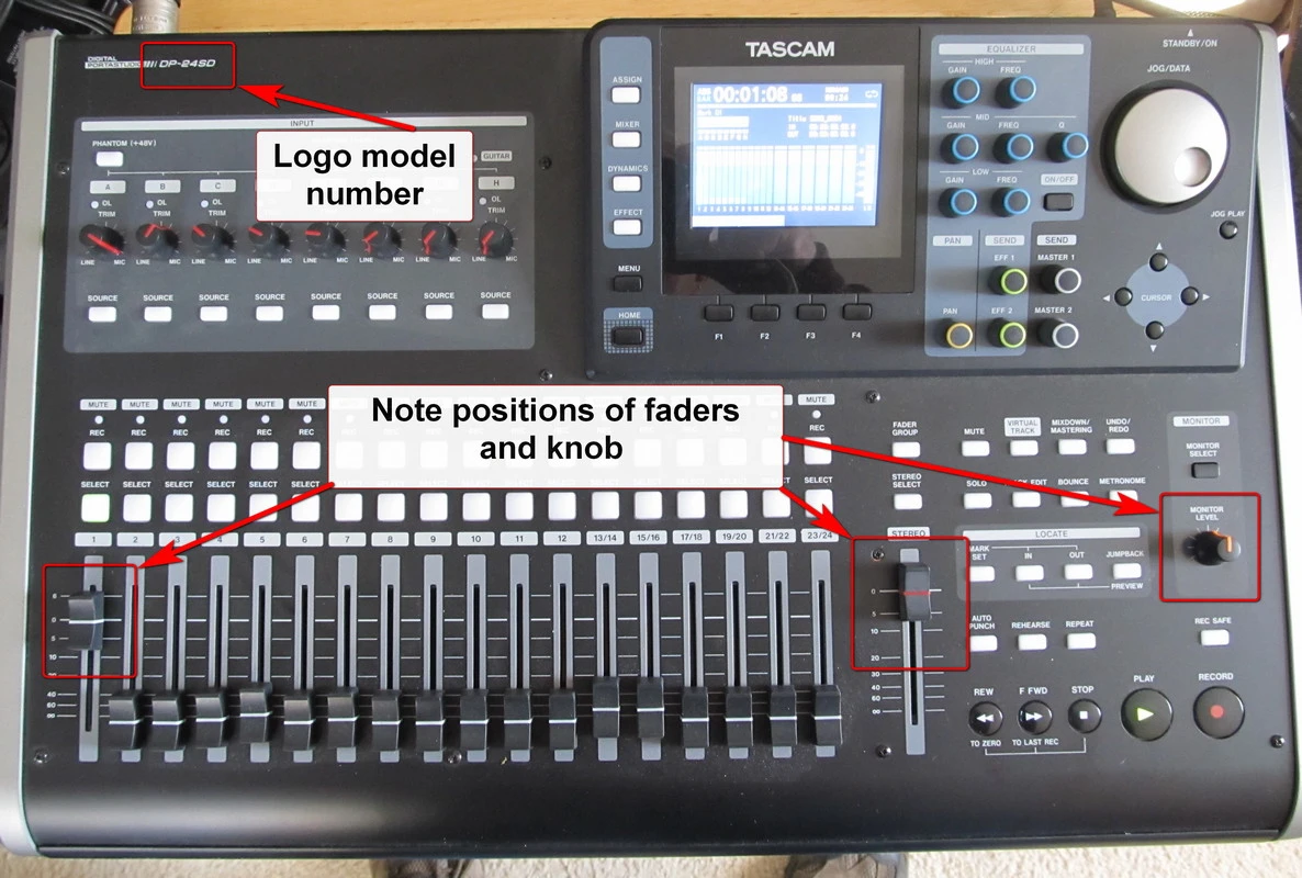

If you have audio showing on the VU meters on the main track screen you are close, but seem to be missing something. I tried to figure out what might make my DP-24 not have audio in the headphones but couldn't without really messing up some button presses. I attached a top view of my machine where the faders and knobs are positioned to get output when 'PLAY' is presses and audio showing on the VU meters. Your faders and the knob should be similarly positioned. Also the logo that shows the model you have.

Ok, it sounds like you have the DP-32SD and the firmware version 1.08 would the correct one. The correct USB to USB mini cable is linked below, not one that has an HDMI connector on the end.
The firmware you downloaded is compressed in a zip file which will need to be unpacked/unzipped to a temporary folder where you can copy the update file to the 'UTILITY' folder in the DP-32SD once you connect it via USB.. I've attached the firmware PDF instructions in this post also.

If while you have the DP-32SD connected via USB, you can look in the 'MUSIC'> 'SONG' > SONG_0001' for WAV files that you may have recorded while testing.

1] your monitor selection is not set to "STEREO. It is set to Stereo and was! 2] Monitor level volume knob is set to 12 o'clock and was. or your master slider is also pulled all the way down. 3] master and track faders are up and were. Headphones are in the 1/2 Phono jack an phono jacks from personas speakers to Monitor stereo out.
Changed from stereo out unbalanced rca to speakers / changed to Phono 1/ Jacks balanced output. Assigned track 1 . . . rec button flashing .., levels faders monitor way high hit Record. Meter is moving.
