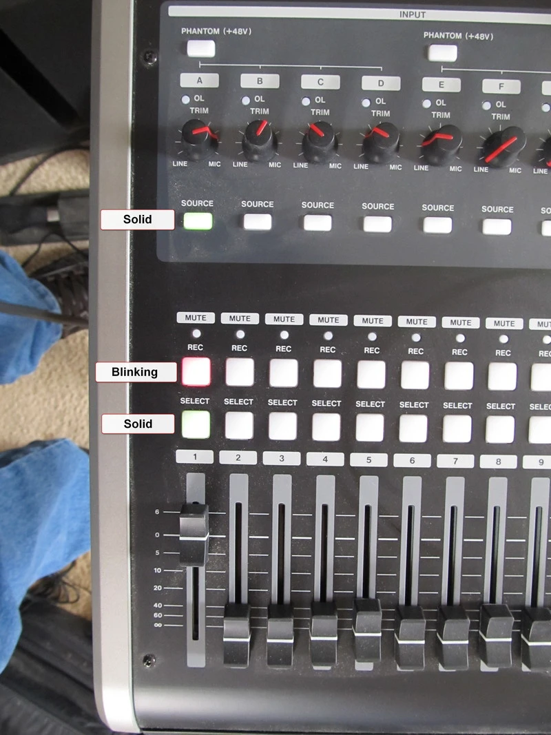

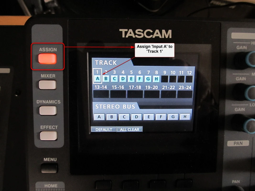

I set up my DP24SD and took a few pics of the basics to set up to record. First and foremost did you format the SD card in the DP32SD? The formatting in the machine sets up the folders that are needed. I think it may ask you to format the card on power up if it doesn't recognize the card. Be sure the SD card is not 'locked' by the switch on its side. I took a screenshot of the SD card file structure as it looks in the computer. Win10 should be OK for file transfer, but don't use it to format the card.
For the explanation below I'm assuming the previous owner did not have any weird settings that would give different results. You can set the machine back to default factory settings in 'MENU'>'PREFERENCE'>'INTIALIZE'. The manual does explain this if you think you may want to do this and it may not be a bad idea.
- Press the 'ASSIGN' button to bring up the display show below. In the image of the channels I've selected the 'Source' as input 'A' and this is shown in the display. If you select a different input using the 'SOURCE' buttons, note that it changes in the display. Select source input 'A' for now and plug your dynamic mic into input 'A' using an XLR to XLR cable.
- Next we'll look at the 'SELECT' button. This selects which track will be recorded to. Try selecting different tracks and note the display will change to the track you've selected. Select the recording track as track '7' and note that the default source is input 'G'. While still on track '7' select input 'A' with the 'SOURCE' button. It's easy this way to leave a mic in input 'A' and assign to another track to record to.
Select the assignments back to track '1' with input 'A' assigned to it as shown in the image and press the 'HOME' button to put you back to the screen that shows all the tracks with the time counter display.
- Set the 'TRIM' knob (mic gain) on input 'A' to about 2-3 o'clock. Set the track '1' fader and the main 'STEREO' fader at '0'. Set the 'MONITOR LEVEL' knob at about 12 o'clock (this will adjust the headphone volume.) Plug some headphones in.
- Press the 'REC' button on the track. This 'arms' the track so it's ready to record and blinks while armed. At this point hopefully you may see the track VU meters showing signal if you speak into the mic. You should also hear your voice in the headphones. Pressing the main 'RECORD' button will start the record to the track. The counter will show the timing and the track 'REC' button will be solid.
If anything seems to need clarification let me know.

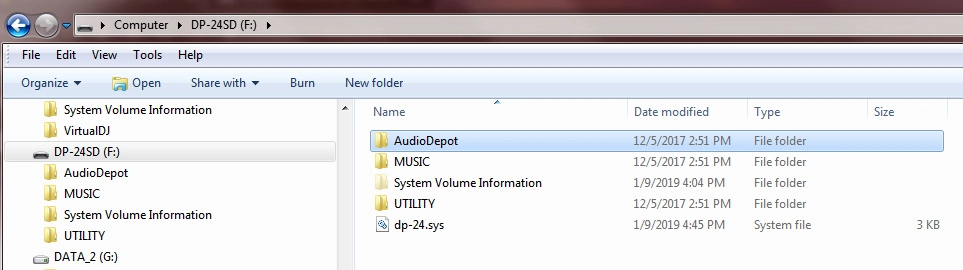

Hello Arcaxis: Windows 10 is OK for file transfer, but don't use it to format the card. Only have windows 10 on my 2 computers?
MENU'>'PREFERENCE'>'INTIALIZE'. The manual does explain this if you think you may want to do this and it may not be a bad idea. Done! I also noticed the monitor off in preference mode so I turned it on. Done, and took card out with recorder off when factory reset happened! Card is in down position or not locked and also formatted. Card is back in recorder. So far so good! Followed your next steps assign etc. You should also hear your voice in the headphones. Pressing the main 'RECORD' button will start the record to the track. The counter will show the timing and the track 'REC' button will be solid. Did everything as asked, only drawback I can't hear anything in my headphones "with monitor level as you described 12 o'clock, yet everything else appears normal? When I tap the mic it shows on the meter and appears to be recording with time being metered. I am not sure if its actually recording but it appears so?

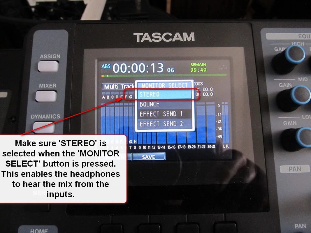

It sounds like you've made some headway if you can see the VU meter showing signal (y)
- In my preferences the monitor mode is selected to 'OFF' and appears to be the default setting. There may be a particular reason to have it on, but I'm not sure what it exactly does and perhaps better to leave off for the time being.
- Again Win10 will be OK if you need to transfer WAV files to your computer via USB or using an SD card reader, just not for formatting the SD card. When the USB connection to the computer is enabled, the DP32SD will simply look like another drive in Explorer and you can copy WAV files from there to your computers hard drive.
- One other thing that may affect the audio getting to the headphones is the 'MONITOR SELECT' choice. Pressing that button brings up a sub-menu and in that you'll want 'STEREO' selected (see attached image) so you can hear the main mix.
- If the VU meters show audio levels when you tap on the mic while recording, they also should show levels when played back if they were actually recorded.
What are you using for headphones (brand and model)?
arcaxis, Checked preference and I turned off Auto monitor as you say, the Monitor select button and on screen is in stereo mode and was, I have KRK kns8400 headphones, but on the up and up, I did get some meter action on the screen for the first time. I will try again later. I have the repair Manual and all seems good so far with all the lights etc. It is really extensive. Software version may not up to date. It says 1.06 0016 whatever that means If it is not up to date it won't take windows 10. I'm still not sure how to update it yet?​

Here is the list of approved SD cards. DP32SD Card List
The latest software version is 1.08, and is available on the same Tascam website as the card list. You might want to check out the release notes for the changes.
I don't know if I would try to update the firmware until I knew I had the recorder working.
