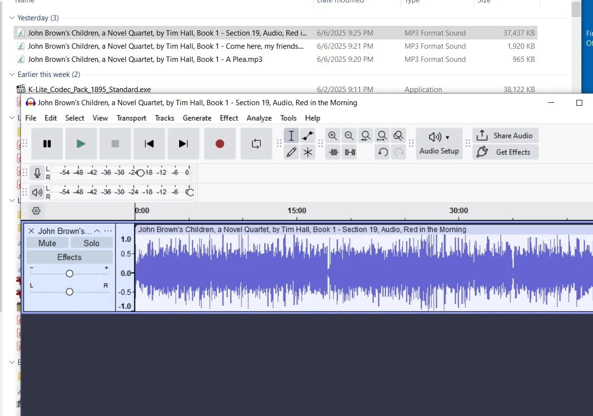

Checking the files, they are 96Kbps mp3, which for music would probably be an issue, but used strictly for voice, I think that will be fine as it goes out to 15KHz, close to FM radio but it has a "phasey" sound. I'm sure they use that spec to save space, as you get about 14x compression, which saves a lot of storage, and reduces bandwidth as well.
I will agree with Raymond that there are numerous pops and clicks that are evident. The room sound is very strong, and there are the some extraneous noises throughout.

Just a final note. The MP3 files I downloaded load perfectly into Audacity. I haven't had time to really listen on headphones for quality, or if there might be things that could be done to clean them up.
It's a bit of a shame that you didn't find us earlier. The better way to do this would obviously be to record the tracks at home directly to your computer, and not through Substack. But that's water under the bridge, the question now is how much reworking can be done.
At least you have access to all of the previous work. You just need to download the files themselves.

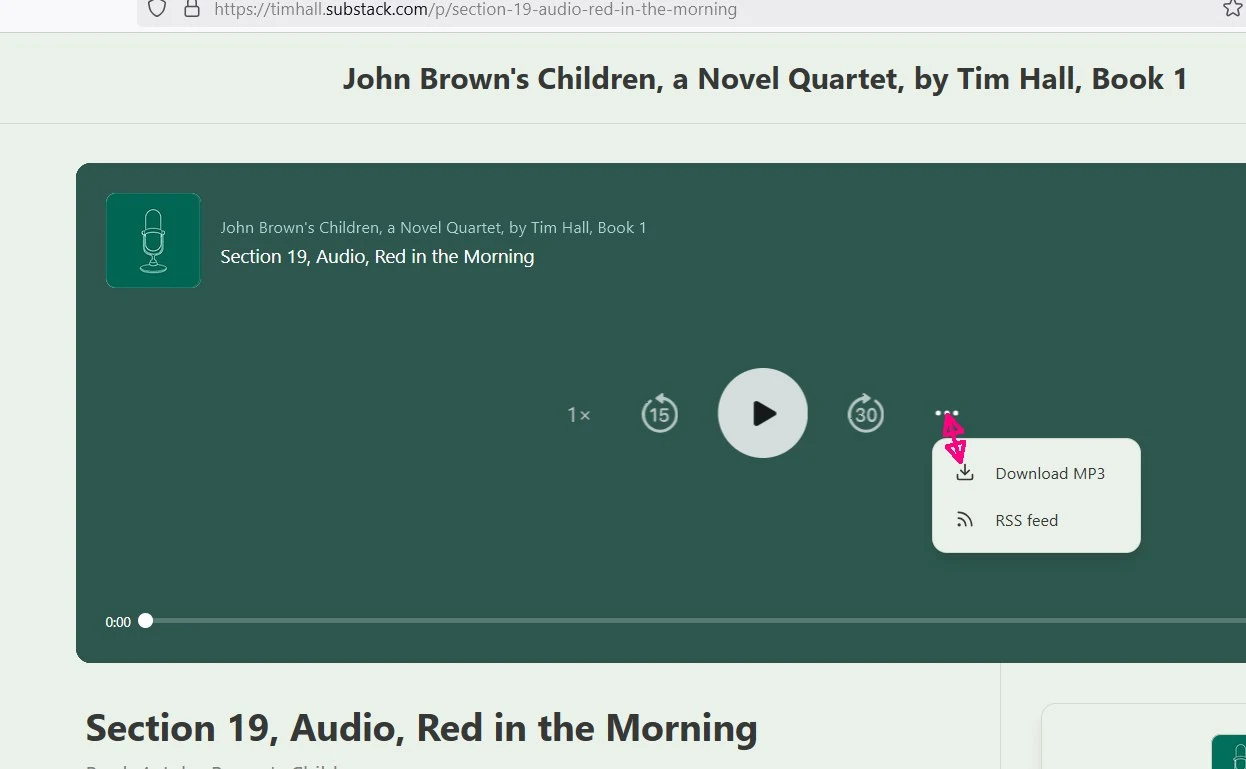

so there are files that i can access> wonderful! but this confuses me. i do not know how to do it. if i can, will embark on them for book on immediately. this is great news!!
When you look at each audio selection, there are 3 dots. Click on the dots and an option to download the mp3 appears.
ok will do that. many many thanks for the help. with "denfranchised", i think you mean with substack. ye, i am. but i am carrying on -- with this help you have provided!
