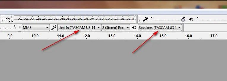

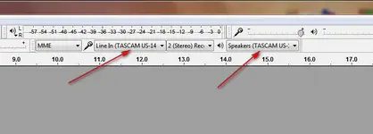

What DAW recording software are you using to record and are you using the drivers from Presonus for the Audiobox. Does your recording software show the Audiobox selected for the recording device similar to below in Audacity for a Tascam interface?
