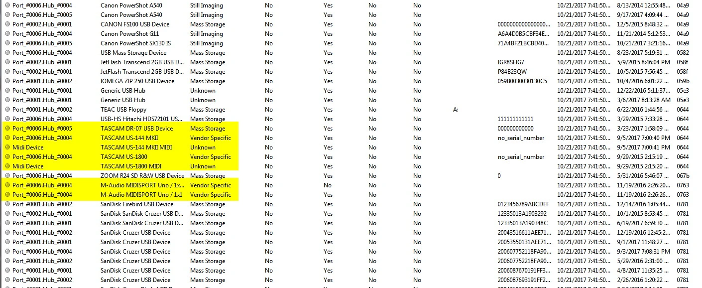

I'm guessing there may have been some dialog with the driver install such as 'New Device Found' followed by 'Installing Drivers' (as you had noted). This is pretty much standard for Windows (I think). I believe mostly it gives the device an identity so the computer knows what gets plugged in.
Below is a screenshot of a section of USBDview that show USB devices that have been installed on my PC. Most all without dedicated drivers have had Windows do its thing 'installing drivers'.
