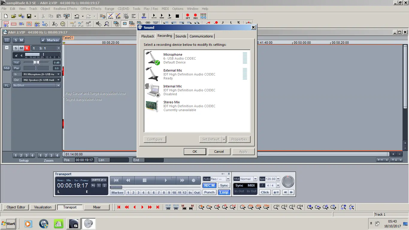

Ok upon looking at my setup here I’ll try to post a screenshot of the ASIO program I had on comp along with the settings at top and how (I think) I should set it at the bottom? Haven’t tried it yet because there’s no directions, but I'm assuming this is what I do?
Maybe I don't have permissions to post the screenshot? I tried from phone and pc.
I'll just give it a shot n see if it changes anything as far as my pc and the A&H mixer
ok so I made sure that the USB AUDIO CODEC was selected for both speaker and mic, then tried it in Cubase and Audacity - still NOTHING!... sigh -- Because it's the same on ALL of the DAWS I have installed and Still DOESNT WORK, I'm thinking it's got to be a universal setting on the comp I'm missing, or the USB send is not working properly? I had already installed and ran the ASIO program prior to posting here, but went back and Unchecked and RECHECKED the proper boxes for designating those settings to be default, but nothing...

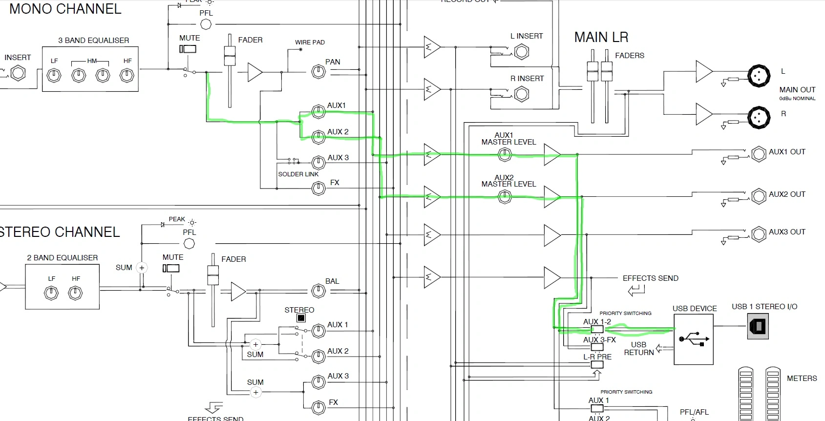

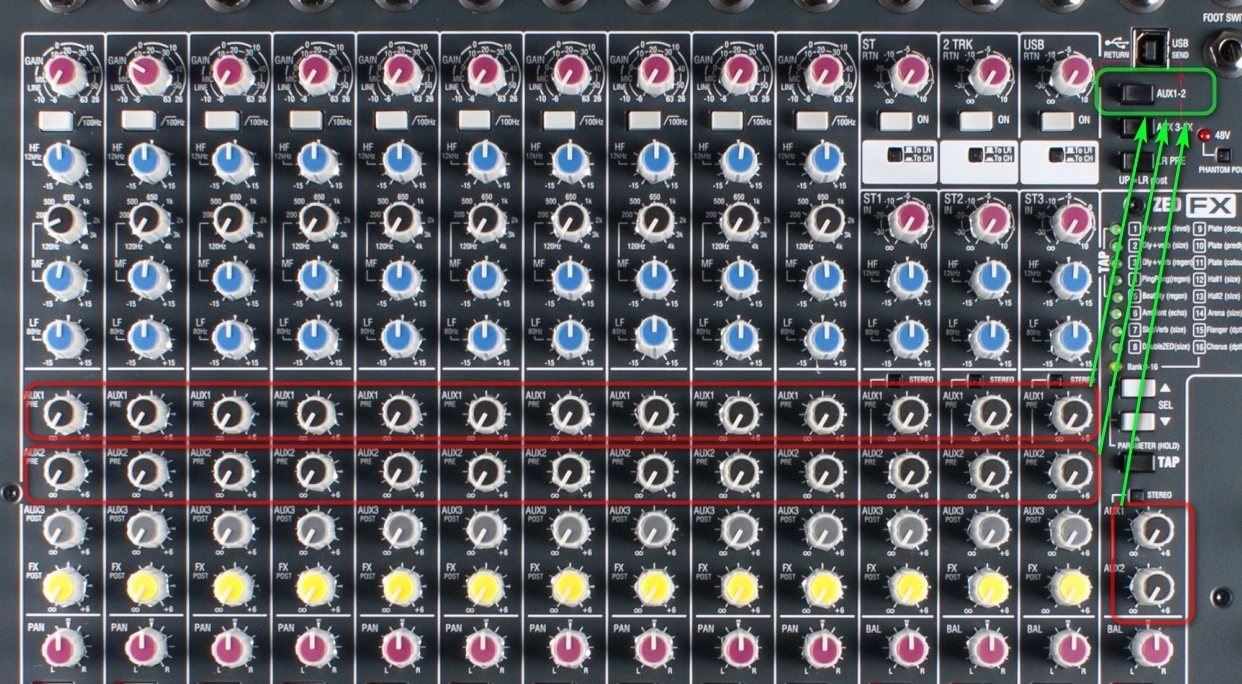

I'll take a guess........ :)
Is it routing of the signals on the board? Looks like to get a channel to the USB it needs to hit the AUX 1-2 bus and go through a switch. Plug something into the AUX 1 or 2 bus outs that you can monitor with to make sure signal is getting on the bus and out. The AUX 1 & 2 pots will need to be cranked up a bit.
Looked at it again and the signal can come from the Main Bus as well, either pre or post Main fader. If set for post main fader, make sure the fader is up.

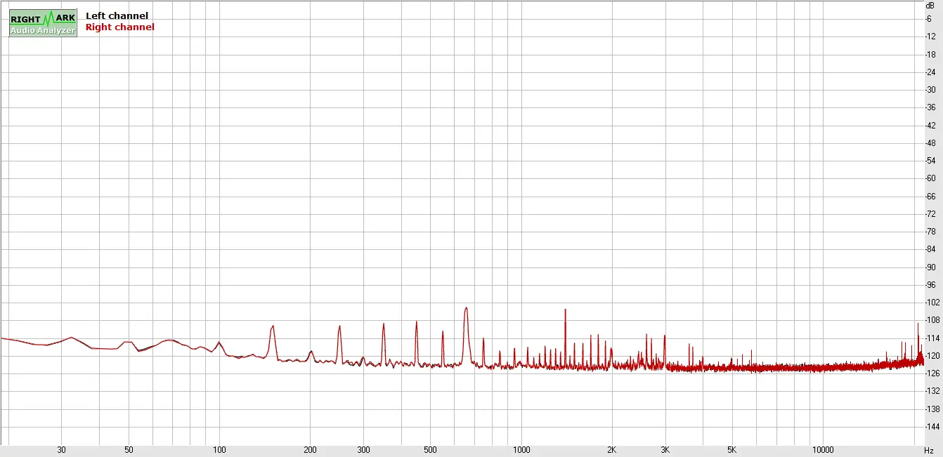

Got up crack of, hooked A&H to HP i3 laptop. Now, did you wait until the 3 driver/CODEC installations had finished? I did.
The mixer recorded fine, actually a battery metronome. N.B. Rec' level were set in Windows to 5% and with the mixer's meter blipping the FIRST LED I get -15dBFS or so on the DAW (Sam SE8) .
The spectrum shows why these early 16bit USB mixers are such a poor idea*, lots of spikey stuff. To be fair, the peak noise is a decent -74dBFS and rms even better at -86. Most specs give weighted figures to they would likely be -80 and -90 in the sales blurb. The NI KA6 (and most other modern 24 bit AIs ) would be better than -100dB unwtd and no spikey bits!
On the mixer, you need the 'REC' button pressed to send the signal to the USB converter.
All this done a bit quickly with Sam 8 but can try Audacity if you like. One possible issue, you have got the system set for 16 bit record and play?
*This is NOT a failing of A&H! All the first generation USB 16 bit mixers had this 'artifact' problem, inherent in the then available chips I guess? A&H and others have moved to 24 bits as soon it seems as it was economically feasible. In fact, properly setup in Windows, the mixer is capable of excellent recordings of 'noisy' stuff like a rock band. All that USB crap will be WAY down on pub noise!
Ooops! Did not say! SM57 25mm from metronome.
Audacity CAN NOT read ASIO files. CB can as far as I know.

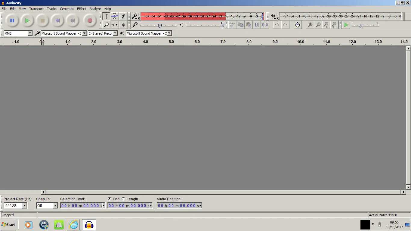

Ok, gimme a few mins' and I shall setup Audacity...
Oh! Weirdness personified!
See attached. The ONLY way I could get a signal into Audacity is using MME drivers and Ms Sound Mapper. I went through all other permutations AFAICT.
Note, set in 'Edit/Preferences' for 16bits and the above driver and device. I have slammed the levels (50%) for the duration.

Ah! Anyone know why the grey area in Audacity is empty, no waveform? It gets grabbed from Sam.

Ah! Anyone know why the grey area in Audacity is empty, no waveform? It gets grabbed from Sam. Dave.
"Microsoft Sound Mapper' or simply 'Wave Mapper') often becomes the default driver for both audio playback and recording after you install a new audio application, and it may if you've recently installed a new audio interface. However, it isn't really a driver, but a virtual device installed automatically with Windows, which simply results in your application using whatever default devices you've already chosen for both sound recording and sound playback in the Control Panel's 'Sounds and Audio Devices' applet".
I have yet to have "Sound Mapper" work on any of my applications. I read the explanation above from this site. It may help you out.
I think we are at cross purposes here Mack? I was just referring to the lack of modulation in the screen grab, Ms Mapper worked fine..but nothing else did and I wondered if this is a byway the OP had not tried?
(I have since done another 'grab' of Audacity and it worked! As I have said, many times, I am better with valves.)
So what settings did you change? Was it in Audacity or SAM?
Didn't change anything AFAIK, just played an Audacity file and grabbed it and there it was.
