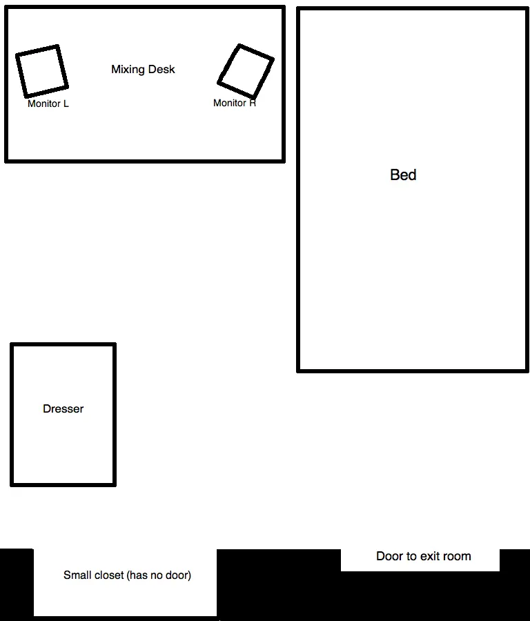

I know next to nothing about acoustic treatment so I'm hoping somebody here can help me come up with a good treatment plan for my room. I'm in a bedroom studio that measures 11 x 9 feet, however, we're going to be remodeling soon and will end up moving a wall (the right wall in the diagram below) to make the room 11 x 11. Here's a really rough sketch of the room:
I generally use this room for mixing and tracking vocals, acoustic guitar, and live guitar amps. A lot of bass gets trapped in the lower right corner near the door.
So what are my options? I'm open for moving some furniture around to make the space better, but it's a pretty small room so there's only so much moving I can do. I'm also up for building bass traps, etc. I don't really have a budget for treatment, but I'd like to get the best results for the least amount of money.
Grrr... sorry for the extra attached images.

Thanks, that's a good start. So do you think my first step should be to put bass traps in all my corners?
Yep, taming the low end is the first big challenge. Everything is important of course, bass traps are just a good place to start.
Also just a helpful hint for mixing. It's not a good idea to have your desk in a corner like it is. Think about it, sound is hitting the closest wall before the other and bouncing back to your ears. You want to have your desk centered on the wall.
After you expand your room:
Move your bed so that it sits left to right against the "the top wall"
Center your mixing desk against "the right wall" between the top and bottom walls.
Leave the dresser approximately where it is on "the left wall".
I’d suggest 3-4 2ft X 4ft panels of 4” thick compressed fiberglass on “the right wall” behind your mixing desk and I’d do the same on “the left wall” directly across from the panels on the right wall.
You’ll need more acoustic material including bass traps to get your room to a decent mode to record and mix in, however, I highly suggest you read the Ethan Winer Acoustic info using the link you were provided above to get a better idea of where to go from there.
There is a lot of reading to do there BUT, that reading will give you really good and rather quick education AND you'll definitely get some good ideas.

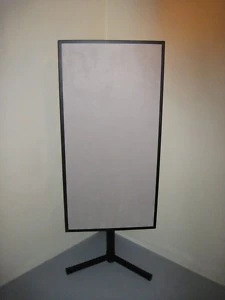

Well what you can do is make panel bass traps and stick them on stands so they're portable, so when ever you need them you can move them into position in the corners.
There's somebody on here or gearslutz that rigged up a little rail system that they hung bass traps from so they could easily slide them in and out of the corners when they needed them. Hopefully someone knows what I'm talking about and can link it. :o
Hard woods would definitely help liven up the room. And putting a cloud panel above the mixing position is a good idea as well.:D
The idea of that portable trap sounds really good.
