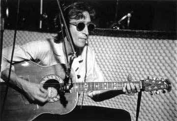

check the pic out.
is this standard egg-type foam sht or is there a million different degrees of this foam sht also..like pro-foam, garbage-foam, Behringer Ultra-Pro foam.
...just curious.
any info would be appreciated in relate to foam-

Foam is foam. And the best it will do for you is suck all the highs out of your performance.
Check out Owens/Corning 703 or Knauf Rigid Fiberglass Soundboard. Try a search here for those.
IHMO 2" is the most versitile and gives you the most bang for your buck.
Look to pay about $1.25US/SQUARE FOOT for 2" rigid fiberglass.
