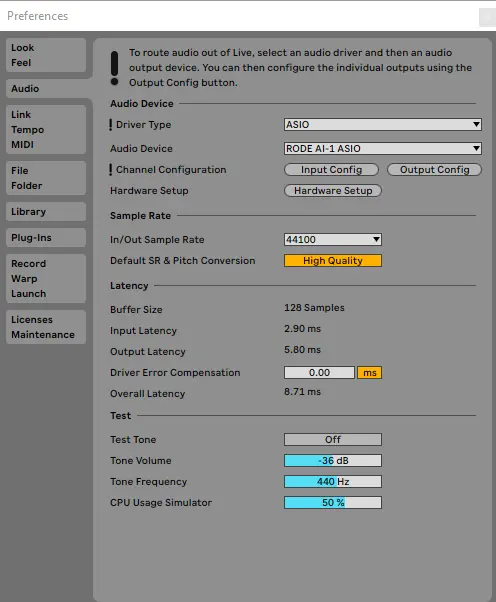

Looks like it does have ASIO drivers: https://www.rode.com/microphones/studio/nt1-ai1kit#module_9 , if you haven't already done so, install the interface drivers, then in Ableton select these drivers.
From what you hve on your hardware setup, that should not be an issue. Try the ASIO drivers see if that corrects the problem.
i just downloaded asio drivers for rode. though i'm confused now because it has no output setting, and no sound comes out if I play sound in ableton.

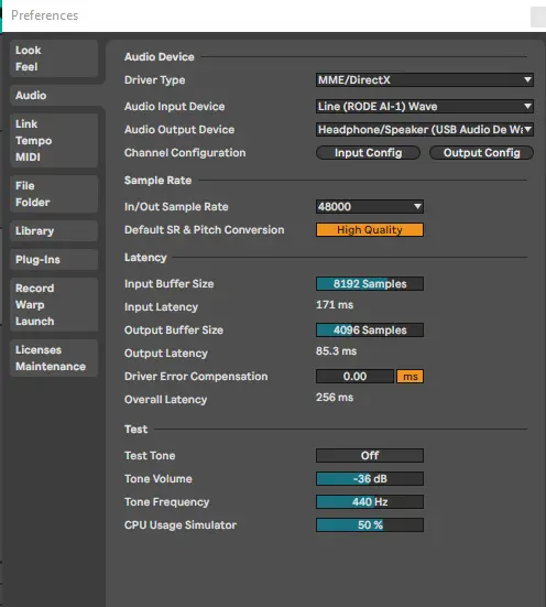

if I use directX (driver in my laptop), i can choose input and output device, and the sound comes out

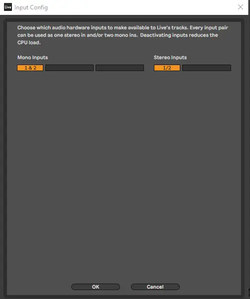

Once you selected your driver, did you go in and configure the inputs and the outputs (input config and output config)? Once you have ASIO, the options becomes more configurable.

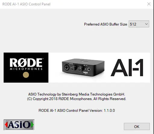

These are the windows pop up when i choose input config, output config, and hardware setup.
