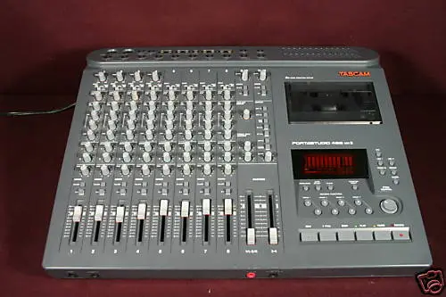

I have only one more thing to add; maybe helpful:
4-track Cassette Demo (424mkIII & single mic)
