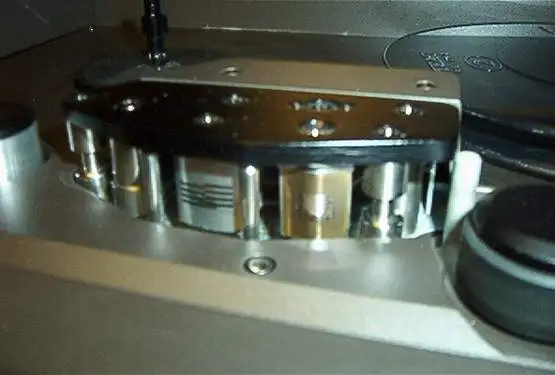

Here are some 388 heads

Thanks for the shot, Herm!
So. They are a copper color. I suspect that they are not in fact copper but most likely bronze or some other alloy mixture.
In any event, a copper color is not consistent with the color of dirt and oxide shedding so all is probably well.
Cheers! :)
thanks for all the replies. I'm relieved to see that there's nothing wrong with the heads on mine.
