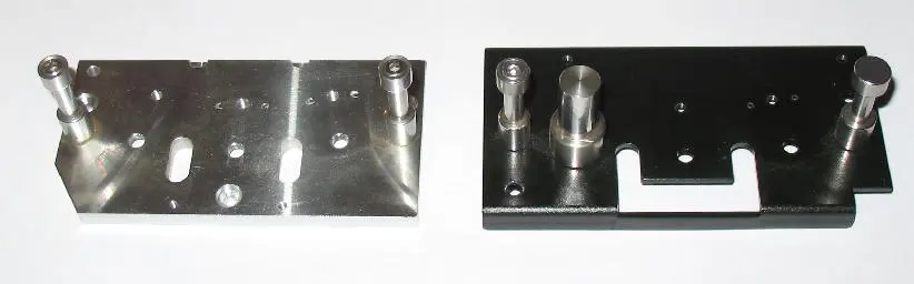

I'm with you in regards to the internals. There would need to be a place for switches and some un-populated PCB positions at least.
As you can see from the photo the 38 (left) is machined from a 1/4" Aluminum plate and the TSR-8 (right) is stamped steel. The TSR-8 ends up being almost twice as thick. It is a U shape.
I asked because you can see that the guide on the left uses one of the head mounting holes with the other behind it.

Okay, nice photos!
So much for that shared hardware theory! Gadz man!
I'd side with you now, that perhaps it was a planned upgradeability that they machined into the basic part, that never came to fruition.
Go figure.
Thanx again for the picz!:eek:;)
I've thought of adding a head myself, but the amp cards don't support it. The dummy pole in the first position also acts as a flutter filter.
