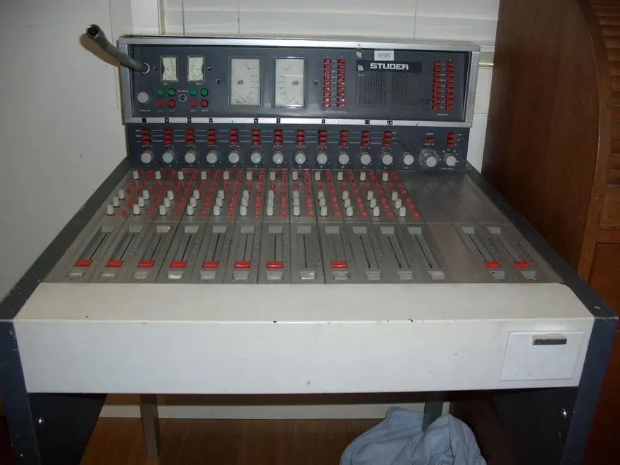

Here is a picture of my old '67 Studer 089 console. Made at a time when console design norms hadn't really been settled. It is really quite interesting inside. Over the next few posts I'll show you it being dismantled as I go after a noisey line amplifier in the main outs...

Most of these went into the broadcast industry. This one was ex ABC - The Australian Broadcasting Corporation. Being, ahem, portable, it's had a fairly hard life.
jjones wanted to know what the difference between a live, recording or broadcast desk was; well this one is not a broadcast desk but is a recording desk for the broadcast industry. It is 12-2 with 4 +4db returns so you can see it running a two track out or four track back recorder. We use it to record our experimental noise band running live to our two track Revox PR99 reel. In that role it's sweet.
It definitely comes from a different age. At a time when a compact, four door, six cylinder, family automobile retailed at $1,800 Australian dollars, this thing reputably cost $21,000.

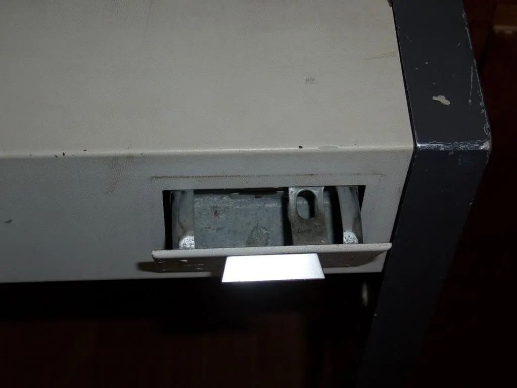

And, as every steely eyed radio man knows, it's not a real broadcast industry desk unless it's got an.....
ashtray...

It has these fantastic old style long throw faders. Inside they look like no other fader mechanism I've seen. The cueing system is interesting. Not only can it be patched up to the PPM's or the monitoring systems but it also triggers a 24v signalling system to switch a studio traffic light system when the fader moves off it's bottom infinity position.
It has 12 Pultec style preamps with a fearsome reputation. They sound amazing and you sometimes see them individually racked and sold off as rack mount units.
You can get a source from the channel's own universal XLR input, either of the two internal sub mixes or from the 4 auxiliary inputs. You can have normal, flipped or no phase. No phase effectively mutes the channel.
It'll run up to 81db of gain and being a hard wired Pultec style equalizer section you have a limited set of switch chosen EQ curves; 3 at 60, 125 and 300Hz, another 3 at 3, 5.5 and 10 kHz.
You can then add up to +/- 6db of gain at 80Hz in 2db steps or another +/- 6db in 2db steps at 8kHz.
Then you can add up to 9db of presence at either 1.5, 2.2, 3, or 4,4 kHz and that's your lot. Choose from the available combinations and no more.
It has two reverb sends but if you want to bring them back you loose 2 of your 12 channels.
Big analogue PPM meters to which you can patch in just about anything.
With another independent set of meters for the reverb sends. Here is also the com volume for the gooseneck mic going into the com system.
The monitoring system has a similar patching matrix to the PPM meters. The console has a pair of internal 20w amplifiers to drive attached speakers and another pair of 3w internal amplifiers to drive it's internal speaker and the com out.
The input channel can be routed and panned to the main outs or to either of the two internal sub mixes. These sub mixes can then be patched into any of the remaining input channels.
The monitor control volume is here along with the panning and the mono selection, a continuously variable test oscillator and cue volume.
