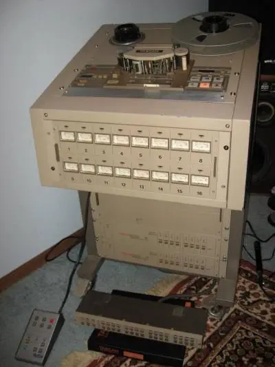

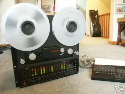

Tascam MSR-16; 1/2"; $650~$850 (est).:eek:;)
Tascam MS-16; 1"; $1000~$1250 (est).:eek::eek:;)
How you'd get 16 tracks to your 'puter using a Digi002?
Mix down from tape and dub to the 'puter in stereo.:eek::eek::eek:;)
