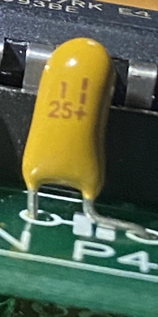

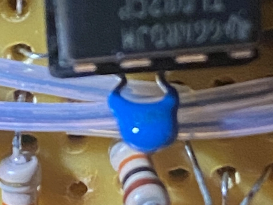

The tiny blue one says 470. The yellow tantalum says 1 over 25v. What values are these? Thanks for your help, friends.

The tant is likely 1uF/25V. What PCB assembly is it mounted to and what’s the part designator? “C” what? You can always look at the PCB assembly, locate the part identifier and then look at the schematic to cross-reference the values.
The ceramic cap I don’t know for sure but probably 470pF. But that looks like it’s mounted to proto board. Whatcha got going on in that MS-16?
