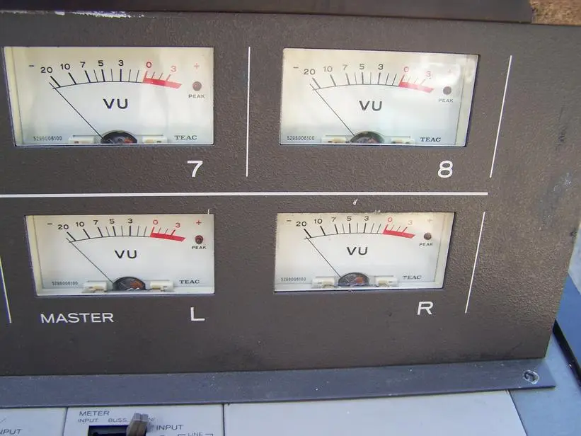

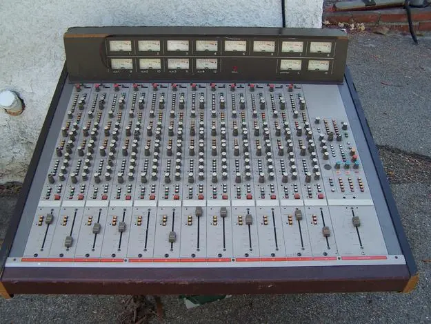

What do I have here? I found it at a yard sale.
Can I use it for recording and mixing on my computer and if so, how?
I really appreciate the advice.

What IS that???!!!?!?
MAN I wish I could tell you...!
But I look forward to finding out. It appears to be a Tascam or Teac broadcast console.
PLEASE PUT UP MORE PICTURES...A CHANNEL STRIP, THE CONNECTIONS ON THE BACK...SHOULD BE A LABEL WITH THE MODEL NUMBER ON THE BACK. :D:D:D:D:D
Man, that's cool...4 band sweep eq...looks like tons of inline routing options...how much do you pay for it?

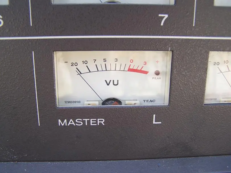

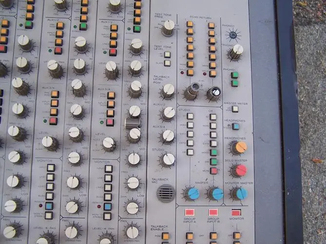

It does say "Teac"
Here are some more pictures:
On the back there is a multi socketed place for a power supply cord... that is missing.

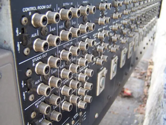

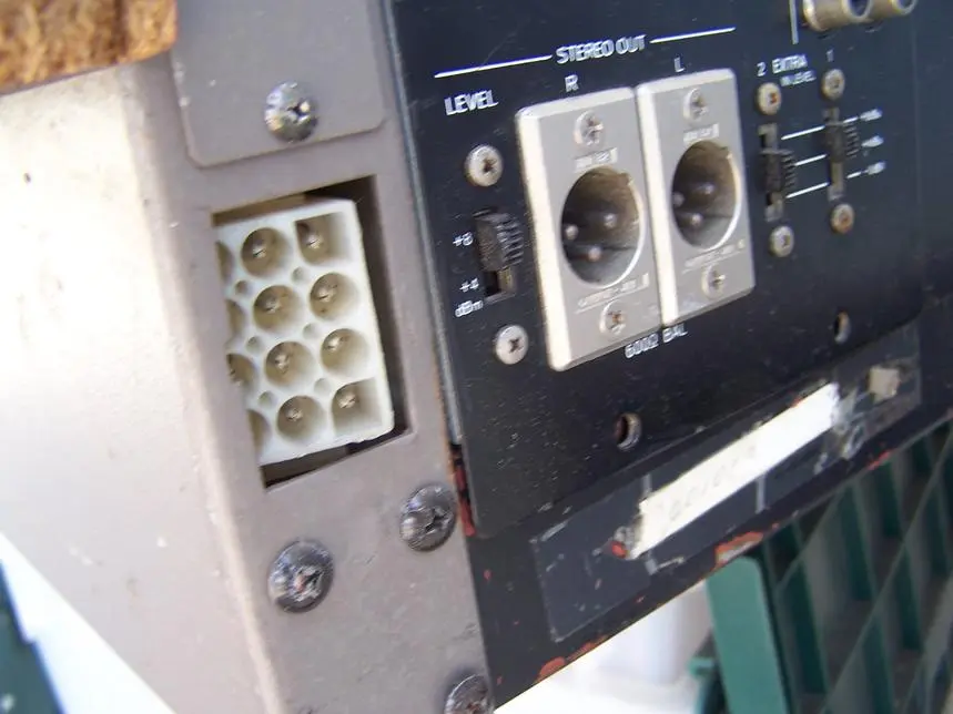

A few more pictures
This is the back of the console

:eek: Awesome! You've got to tell us how much it cost you. Yep, definitely a Teac board. You could use it to record, assuming your computer has an interface with one output for every input.

The power connector on the back is not original I don't think. I bet it used to be a Hirose connector. That's a molex...it is supposed to attach to a rackmount power supply that puts out all the different power rails...without that power supply the board will not function.
Just because the VU meters say Teac does not mean it is a Teac branded board. Look for the label on the back with the serial number and UL sticker.
What did you pay for it?
It looks like its in rough condition...like it has been stored in a moist environment, so while the sound quality would be good back in the day, who knows how well it is working now. Its an unknown until you can power it up, but you won't be able to do that until you can either find or build the power supply for it.

Definitely a nice find! I would say that if it's working properly would be a great recording board - the 'control room out' connections would seem to indicate it was designed ot be a studio board rather than a Live board.

The power supply I am missing is called a Molex?
Also, do you think I could get the missing power supply through Teac? I sent their parts center an email with pictures of it.
No...Molex is the connector type that has been retro-fitted to the back of the mixer...I will be VERY shocked if Tascam has the power supplies...they don't even carry the cable parts anymore.

I looked it over and the only spot where there had been a serial number was a taped over hand written number that has been torn in half with half or more missing.

I was looking closer at the partial channel strip shot in the first post...That's 4-band eq, but swept hi and low bands with two fully-parametric mid-bands. That's cool. The aux section is like the M-500 series...4 sends switchable in groups of two pre/post or source from a secondary input with their own mute switches.
