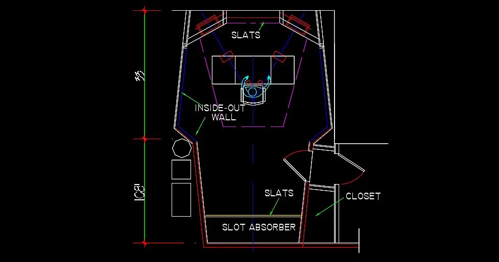

Excellent design, Rick. Thanks again for your help. I'm sure it would be a fine way to do it, however, it would be a problem in that there would be no space to use for rehearsing. I'm in a band of three (bass (me), drums, and guitar) and our 'prime directive' is to use it for practice, recording, and mixing our own stuff. I'd rarely, if ever, use it for recording other clients, which might sound crazy. :eek: O.k., I'm crazy.
I've flirted in the past from time to time with being a 'real' studio engineer, but each time I get into it, I fall back on my first love: writing music. If I had no band, I'd probaly make my own demos and attempt to sell them as a straitforward songwriter type.
So, anyway, I really need the open space at the back.
Thanks again,
Jack the Ripper
Punkin - square rooms are bad acoustically because you have the same modal frequencies in both axes - square rooms with same or half height ceilings are worse, because now you ALSO have the same frequencies reinforced in the VERTICAL direction - now, if you make the room ROUND, you have two INFINITE LENGTH parallel walls, PLUS the concave effect of FOCUSing sound to central locations - add to that the previously mentioned difficulty of BUILDING such a room, and it would take a special masochist to want to do this...

If you have a few DAYS to read, the first link will accelerate your learning curve by a decade or so without any of us having to re-type much - then, any followup questions will be better worded and more informed... (hint - there are better things than staggered studs)... Steve
BTW, John says 12 degrees total splay - I think it was Angelo Campanella that stated 8 degrees total was enough; yet another designer, Wes LaChot, claims 6 will do it. NONE of those is enough to accomplish RFZ monitoring, check out my illustration here, about 3/4 the way down the page -
http://www.johnlsayers.com/phpBB2/viewtopic.php?t=809&postdays=0&postorder=asc&start=60
