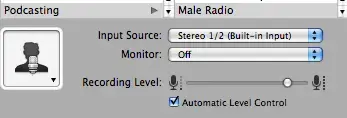

Without spending a dime, a simple option may be to check the GarageBand inspector and check the "automatic level control" box (below). Since you don't have variable gain on your preamp/interface, this could be a temporary workaround.

Actually, my version of GarageBand is the older version (3) so I haven't got that automatic level control box to tick...but I'm assuming it won't be as good as spending a dime ;-)

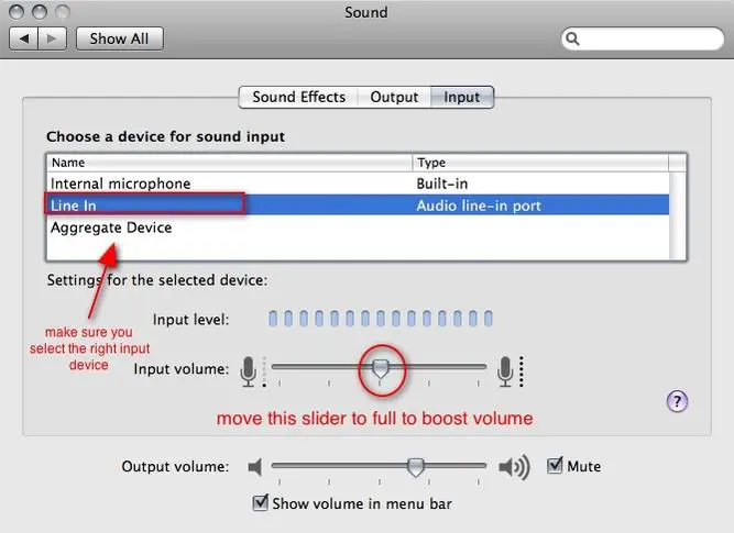

hey, hope your search is going well. if you need to boost your levels, go into system preferences on your mac, then go to sound, and then raise the volume input of the device you are using (whether it be the built in mic, the line in port, or a usb interface)

Ah, Tojo, yeah I've pumped up the volume in my midi settings to no avail - i think my current mic is just not sensitive enough and the interace not powerful enough...thanks though.
wait what do you mean you've pumped up the volume in my midi settings? check the attached image and let me know if you did the same thing.

Tojo, yeah that's the volume level I had 'pumped up'. Cheers for the idea.
