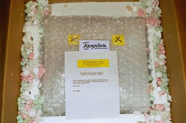

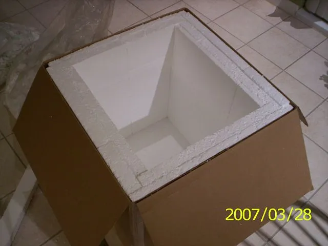

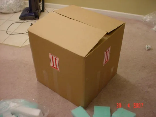

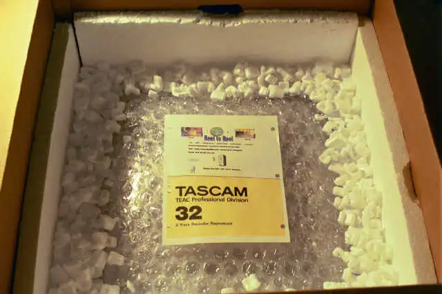

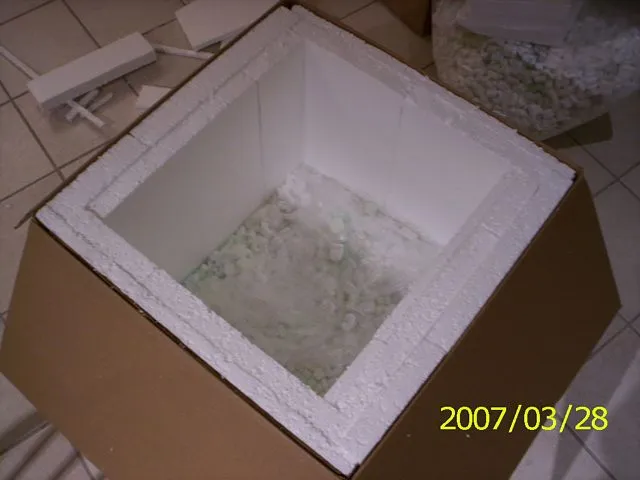

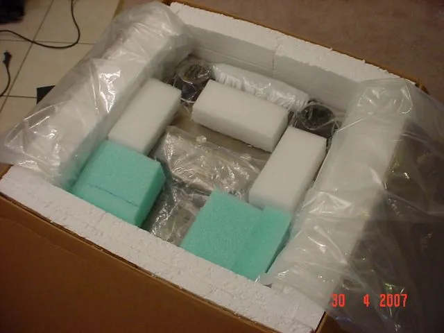

This is just to give you a better idea, visually speaking. This was for a much larger recorder so you'll need to adjust for your Sony, with more panels.
