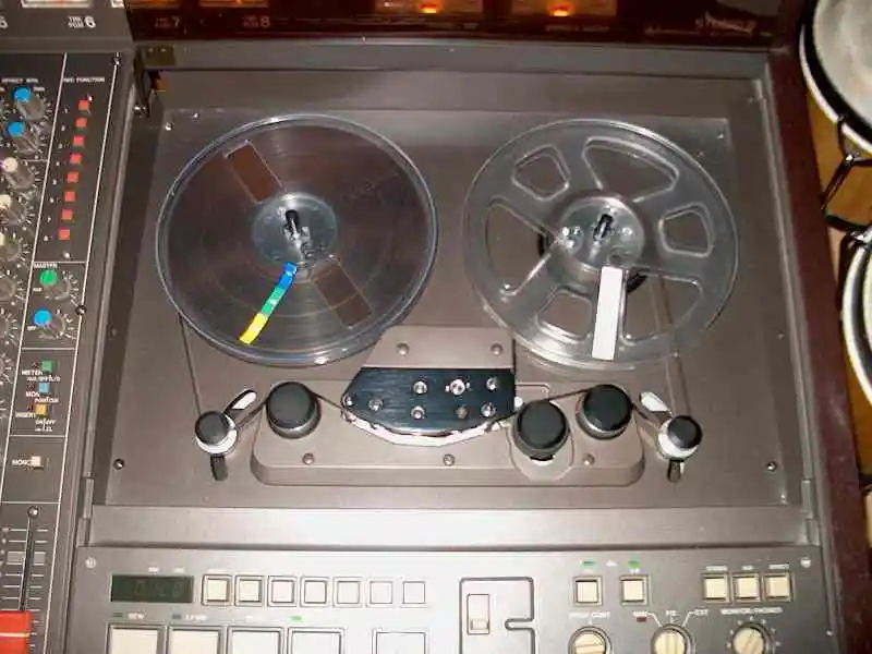

I can't determine the exact gist of your problem, but the Reel/Servo card has tension arm position adjusments which greatly affect the tape handling characteristics.
I'll try not to repeat myself endlessly, but...
With tape distributed evenly on both reels, and when in Play mode,...
the proper tension arm position is when the centers of the tension arm pulleys are intersecting a line that's even with the bottoms of the idler and tach roller, Left and Right respectively.:eek:;)
If the tension arm position is out of whack, the servos and therefore the tensions are incorrect, which directly affect tape motion, be it Play or RW/FF function. The 388 is a servo driven machine, which is why the characteristics change when you manually "force" the tension arm into another position by hand.
You have to be a little careful when adjusting,.. a little at a time, but it's relatively easy and doable for the average DIY'er without a tentelometer./DA

A sticky tape would leave lots of oxide on the heads and tape path. It would be obvious. The tension arm positions can be adjusted, and should look like those in the photo when in use. Any other positions and the tension would be wrong, with the accompanying problems handling tape.:eek:;)
