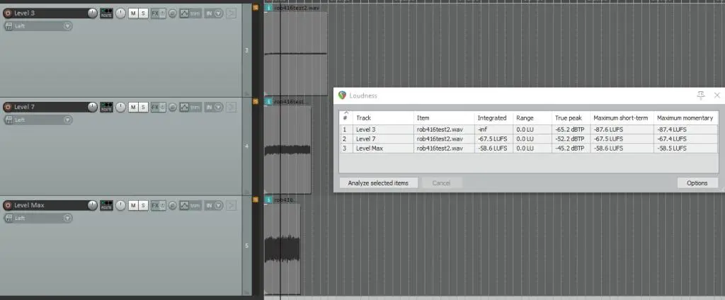

I've listened to Rob's excellent example, and truthfully, the H6 preamps are definitely NOT the problem. At anything approaching normal use, the noise level, even at a setting of 7 is very good. If you were using an SM7B and having to push the preamp to the max just to get an adequate signal, then yeah, the preamp noise would be evident.
I split off each of the noise sections and then analyzed them, no processing or normalization here. This is just the raw data. At the first level, it was almost -90db! Even at level 7, it -67.5dB. That's certainly well below the ambient noise being recorded. 30 years ago, those would easily be professional level noise figures.
You should not be having to push your preamps above 5 when recording. If so, then you are simply not providing enough sound level for the system to record. I would be wary of spending $1000 or more on a microphone to try to overcome poor recording technique. The 416 and Deity spec out almost identically with -32dB sensitivity and 12/13dBA noise ratings. Assuming that the readings are done properly, they should allow for a very good comparison.

Before I spent a dime, I would set my system up, Level at 4, get in position, TAKE OFF THE HEADPHONES, and do a recording as if there were 5 people in front of you. Heck, maybe get 5 people sit down, and see if your levels aren't better.
DON'T TALK TO THE MIC. Talk to the people.
