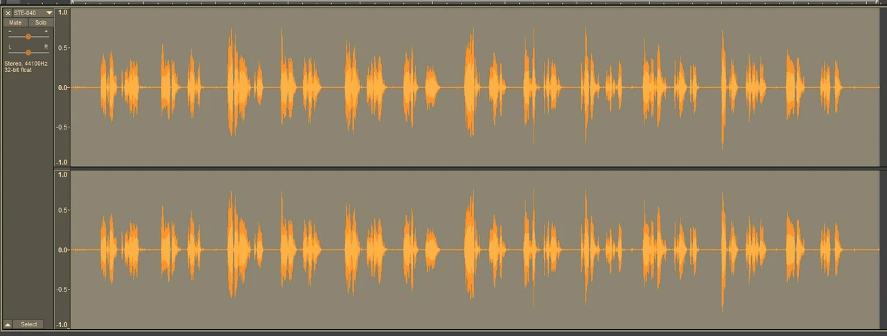

I whipped up this test. NT1 into the H4n, record level at 60% at abouit 8-10 inches away. The primary noise is low frequency stuff from the environment. I spoke about as softly as I could and even then, there is plenty of signal and very low noise. There is no processing of any kind with this recording.
Does this sound acceptable in level?

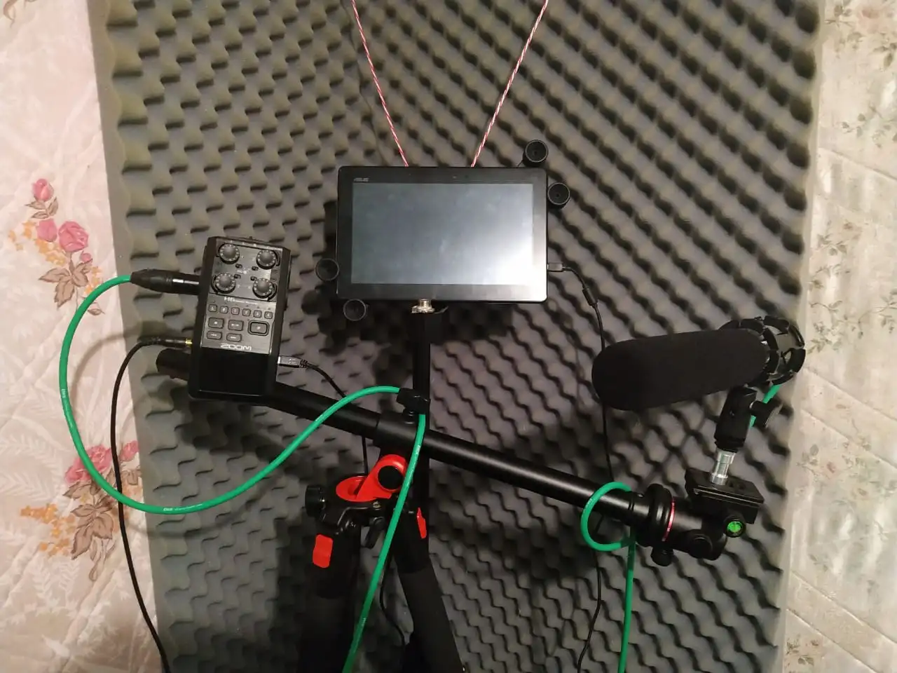

I would be great! No, I do not use it with a camera yet. My set up.
