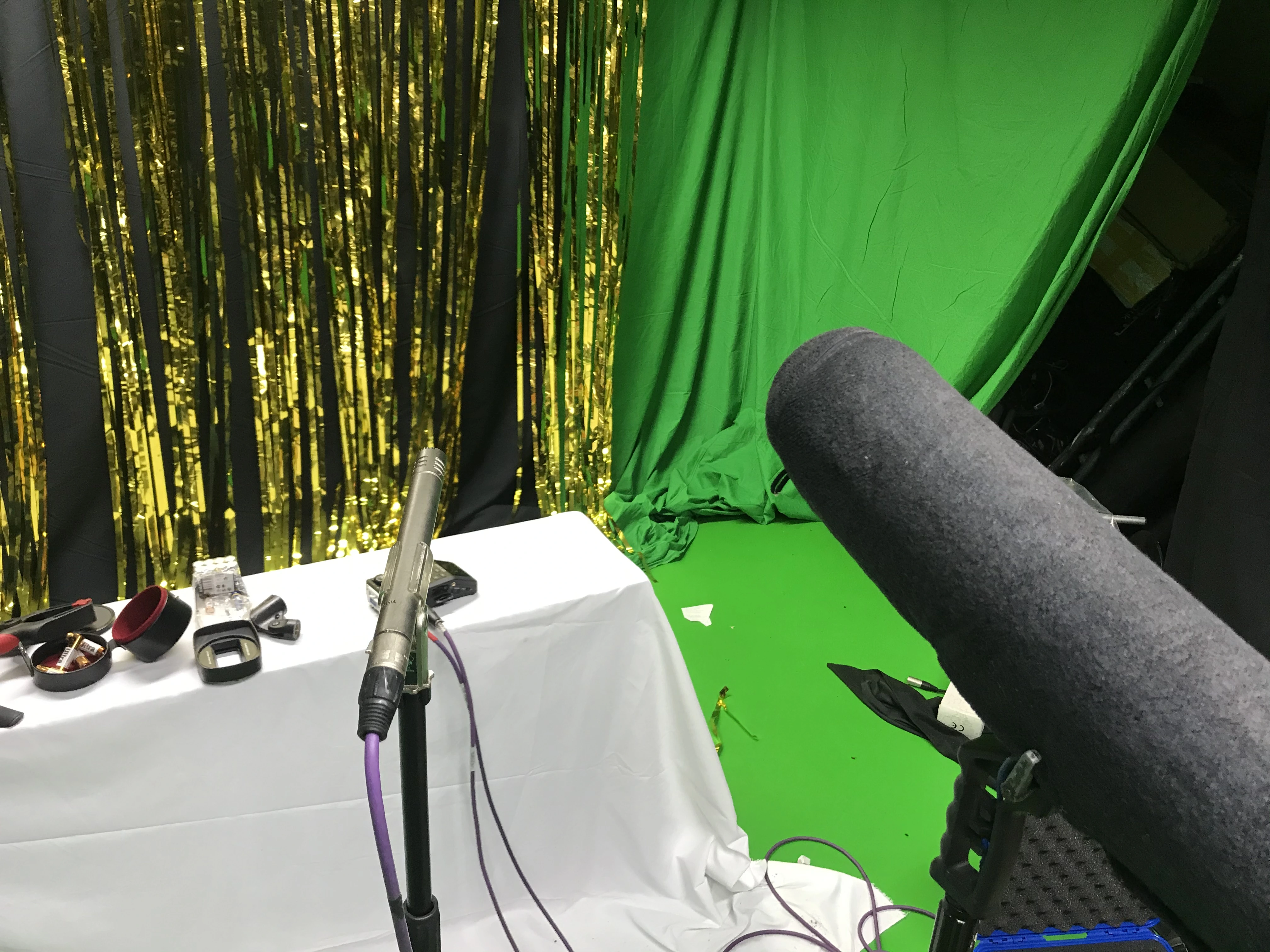

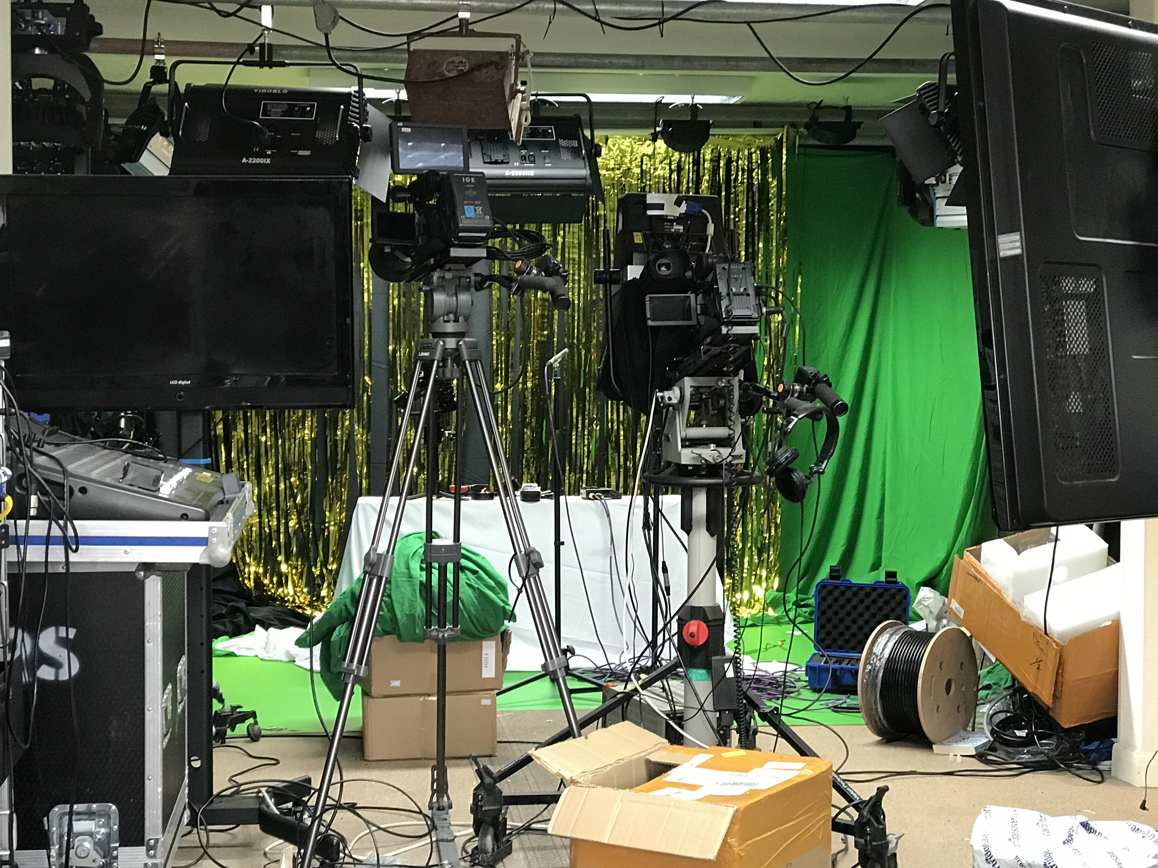

What I did was to plug an AKG451 with cardioid capsule into one channel, and then the 416 into the other - both pointing at my mouth - with the front's of the mics at the same distance - the 416 is inside the Sennheiser basket windshield where it lives - so the real mic front is perhaps 50mm back from the outside.
The voice is captured at various distances. The recording is exactly as captures - NO adjustments at all to the levels - so no normalisation. You can do this yourself if needed. It means some bits are too loud, and the end very quiet - but I figured you have the total dynamic range possible. The AKG451 is just for continuity the 416 with plug in and out reveals how much noise comes from the preamps. The recording location isn't the audio studio, it's the video studio - so there is the occasional footstep and some other noises that I didn't remove - but the radio noises are from behind the mics, so quite a long way away. Excuse the mess - about three different jobs all happening at the same time.

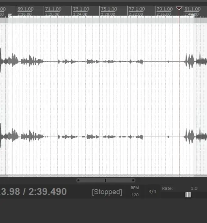

Rob, I listened to your test, but it was identical in both channels. When you pulled the plug on the 416, I was expecting one channel to go dead, but instead, it was still the same on both channels.
Did you forget to pan the signals L=R?
This is where you "pulled the plug":
You know what - that is EXACTLY what I did. Bums - hang on!
the right version!
Thank you, Rob! Now I see that my Zoom H6 is a bit noisier than yours. My meters are around 54-56 without mic, while yours are on almost 57-58. 3 db is perceivable difference, I think.
