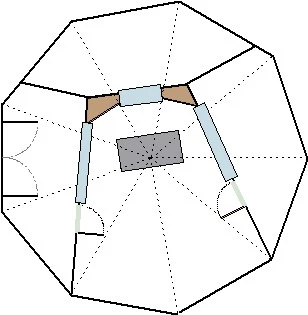

You showed me up!! I can't believe you took the time to make a classy sketch out of my 10 minute kludge. Your layout is what I would've wound up with, most likely, if I had spent more than 10 minutes thinking about it. What drawing package do you use? I only have an old version of Visio that I've mastered drawing simple lines with.
I used Visio Professional 2002, which my employer provided. Its pretty cool, all the walls, doors, et al are drag and drop. I also use it for wiring diagrams, as well as the floorplans for my studio which I posted under the "the mess" thread.
Anyway, I think this is fun and wish I had the time to do it more often. Maybe I'd actually learn what I'm doing.

This friend of mine had a 9 sided building. The room at the top of the following drawing was his tiny control room and the rest was a big open studio. I redesigned it by adding two walls thus:
cheers
john
