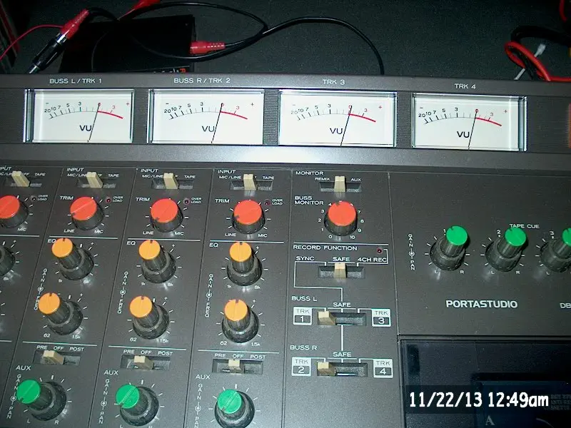

Only by necessity. My personal use has gone down dramatically & in the turnaround I've been calibrating recorders as I've been selling them off. I feel better and more ethical doing that & I know the unit is going to the new owner in peak condition and trouble free. Occasionally I'll do a calibration for myself & keep something, but it's a fluid situation and TBD.
More detailed questions:
Do you calibrate your tape machines at the intervals called for by the manufacturer?
No.
Do you have your test equipment calibrated, scopes, meters etc?
No. The recorders begin markedly off-cal, and when done dramatically on-cal, and realistically it's not rocket science. IOW, the proof is in the pudding & close enough not to sweat the small stuff.
Have you calibrated your control room, mainly monitors using a spectrum analyzer?
Yes. You're one of the few people on this board to have shown any recognition of how important this is.
Just curious mainly.
Thanks!
YW!
(See: off-tape response after calibration)
