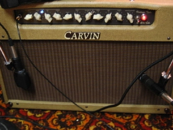

In this case, for the SM57 I was using a DMP3. The situation is that the speaker and room sound great. I'm just having difficulty capturing what I hear. The SM57 seems to be picking up the mids and highs quite nicely. With this new speaker cabinet, the bass is much more full which the SM57's aren't doing well.
I've been experimenting a little with mics and placement. I'm getting better results by changing it up a little. I've left one of the SM57/dmp3 on the grill to the side sligtly off center getting more cone. I also placed another SM57/dmp3 out about 3' pointed straight at the cab...then, yet another (AKG414/Avalon M5) about 8' away where the bass really comes out and sounds best to my ear. This combo is a big improvement but I'm still not getting the full sound.
I've been blending the sounds to try to get the sweet spot but the more I play with this set up, the less I like the SM57's. They just generally sound too bright to me which seems to get worse the closer the mic gets to the cabinet.
Obviously I've got some experimenting to do. I'm definitely going to change up the mic combo a bit and stepping away from the cab seems to be big help too. The work I've been doing lately has been less rock/metal sounds but more jazz/blues stuff so I'm getting away from the hard/bright lead sound...just a bit of a departure from what I've been used to working on.
Thanks everyone.
Have you tried moving your closest sm57 all the way to the edge of the speker pointed just slightly towards the center?
