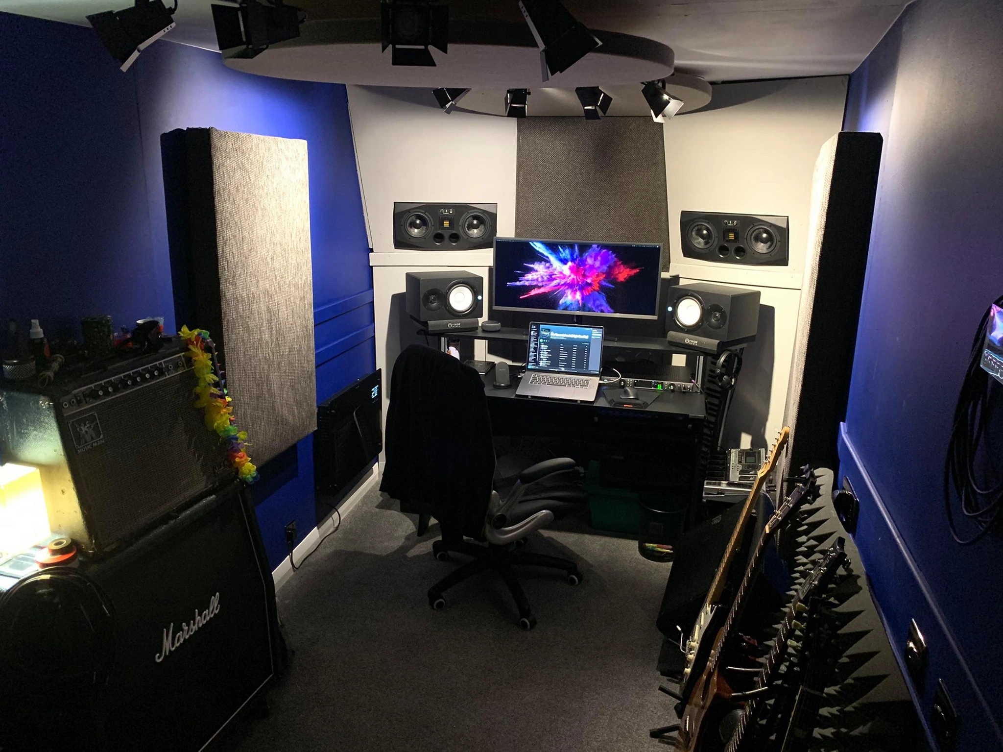

The Adams my friend has were also able to be soffit mounted - and the speaker response can be switched to allow this - This was the studio I built for him - those speakers are really nice.
Very pretty! Great job, :)
Very compact - but that was the space he had. The speakers were probably the most difficult part once he'd settled on them. I sat him on the chair and used string to go from his head position to the speaker positions. Then had to project left/right and up/down at 90 degrees from the string and build the frameworks the speakers aim accurately. sorting the timber and then making the panels fit was really hard - in the end, I abandoned the maths, and did it with cardboard so it fitted properly. `None of the walls have 90 degree angles and this was a killer with the calculator.
