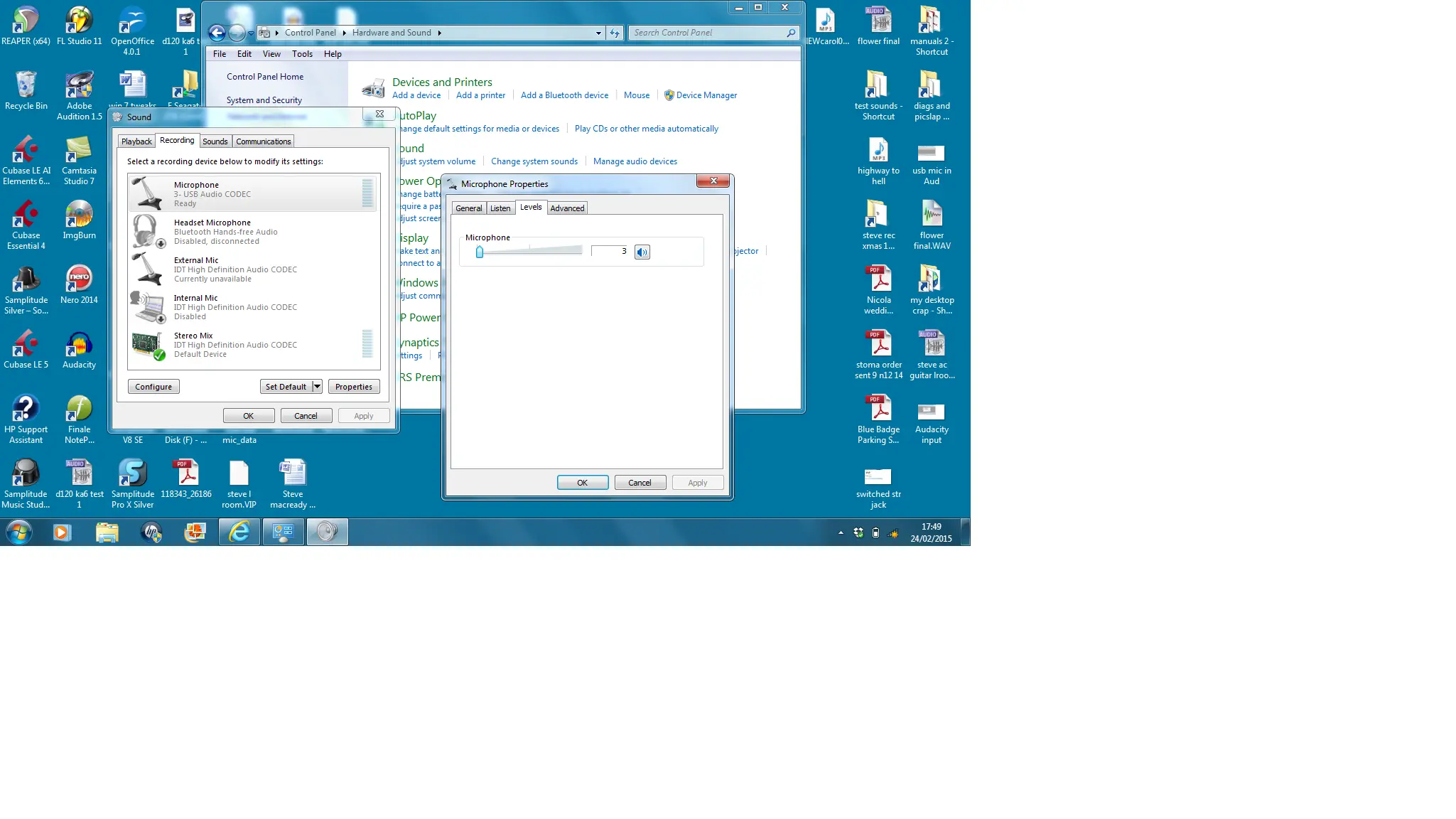

Work your way through the menus in the screenshot.
Note the USB device (a UCA 202 was handy) shows as a microphone(!) and that the level is way down at 3%. Yours is probably even lower but usually it is set at 100% by default and this makes for very noisy recordings.
This is W7 of course, no idea which tomfoolery obtains with 8. XP of course just works.

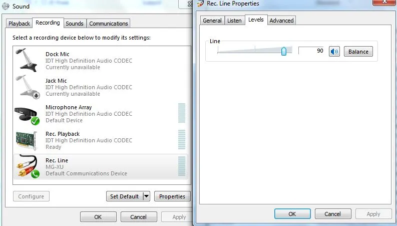

Really appreciate your reply, the level is max in my Windows 7 recording device settings. Gain is almost maxed. Channel level and main/output level is max.

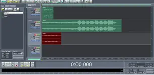

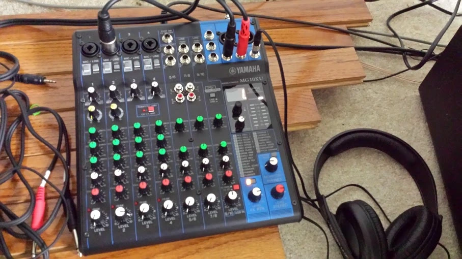

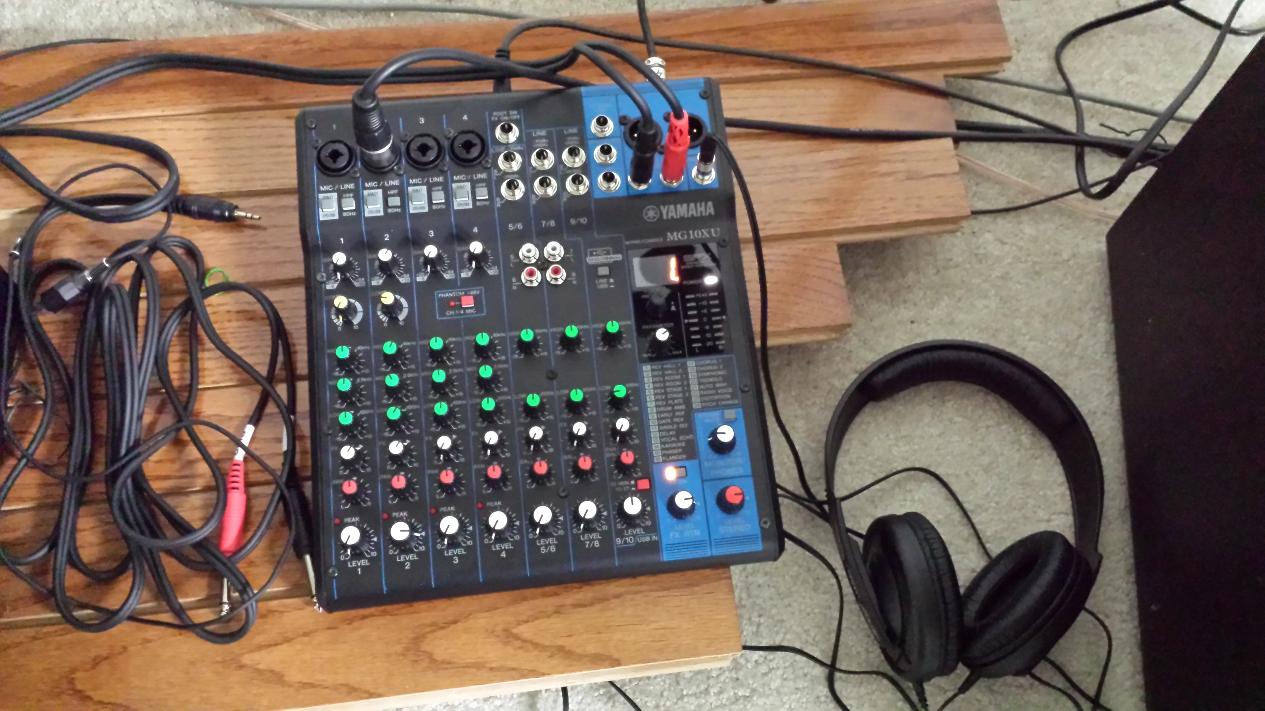

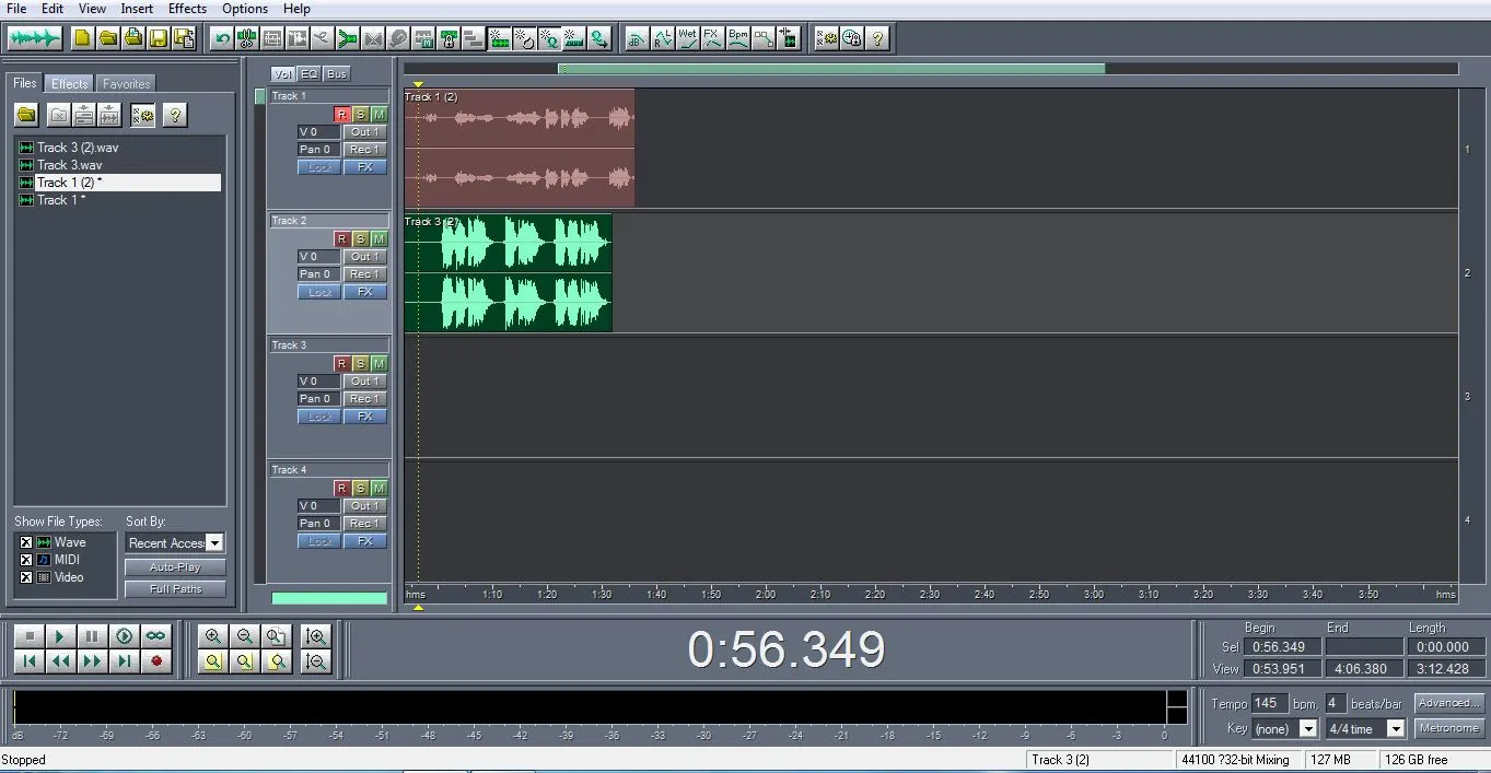

Thanks everyone's help. I attached mixer settings and computer/DAW screenshot here. Did anyone see any clue ;)?
I missed a call from Yamaha support, the support guy left me a message say I should turn up the stereo volume... but actually that won't affect USB output at all.
Track 1 is the track recorded from USB. Track 2 is the one I imported from other source with normal level.
Your track waveforms look fine. The imported ones look like they have been boosted/limited-compressed up closer to 0dB.

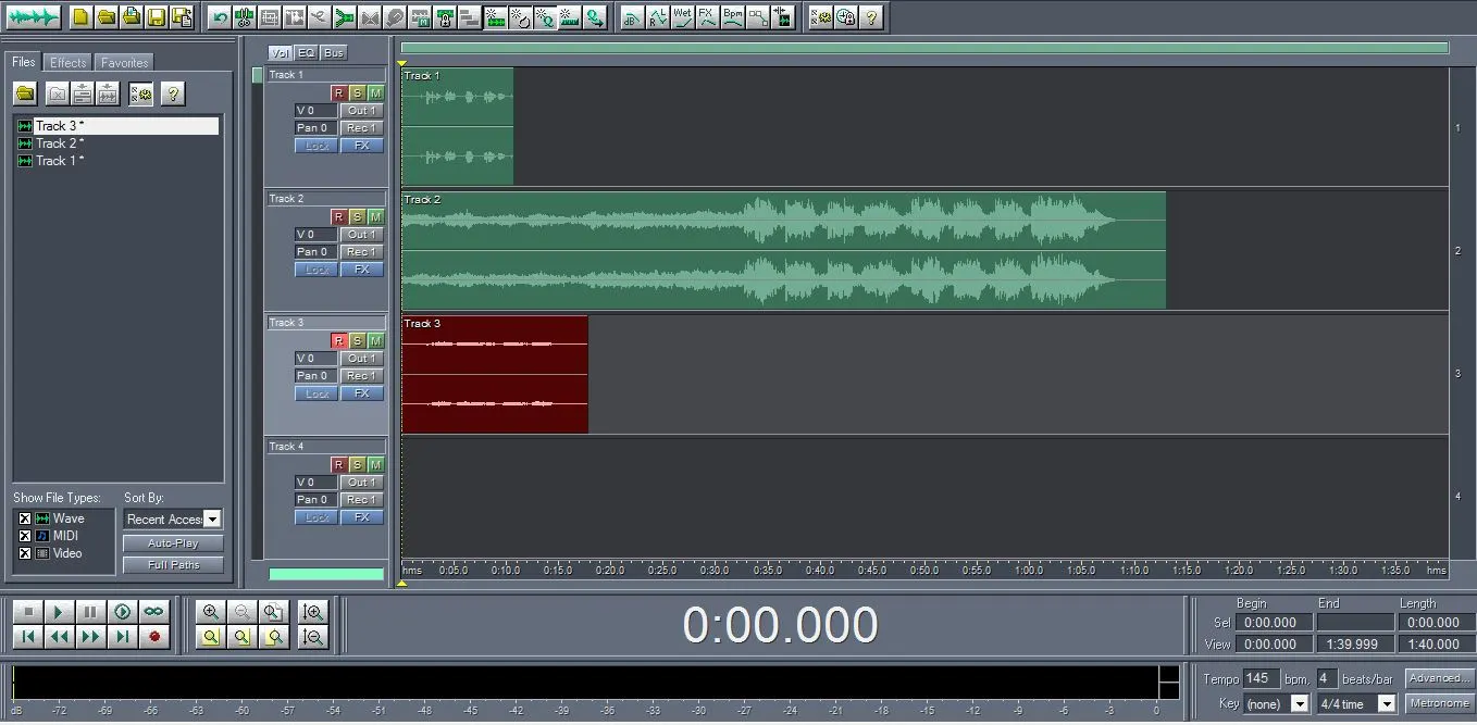

Thank you, I just realized that one is recorded use the laptop built-in mic. The track3 in the picture below is the one recorded use mixer. Yamaha support told me it could be a defect and I am going to replace it.
