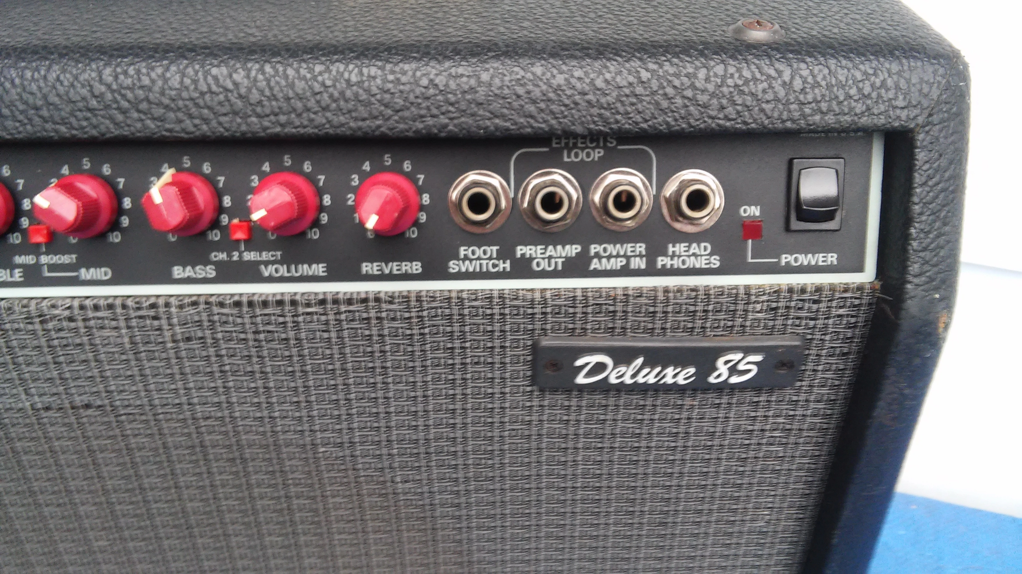

I don't want to hijack my own thread but I have a fender deluxe 85 with a pre amp out is that the way to go or is headphone out better for my 2i2?View attachment 103320
Can't find a schematic for the DL85 and the manual doesn't help (guitarists cannot understand voltages it seems!) but I would guess a Pre amp out would be around 0dBu, 0.775V to one volt and probably go a bit higher, should be fine for a F'rite line input.
Headphone outs tend to be lower than true line outs voltage wise but of course have a higher current capability. They are also "stereo" and that can be a problem with a balanced input.

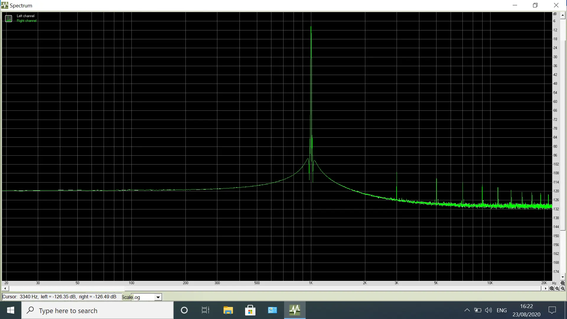

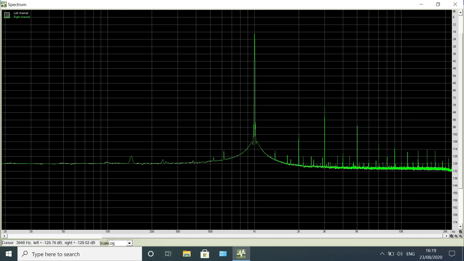

See, having banged my drum saying an XLR DI out on an amp should be balanced and at mic level (shall we say -40dBV 10mV?) and really should be transformer isolated I thought I should put my money where my mouth is? A whole tenner! That tenner amazingly bought me TEN 1:1 transformers, wee things, 14x10x5mm pri and sec resistance around 140 Ohms (will do pikkies later)
I generated 1kHz at neg 6 in Samplitude (see wavgen) and you can see the harmonics are almost 100dB down for the third and falling and no second harmonics.
That signal was passed through a ZED10 mixer from the laptop and some 0.5V fed to a traff primary. The traff output was loaded with 6k8 being a little less kind than the normal 10k.
Sec' out was recorded via NI KA6 into a desktop and you can see the resultant spectrum
'Oribble innit! Well not really. Third is the highest harmonic and that is 60dB down on 1Khz. For such a cheap transformer I reckon that is not at all bad? Yes, distortion at 100Hz is going to be worse (my next test) but consider, if use to deliver a MIC level output the signal level will be a good 30dB below half a volts and thus distortion proportionately less. ANYWAY! Bit o second harmonic adds 'warmf!"
I hope to be able to do more tests. Distortion at lower frequencies at 'mic' levels and, if I find the time and energy some for of distortion device driven frm an amp dummy load.
If anyone this side of The Pond wants one to play with I can donate four* say. Just PM an address. No charge.
*I meant one EACH! (top pic is output)
