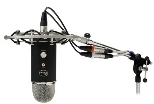

  • On the Rode Studio Arm it has a kind of 'nest' so that you can orientate the mic in all sorts of diffrent directions, can I attach something to a mic stand to do similar?

Generally, you can aim the mic using a combination of rotation the boom arm in the clamp, using the tilt function in the mount and rotating the mic in the adaptor. It's hard to describe in words but you should be okay with a bit of playing.

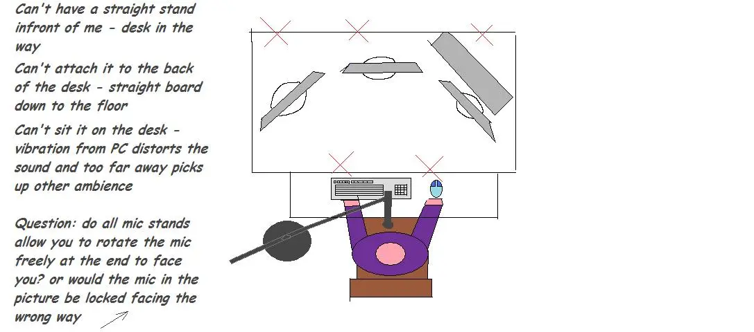

Actually before I started the topic I was kinda doing a terrible MS paint drawing of explaining my desk situation, but I thought it made it look like I was 12 (I'm no artist)

That seems like the best arrangement. Defo decouple the mic stand from the desk.

You'll be able to rotate the mic in the shock mount, change the angle between the mount and the boom arm and rotate the boom arm in it's holder. It can be a bit of a fiddle until you get used to how they all play together but, yes, you have full control.
Regarding your diagram, I might be tempted to put the stand base closer to the desk so the boom is angled so it comes towards you rather than over your shoulder--if you see what I mean. Keep it slightly high and angled downwards--that, with the mic upside down like in the photo can keep the mic mainly out of your eyeline and also force you to keep you head upright which will help you sound nicely resonant.

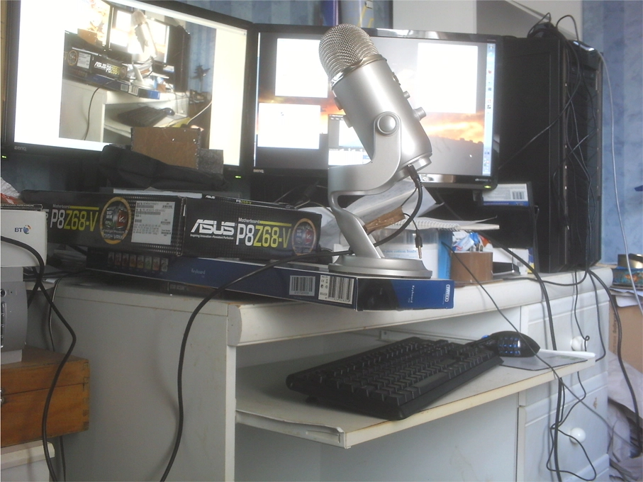

Sounds good, actually found an old picture I had of my bootleg/broken Yeti where I tried to use it without a mic stand, this thing was just asking to be knocked off by accident, and it sounded terrible anyway so I made use of the 7-day return policy before it became a awkward post 7-day return
