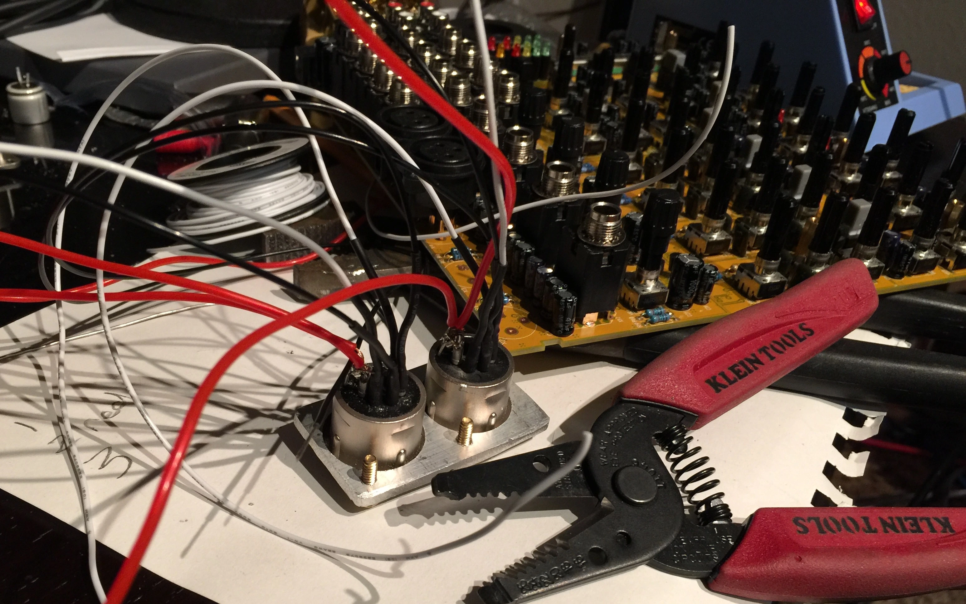

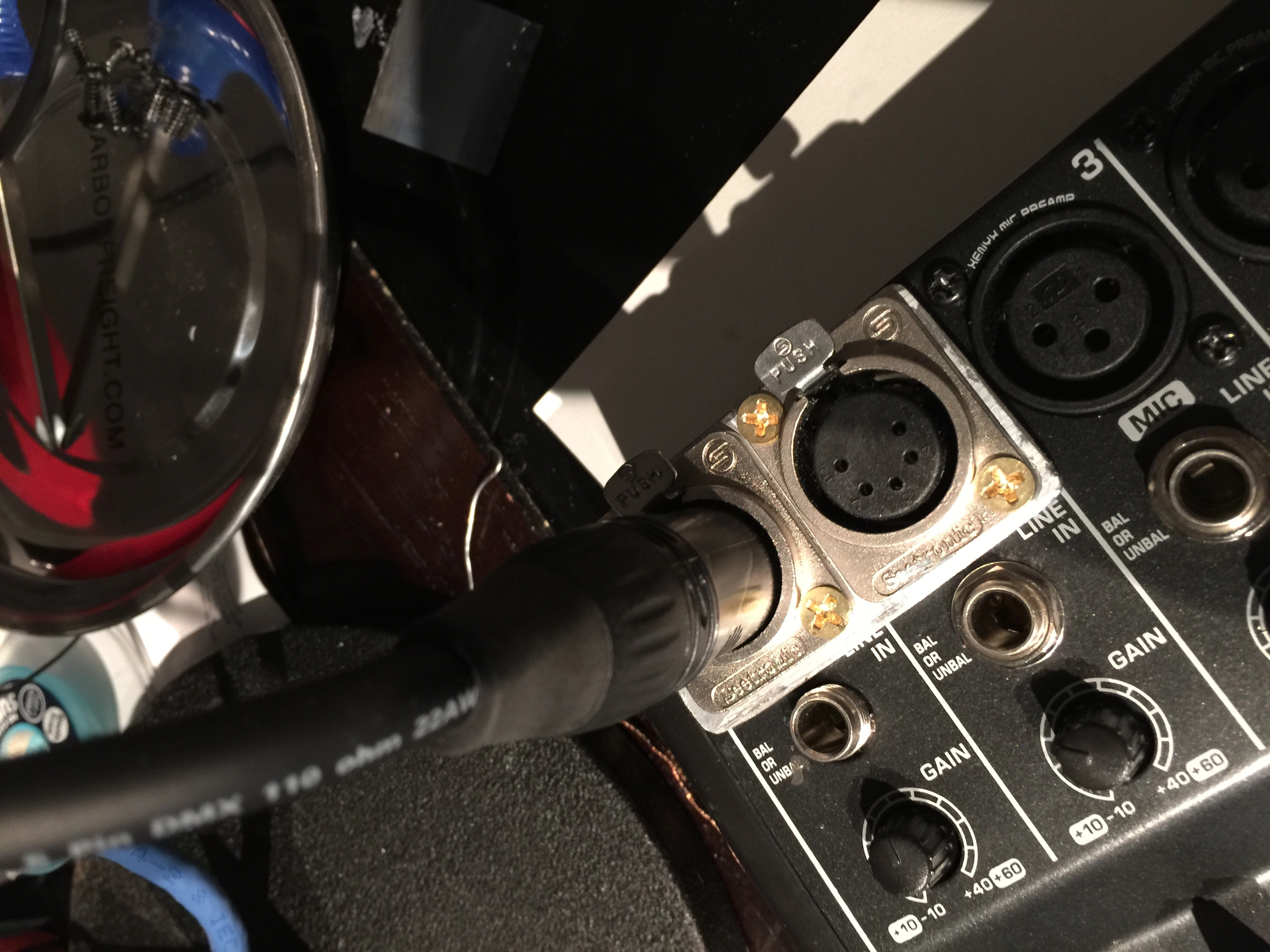

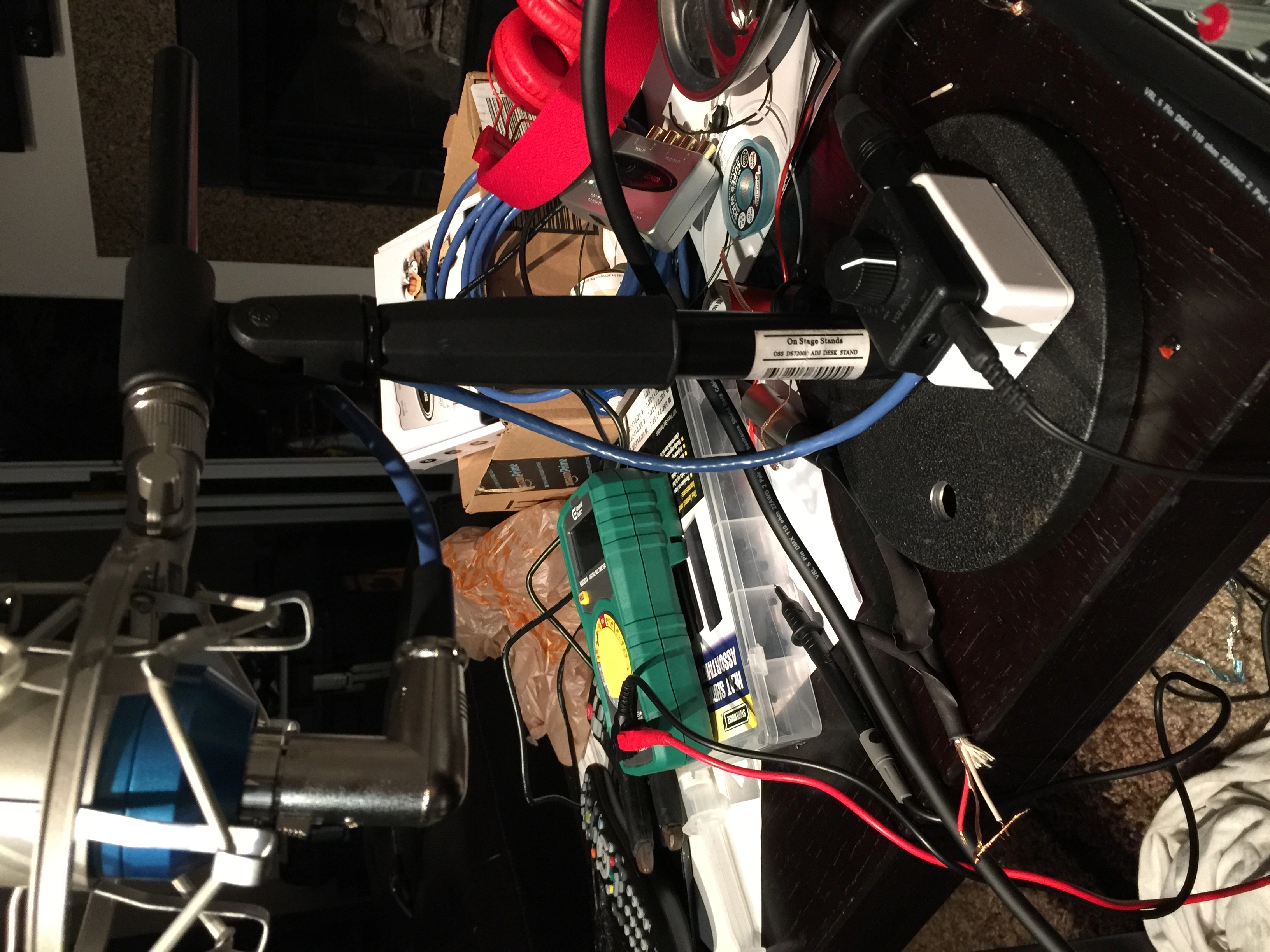

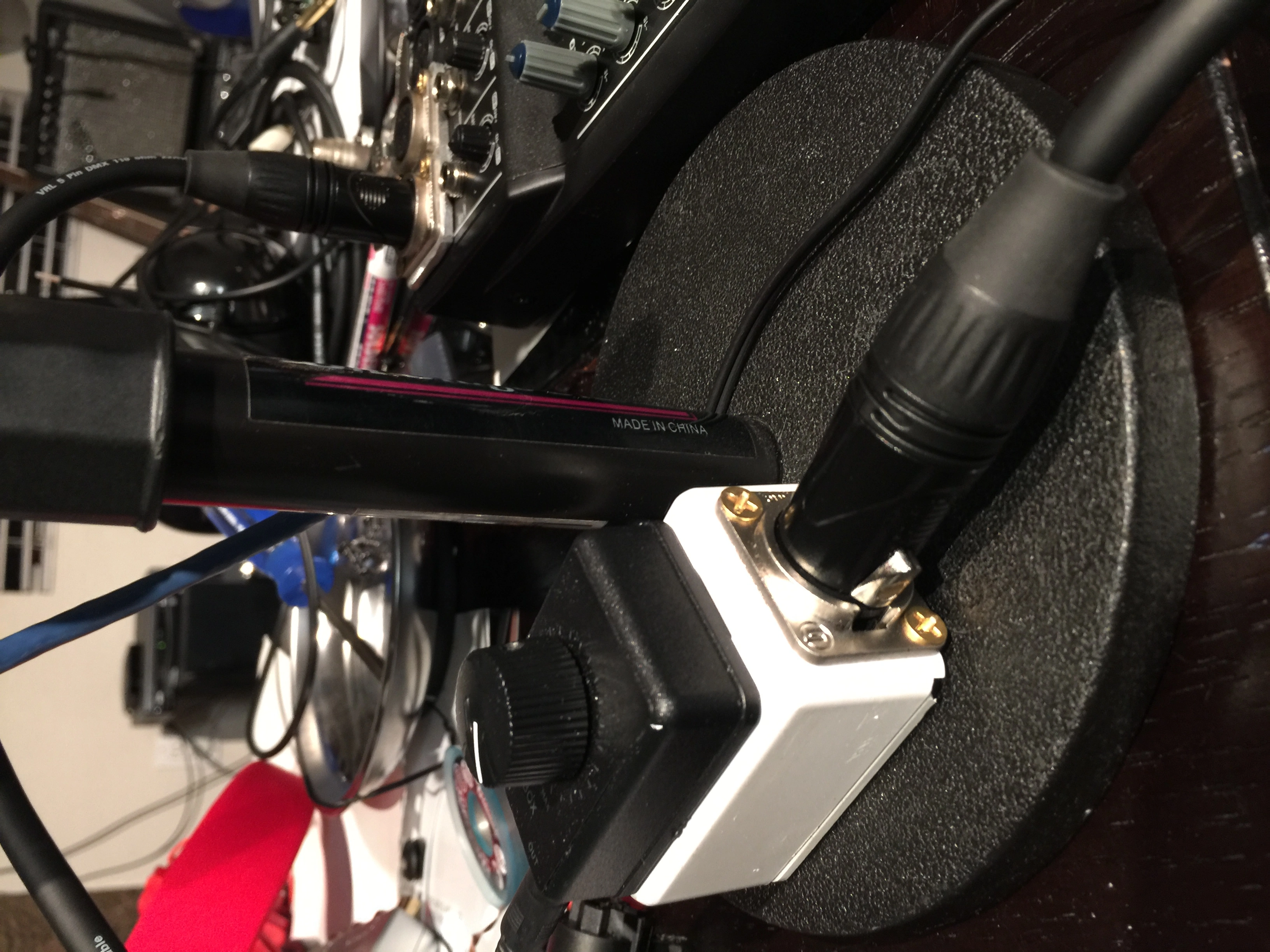

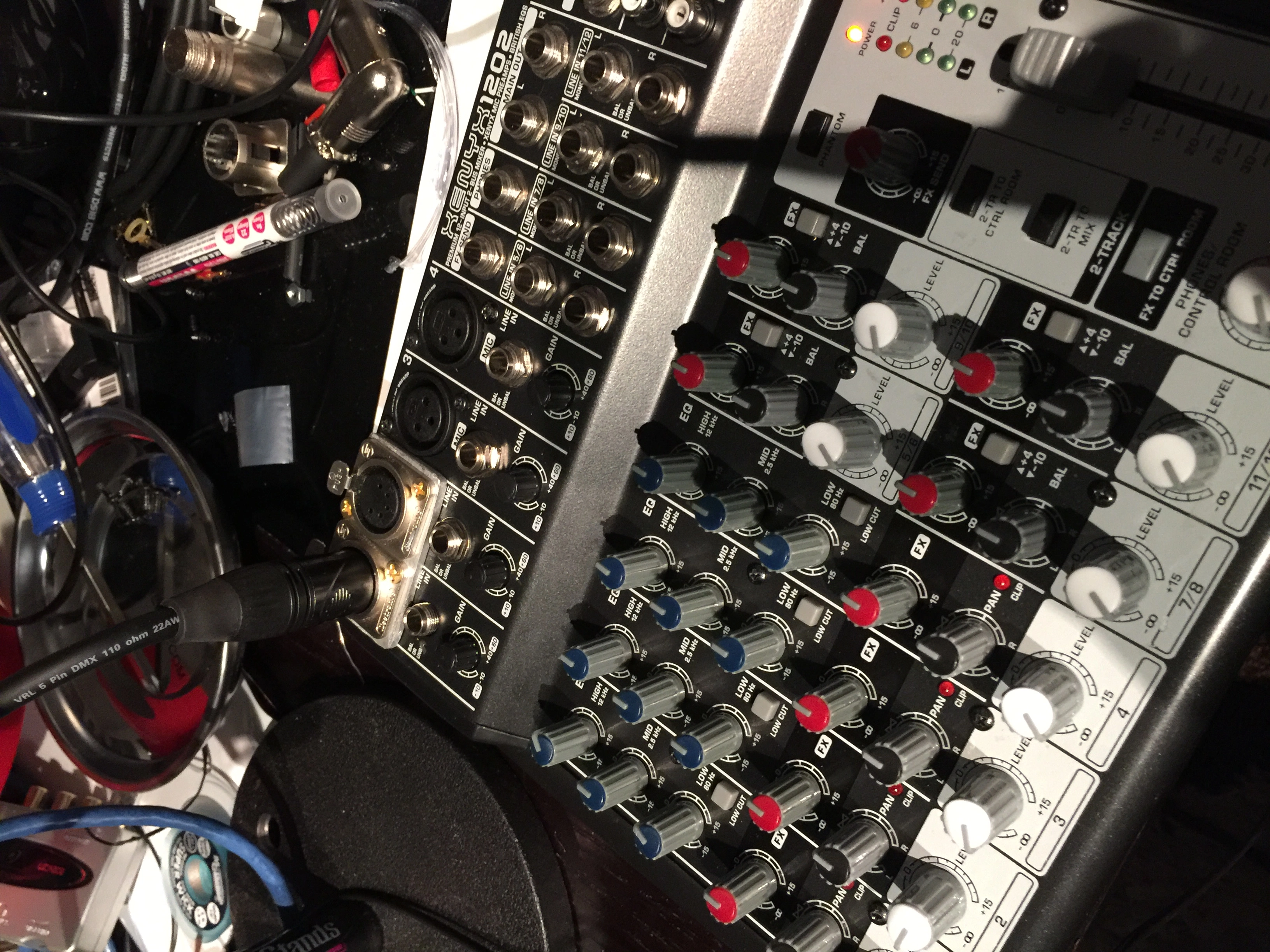

I ended up going with 5 pin xlr cables. I made a little breakout box on my desk mic stands with a volume control box and headphone plug attached, and tore apart my little Xenyx mixing board to replace 2 of the standard 3 pin xlr's with 5 pin ones. I also internally wired in the headphone port to the new 5 pins. I ended up sharing the drain/return wire between the mic and headphones and so far it sounds fine. No static or weirdness. Teaching myself how to solder and buying the solder equipment was laborious and expensive. All the components were an arm and a leg. Once again my DIY hobby has spiraled out of control and cost 10 times as much and taken 10 times as long as I thought, but I don't really see any other options out there for something like this.
