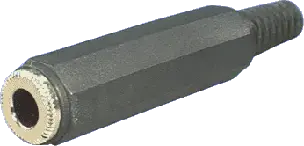

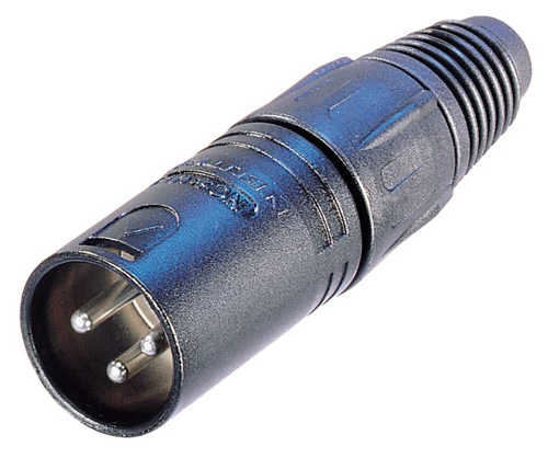

Hi, sorry about the late reply but it was a holiday long weekend here.
For each mic you need:
1 off male 3 pin XLR
1 off Female 6.5mm in line Jack socket.
About 300 mm Microphone cable.
And be able to solder.
XLR end: solder pin 2 positive (Red), Pin 3 negative (black), Pin 1 Shield.
Jack Socket end: solder Red to tip, black and shield to ring.
There is a diagram here at the link below, but it shows a male jack plug, you need a female jack plug.
http://www.mediacollege.com/audio/connection/xlr-jack-mono.html
Cheers
Alan
